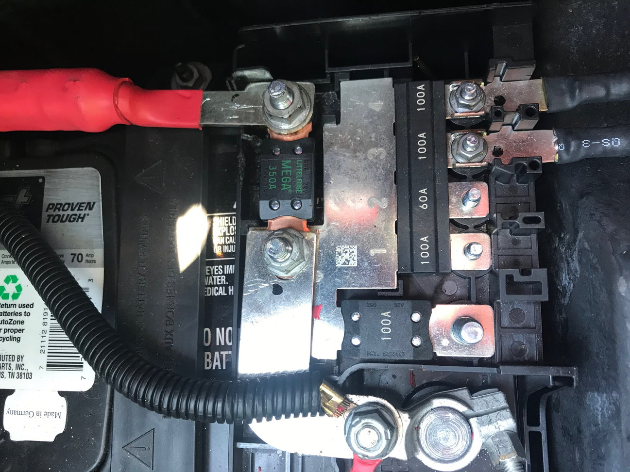

Here's the fuse....not sure if you can get it via Amazon but at least this give you a picture of it:
Amazon Amazon
Location is above the battery:
- Disconnect the negative battery cable
- Remove/Replace the fuse
- Reconnect the negative battery cable

If you have a voltmeter (VOM), measure voltage here (red arrow) with the negative lead on ground. If you read 12 volts, the fuse is good. If you don’t read 12 volts, move the lead to the green arrow. If you now read 12 volts, the fuse is bad and needs to be replaced. If you don’t read 12 volts, the battery is bad or not hooked up correctly.
