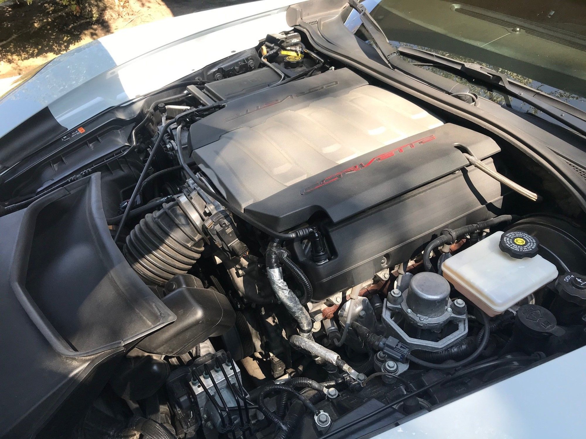

Thanks....here's the before as a reference....
Note: My cleaner of choice was Simple Green diluted 1:1. Sprayed heavy, let it sit for 10 minutes. Used a soft brush for gentle cleaning then rinsed with my pressure washer. I used my leaf blower to blow off most of the water then fired her up and took her for a drive to dry off the remaining water before I applied the Meguiar's Hyper Dressing.
Good luck Guys!

The before and after photos look great! What a difference there is with a light cleaning of Simple Green, a water rinse and the Meguiar's Hyper Dressing. Well done.

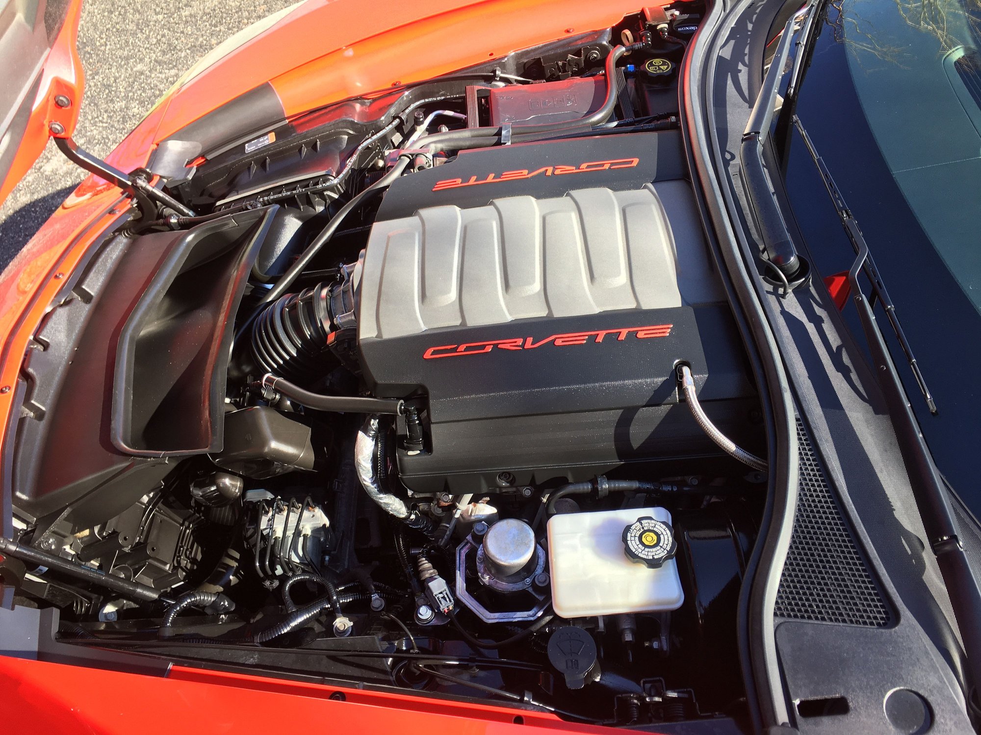

Since I started this thread off by asking about the product, and then buying it to try, it seems like a follow-up is in order. Here are two 'after' pics (sorry - no 'before' for comparison). I think I applied it too heavily, plus I used it straight out of the bottle with no dilution (which I think I should have done). I had to wipe/blot some of the excess. It's a nice look; I'm pleased with it. It gave a really nice look to the black plastic air intake pieces.

Just a tad heavy which gives a lot of gloss, but overall it looks real nice! Good job!
