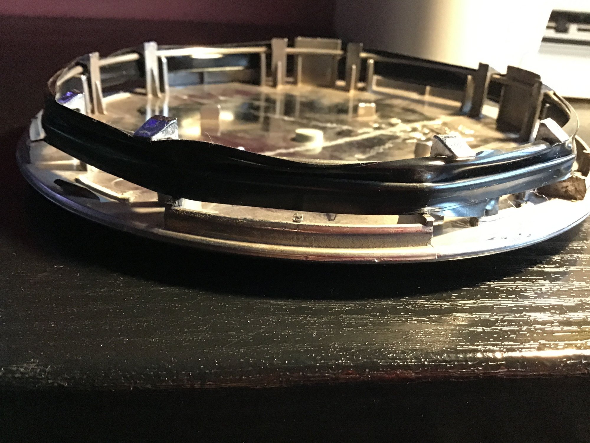

Originally Posted by Catfish4818
Just guessing here - wrap electrical tape around the outer circumference of the mounting tabs, effectively increasing the diameter to give it more grip?
You beat me to it. I have been using this method for years on my 2000 Deville center caps. Works like a dream and I can pop off the center caps any time I want to get to the lugs.
Originally Posted by tknospdr
I considered that, but I'm worried that it could work loose or just not hold well at higher speeds and then I'll be grumpy cause I lost a cap.
If folks have done it and it's holding well for them I'd be game to give it a try, but so far the only advise I've gotten was, "Try 2 drops of latex caulk and let it sit over night. Easy to remove. I tried tape and lost 2 OEM center caps."
Just looking for a few more opinions on different options before I pull the trigger.
Don't worry about it. After you put the tape around them they will be really snug and won't budge. I have drove my Deville all over especially at highway speeds for years and never came close to one falling off. Here is one of my center caps using the application, works like a charm.

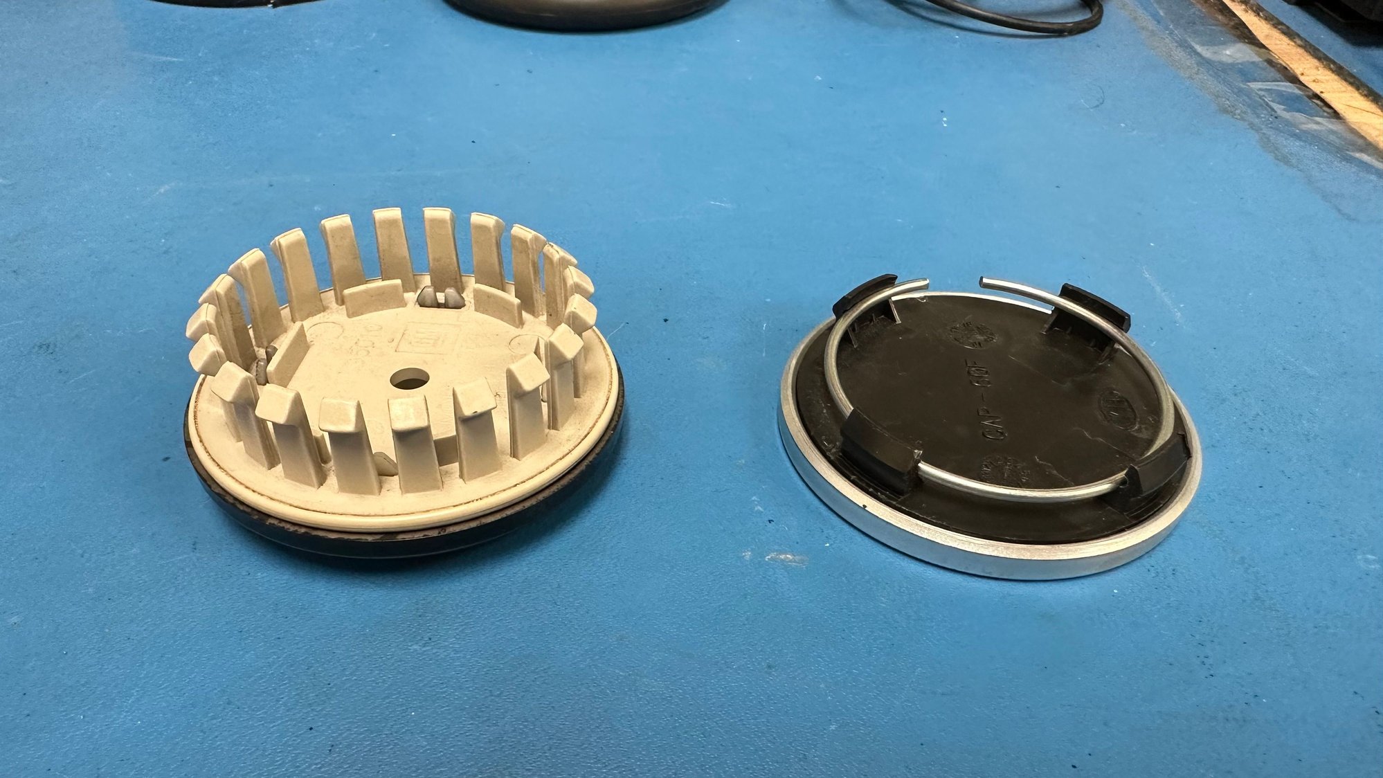

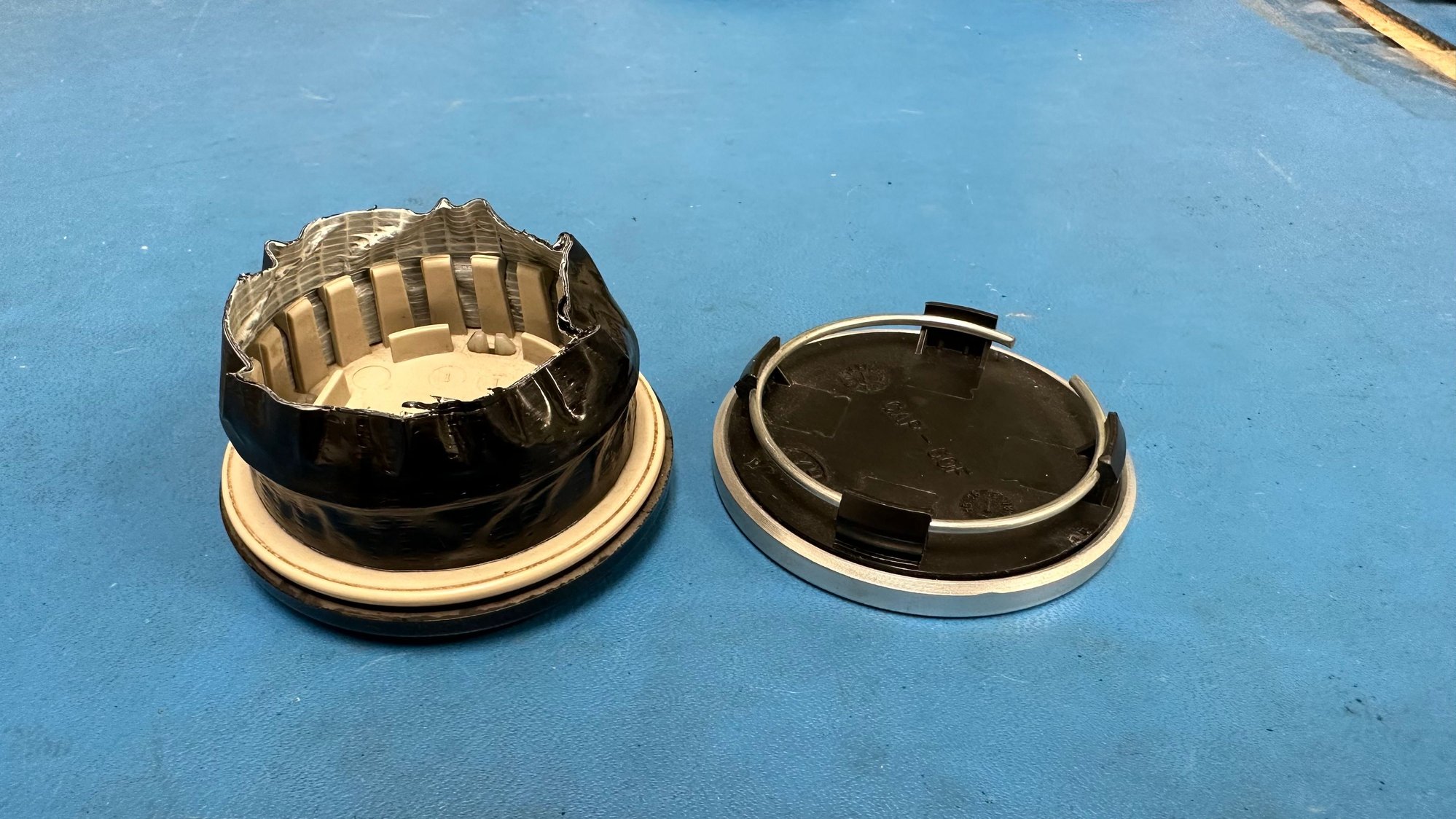

Tried 3 layers of duct tape, it was still too loose. There's a pretty large difference between the way the OEM caps attach and how these attach.
OEM on the left in photos.

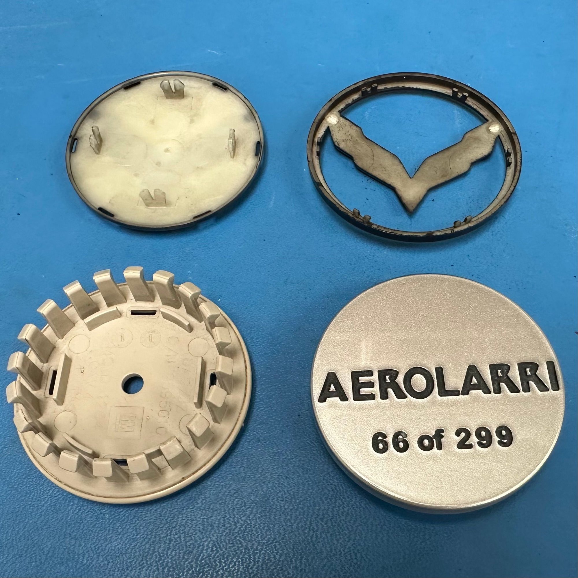

Looks like the OEMs come apart. Maybe I can build something that will fit correctly.
Old Mar 11, 2023 | 12:54 AM
Avanti's Avatar
Avanti
Posts: 19,964
Likes: 6,768
From: Bonneville Salt Flats
Yes, the OEM caps (and some others) disassemble, as you see. I've done so a number of times to assemble my own caps to suit me, most often with my online "name."
