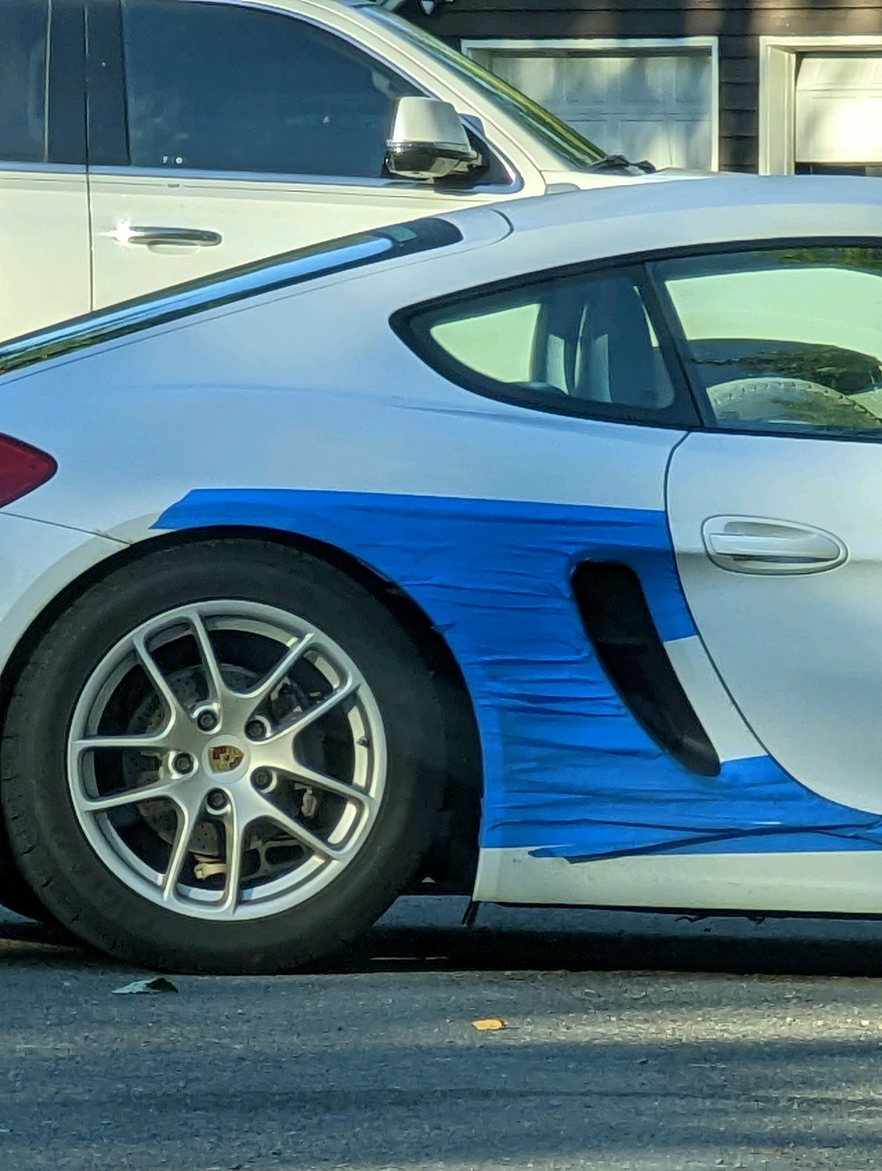

But there is an alternative you haven't considered. We came across this Porsche last fall in Glacier. Overheard him talking to a person who asked him about it; 'we cover it with painters tape every time we go more than a few hundred miles'. And I thought a bra hid the nice lines of a car.........
