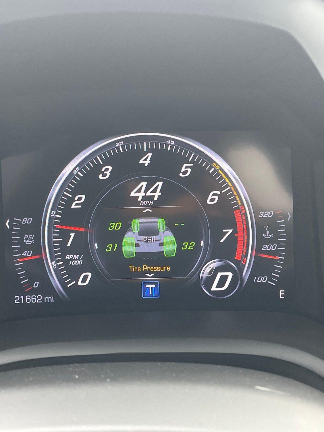

I picked up a ‘16 Z51 and I have Passenger Front TPMS not being seen. I tried the aforementioned fix three times but no good. Any ideas? Thank you.

The dashes means the car isn't receiving pressure info from the sensor, logical.
The sensor battery may be dead, possible with 7 years/23k miles.
You can go to Discount Tires and they usually have a machine that will tell the condition of the sensor. A dealer can probably do the same but will charge more.
Downside of DT is that sometimes they install aftermarket sensors that can have problems. The real ones are made by Schraeder.
Let us know what you find!

Joyce's Vette, you can swap the 2 front tires/wheels, side to side. That will insure the problem is only related to the wheel TPMS, not the pickup sensor.
Sullivan tire was able to read and check my 2017 TPMS transmitters.
Good luck, keep us updated.
Ron

if it's dropping out like that it's the sensor
I had a nightmare sensor problem when I got a 2nd set of wheels, reset them about 20 times before finally giving up and replacing the 2 sketchy ones
It's been years now and I've never had the problem again.
I also bought the handheld tool for setting them as mentioned in the post above
It really sucks because in this car the sensor dropping out makes the cars stability control go into a limp mode and it shutters around every turn when you aren't even pushing the car.

It was the sensor, replaced it today with the help of my friends at Viti Automotive. Tucked it in behind the pressed down tire, (did not have to dismount from rim), re-inflated, re-install, reprogram and done. Thank you Tony, Jay, Joe and the rest who helped. It’s not everyday there’s a Vette in one of the best Benz dealers in the region.
