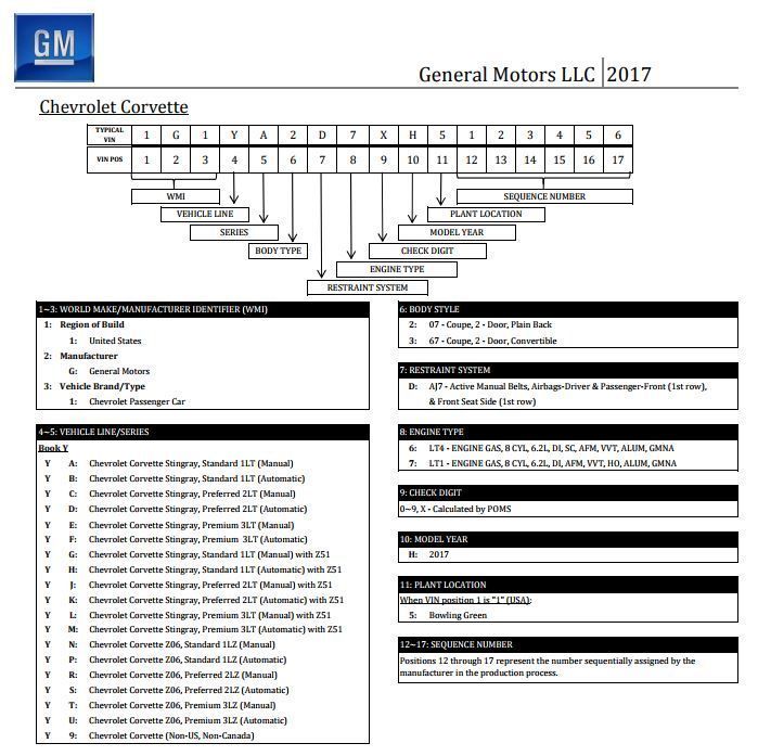

Old Mar 19, 2023 | 09:17 PM
Avanti's Avatar
Avanti
Posts: 20,003
Likes: 6,806
From: Bonneville Salt Flats
And, this... (for a '17, but you get the idea)
