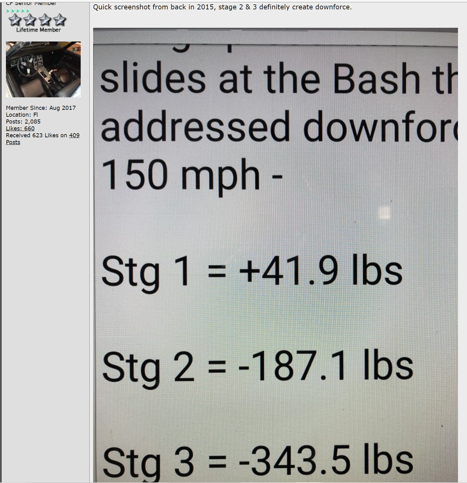

Keep them on the car. They are functional and designed to be used in conjunction with the front splitter and rear spoiler while on the track. In addition, they will provide some protection for the rear quarter panels but there will still be some stones/grit that will hit the sides as some of it passes over the side skirt Vs under it. If you don't already have Expel or a similar film protecting the sides of the car use some track wrap or collision wrap to protect the sides.
If you have a Stage 3 car make sure you have the tall end caps installed on the front splitter and the rear center wicker installed on the spoiler.
From the 2015 Bash these are the official downforce numbers for the various Aero Packages:
Also if you have Stage 2/3 make sure the front undertray is in place under the splitter.
