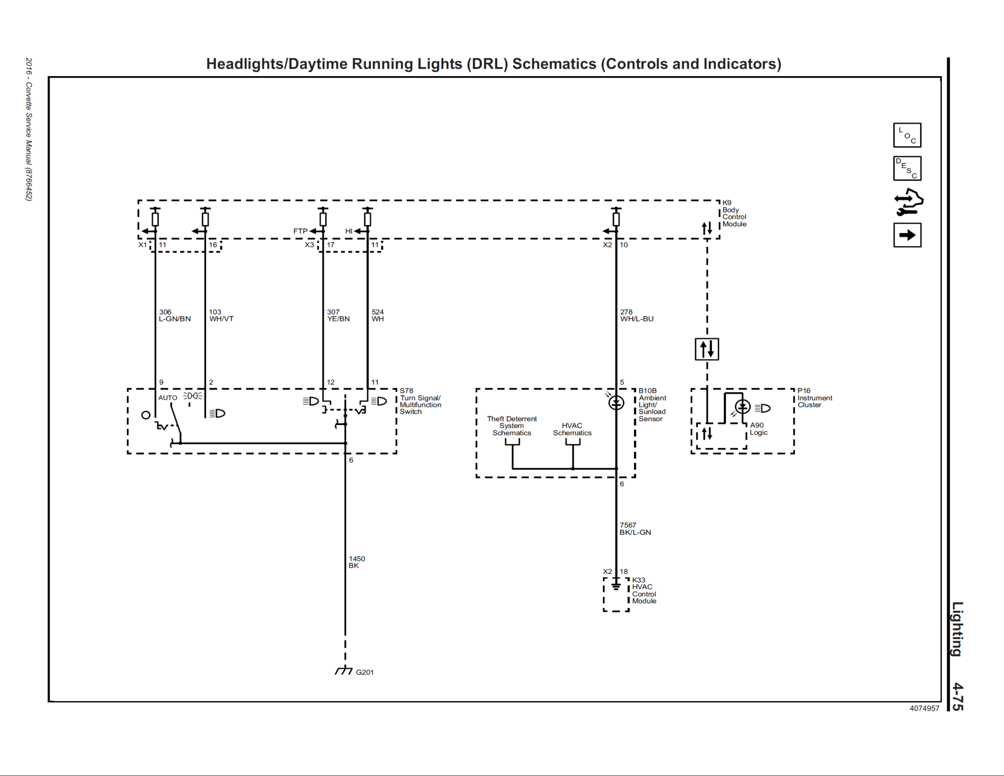

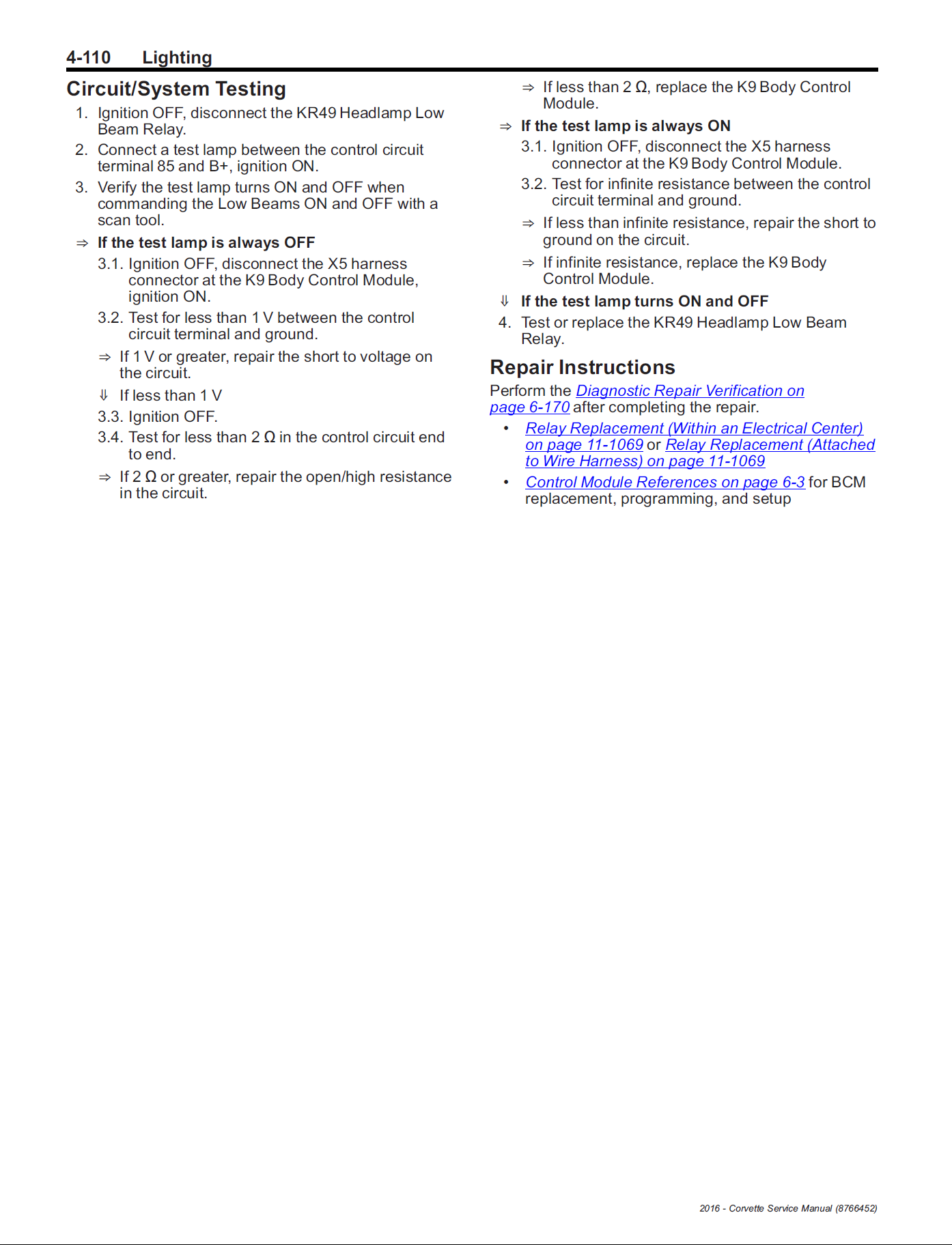

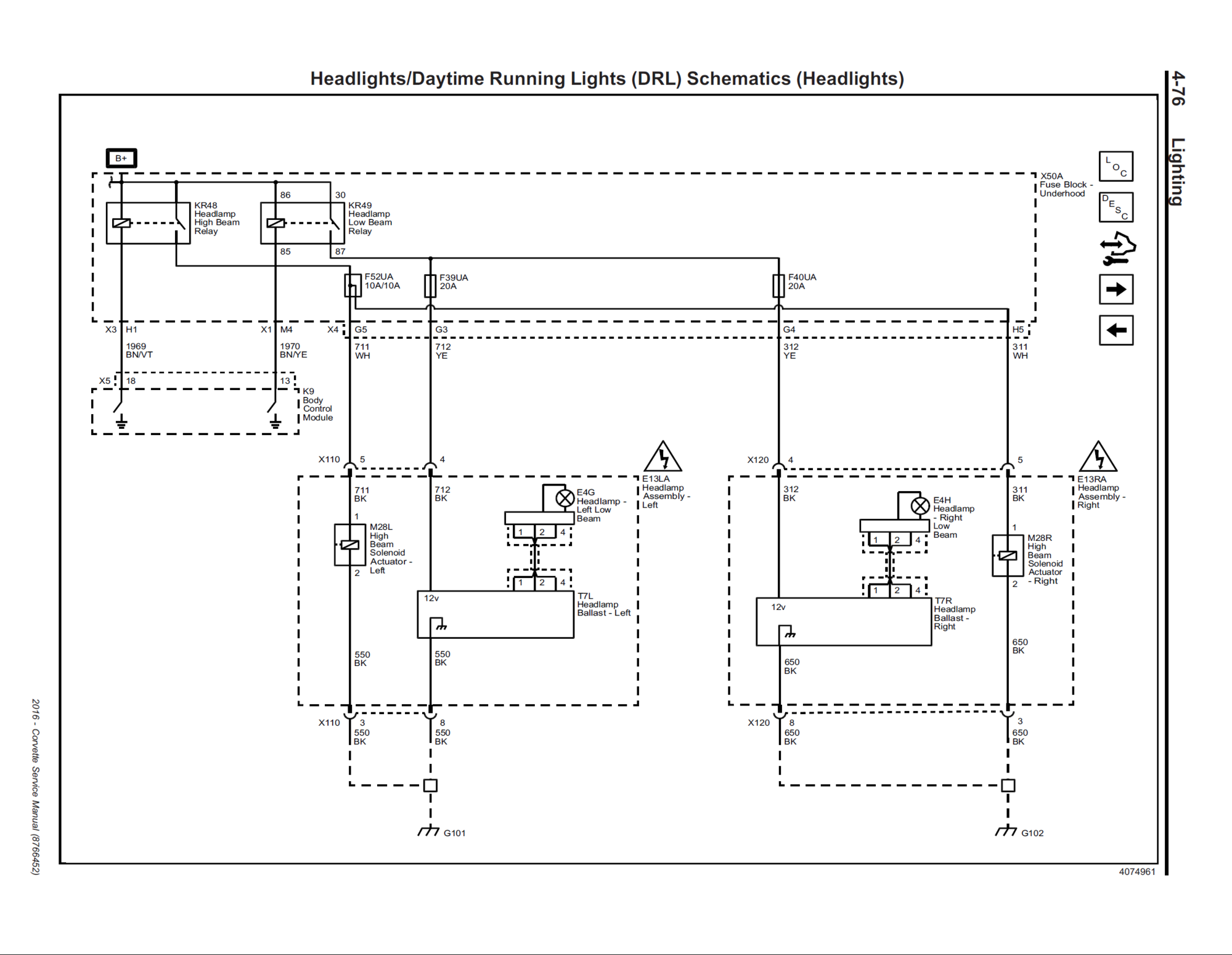

I agree it seems very odd that both bulbs would fail at the same time. That means two failures occurred at the same time and that is highly improbable. There are other things that need to be checked before going to all of the work to replace the bulbs and then find out you didn't accomplish anything except to spend money.
Common items that can affect both headlights are the Multifunction light switch, the BCM and the wiring going to the relay along with the relay socket. You should use a diagnostic scanner that can read body codes (Not an OBD2 only scanner) and check for one of these DTCs: B258A01 or B258A04.
