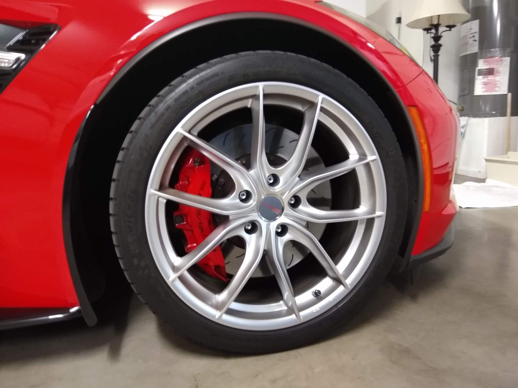

I just went through this a month ago. Recycled the OEM wheels as they are pure crap by design and I couldn't bring myself to sell them to anyone else. Paid $2K for OEM flow forged ZR1 wheels. Couldn't find any others I liked for the price. I won't track it, so block forged seemed too costly ($5K +/-).

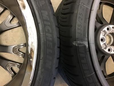

Nope. It will re-crack worse than ever at the first significant impact. Ask me how I know. Both rear Z06 wheels were cracked at 23k miles when I pulled the rims for tire replacement. Within 2 or 3 weeks later, the LR tire started a slow air leak. After pulling the wheel off the car, found that it was the crack leaking. Crack grew enough toward the barrel to start leaking. Had a professional TIG weld repair done by a shop that does nothing but wheel repair and powder coating. Then two weeks later, ran over a 2x4 piece of lumber in the dark at freeway speed and that TIG weld cracked instantly and was losing air at a psi per couple or three miles. Got it TIG welded again just as a temp fix until I could get replacements. Fact is that the TIG weld is weaker than the original cast aluminum material. Wheel on left after the second TIG weld. The right is the other cracked wheel rim not yet leaking air on a continuous basis.

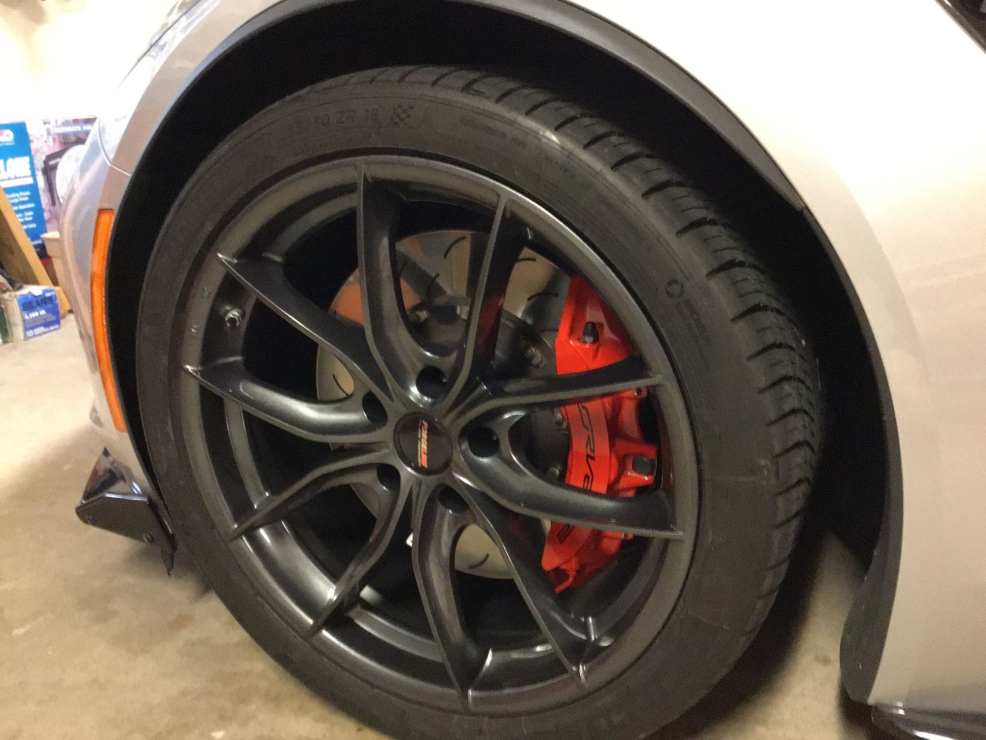

Here is my car with a new set of flow formed Forgeline F01s in anthracite from CW4L. They are actually less expensive than a set of GM OEM wheels and better made.

Yes. I have the same. Mine are satin silver. Only difference. Have 70K on them and have run over a lot o potholes. Still like new. Paid $2,200 for them. Got them through Discount Tire because they warranty them for as long as I own the car. Cosmetic was only one year. Any crack, I bring it back. Free replacement. Fortunately they are golden.
