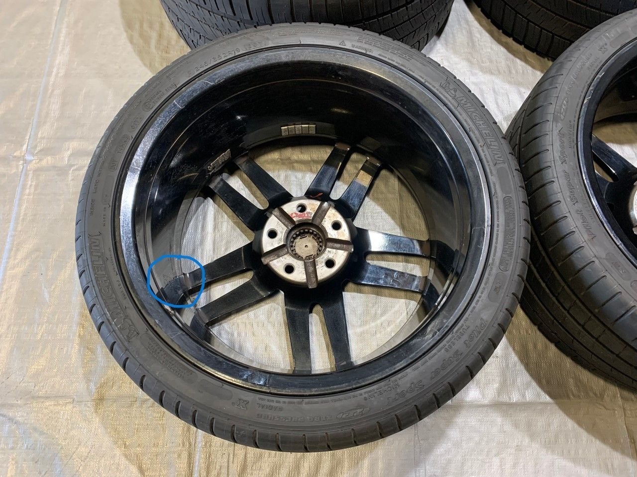

I'm looking at a set of what are supposed to be OEM Stingray wheels on Facebook marketplace. But the seller says there is no stamping to indicate the size. Should the size be stamped on them if they are truly OEM? And what sizes did this design come in? Were they 18/19x10 or 19/20x10? I'm looking at them for my C6 base.

All the OEM wheels I've seen have the GM part number cast into them, usually on the backside of one of the spokes. I'd want detailed pics.
Size depends on if they came from a base Stingray or one equipped with the Z51 suspension

Okay, thanks. That confirms what I was thinking. There is definitely no stamp on the spokes. I'll see about getting more pics or I may just have to make the drive to see them.

Pretty sure only OEM wheels can have Corvette cast into the wheel.These should be factory wheels.

If those are OEM wheels and not reproduction ones, they should be 19x8.5 and 20x10. That wheel design is off a Z51 car. I would think that somewhere on the back side of the spokes the size would be on the wheel. If they turn out to be reproduction wheels, I would still think the wheel size would be imprinted on the back side off the spokes.

Maybe its just the pic but the Corvette logo looks weird. Like its stuck on rather than stamped in.

The fact that he has them face down on concrete is enough to walk away

Yes definitely looks like something wrong there.

Based on what you all have said, I think I'll pass on these. Thanks to everyone that replied.

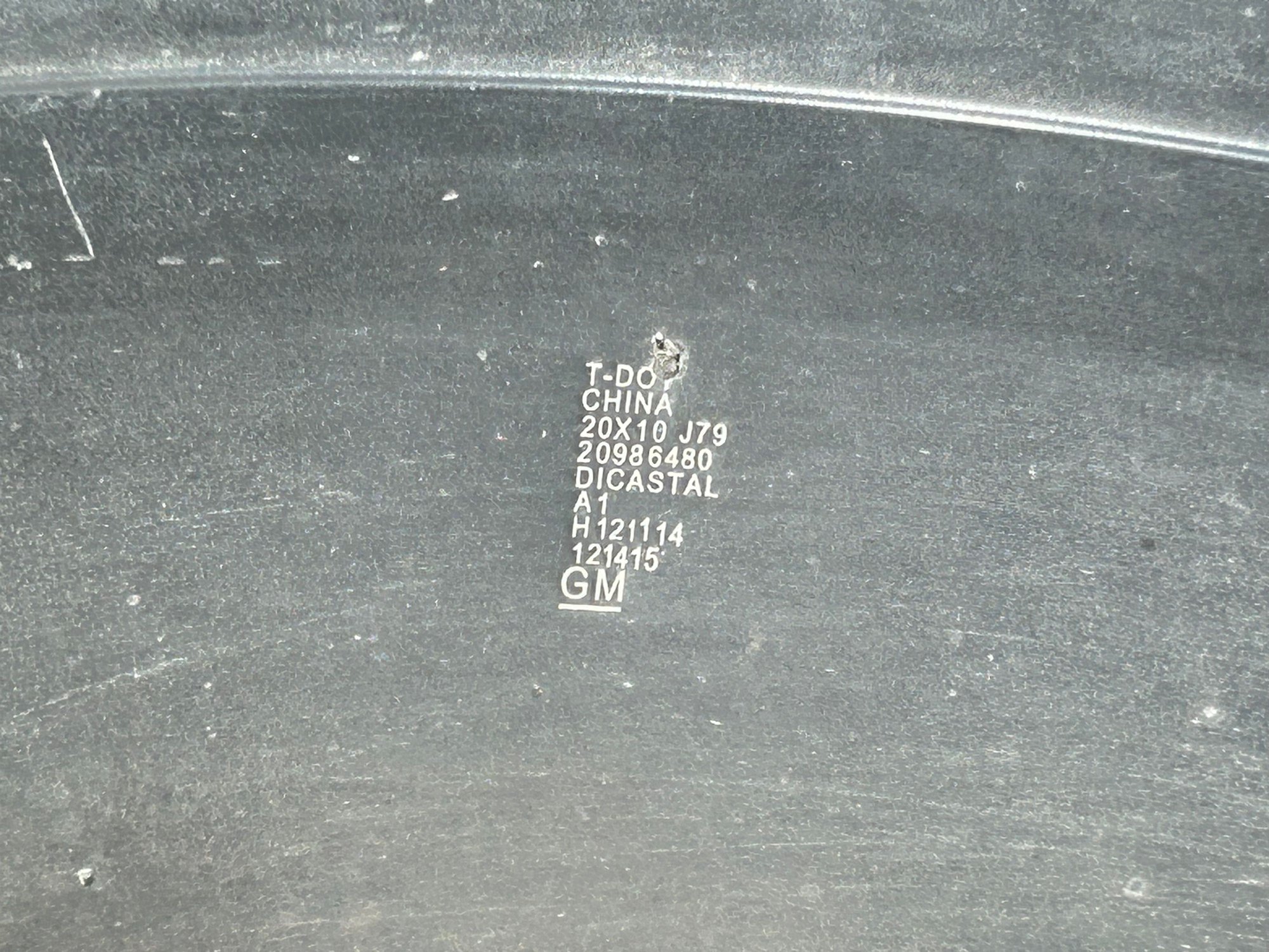

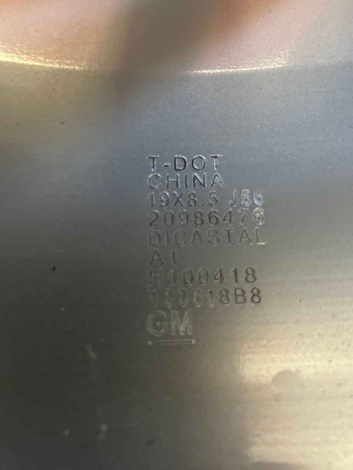

I was curious so I did a little digging to see if I could find where GM marked the wheels. While not on the inside of one of the spokes, they did mark them inside the barrel. Should anyone decide to pursue the advertised wheels or a different set, here's what to look for (and yes, if you look close you see "China" in the last pic as well as the size)...

Thanks for those pics. That's what I was originally trying to figure out.

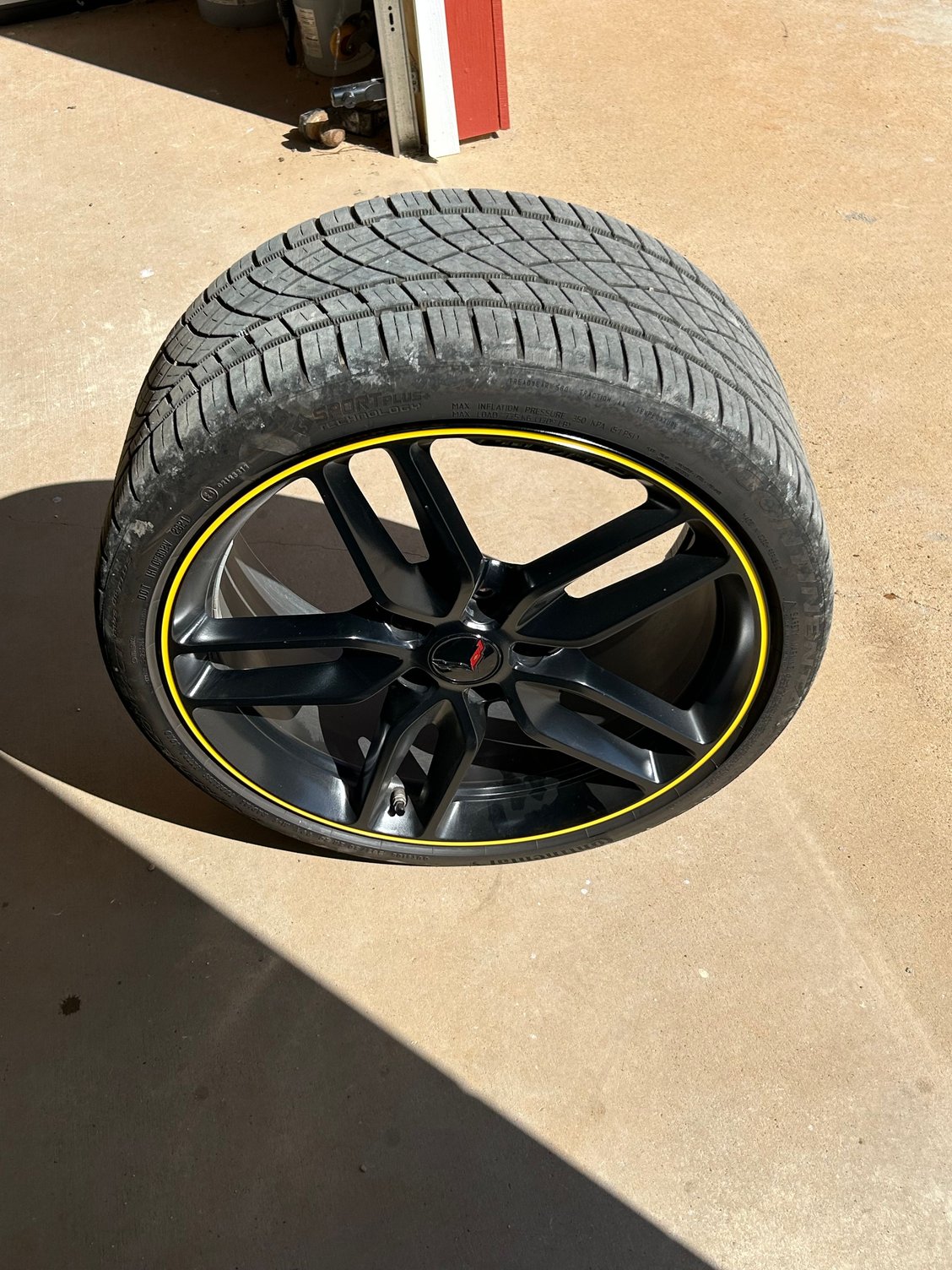

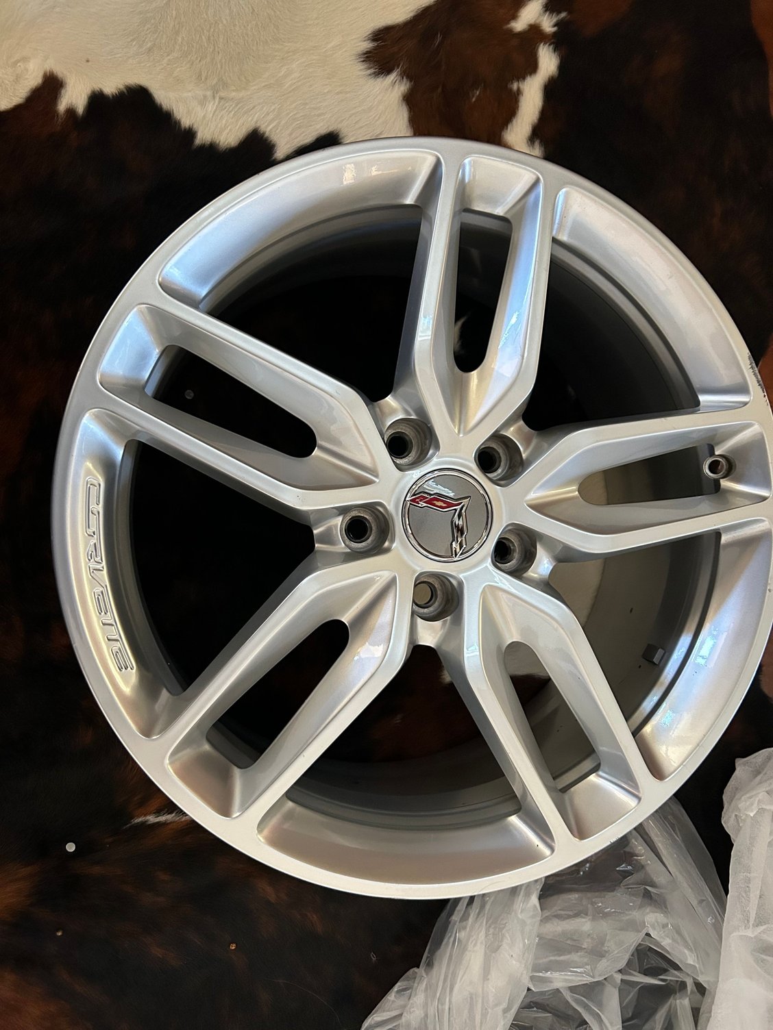

Here is what i just bought. Was told they were off a’19 convertible.
packaged very nice from the Z06 style which replaced em.
these have to be reproductions, yes?

well ... it bothered me enough, I proceeded to the garage in 107 heat ... removed the LR wheel ...
same stamp. So ... do I have 8 OEM C7 Z51 wheels ... and GM imported 'em from China ...
do I have 8 knock offs?

They're all OEM. The GM supplier....Dicastal North America.... https://www.dicastalna.com/ ....produced them in China
