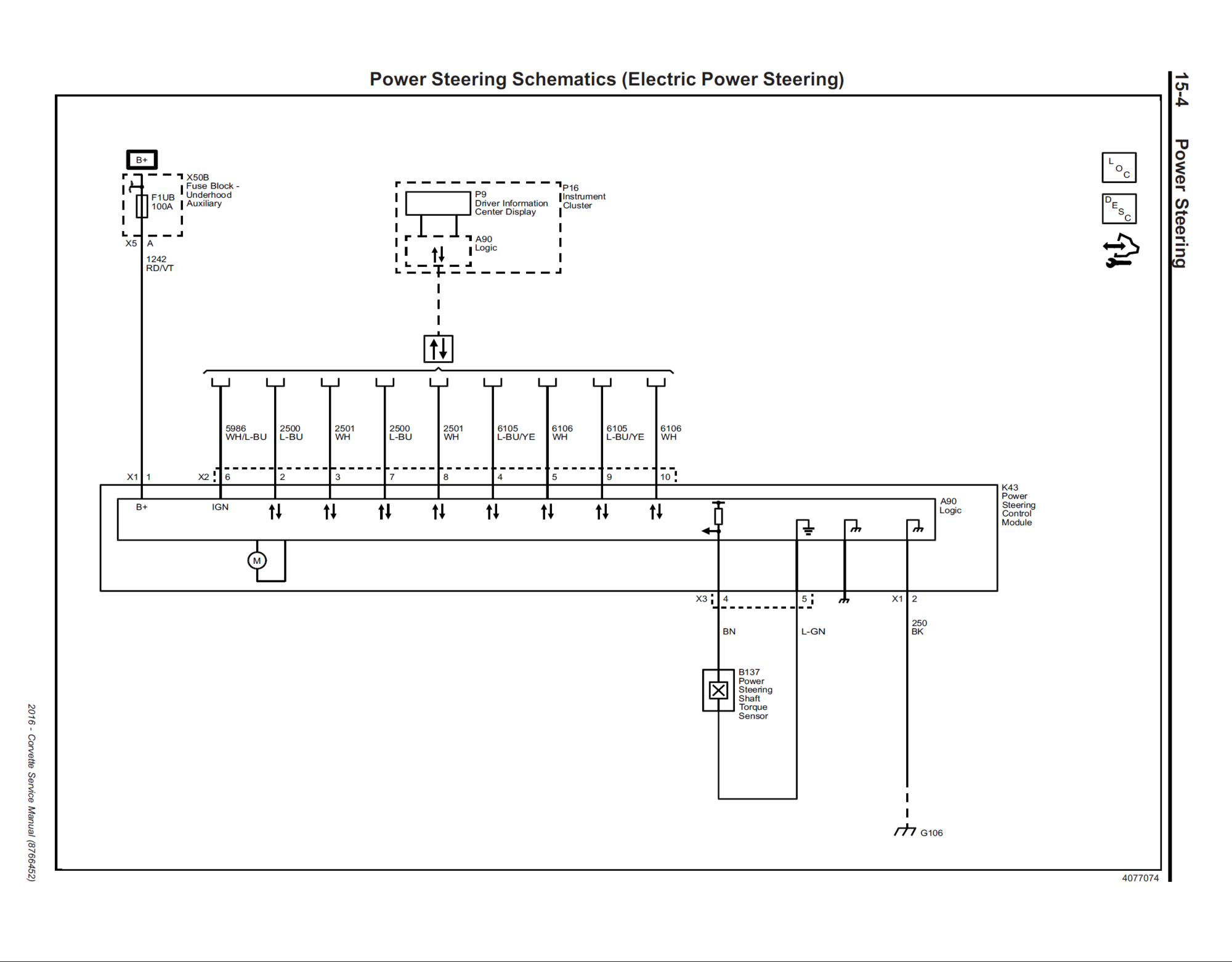

Here is the limited info the FSM has on the steering:
I believe steering assist is calculated by the Software in the Power Steering Module and the PS Motor is driven by the module to provide the desired assist.
Bill

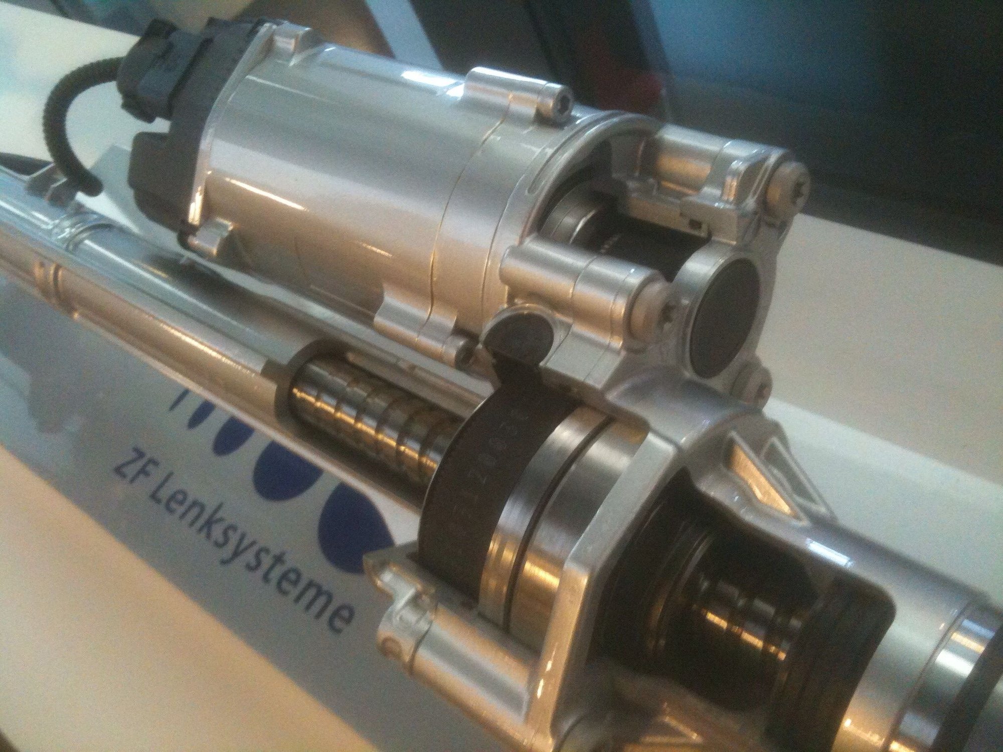

The electric power steering system is engineered by Bosch (Germany) partnered with ZF (Germany), and the units used in the C7 Corvette are manufactured either in the USA or China.
Electric Power Steering Belt Drive Servo Unit (bosch-mobility.com)
Some Porsche models use similar units made by Bosch/ZF, but those are made in Germany.

You refer to a pump. The C7 steering rack is not at all hydraulic; there is no pump. C7 steering power assist is accomplished entirely by an electric motor mounted to the rack itself. This actually may make it a better candidate for a swap, as you do not need to deal with hydraulic lines or translating signals to a pump to alter pressure.
