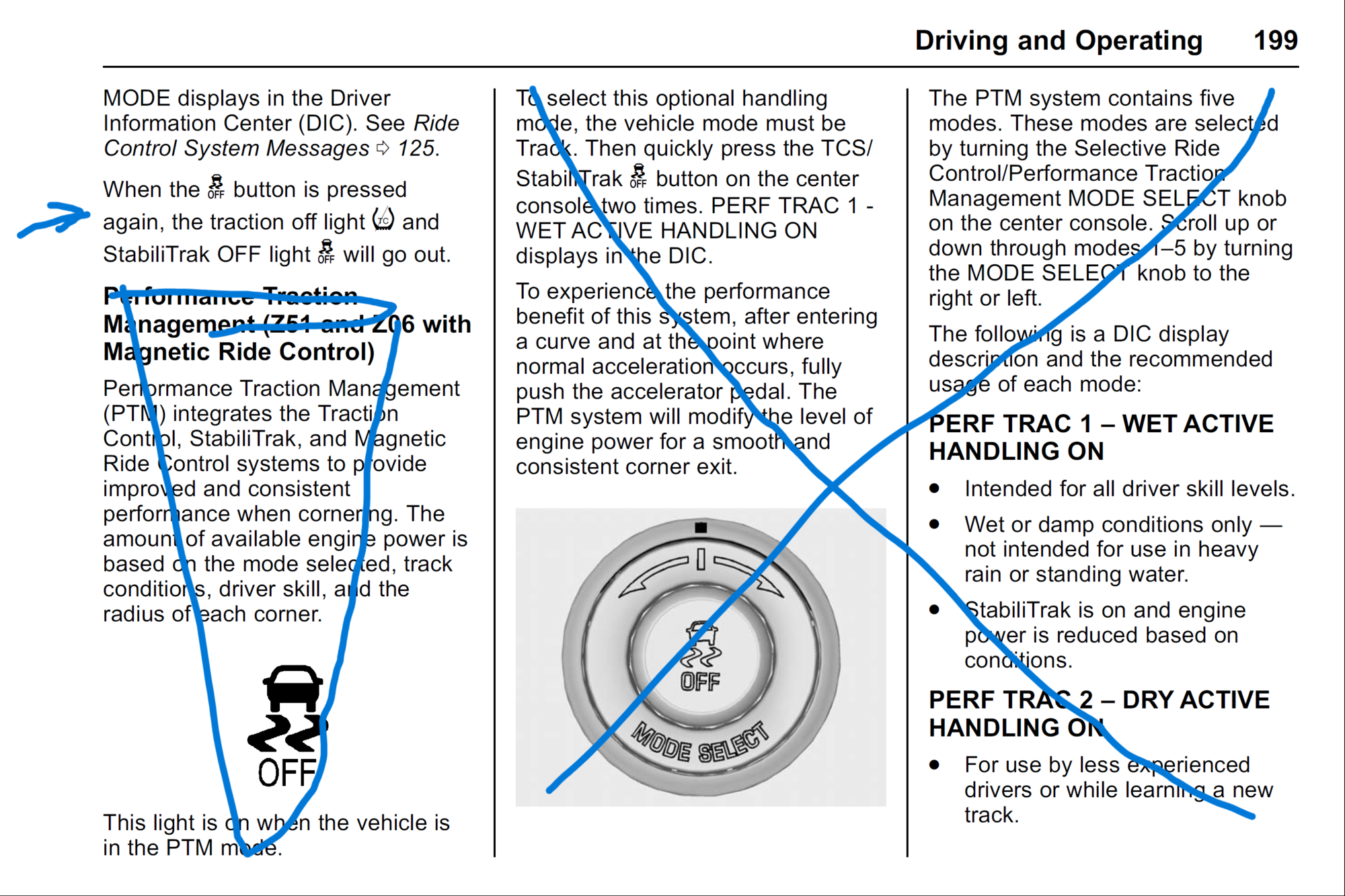

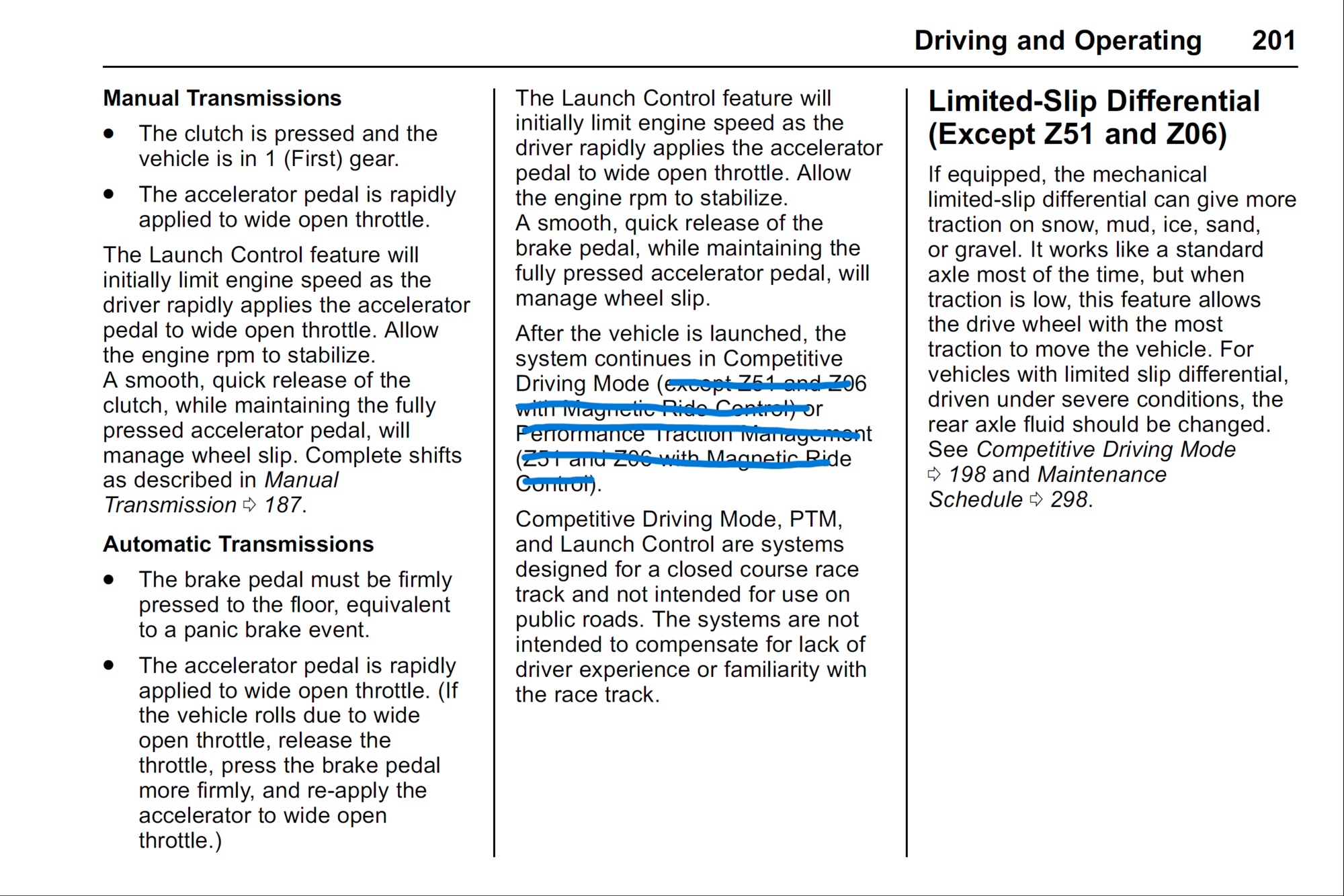

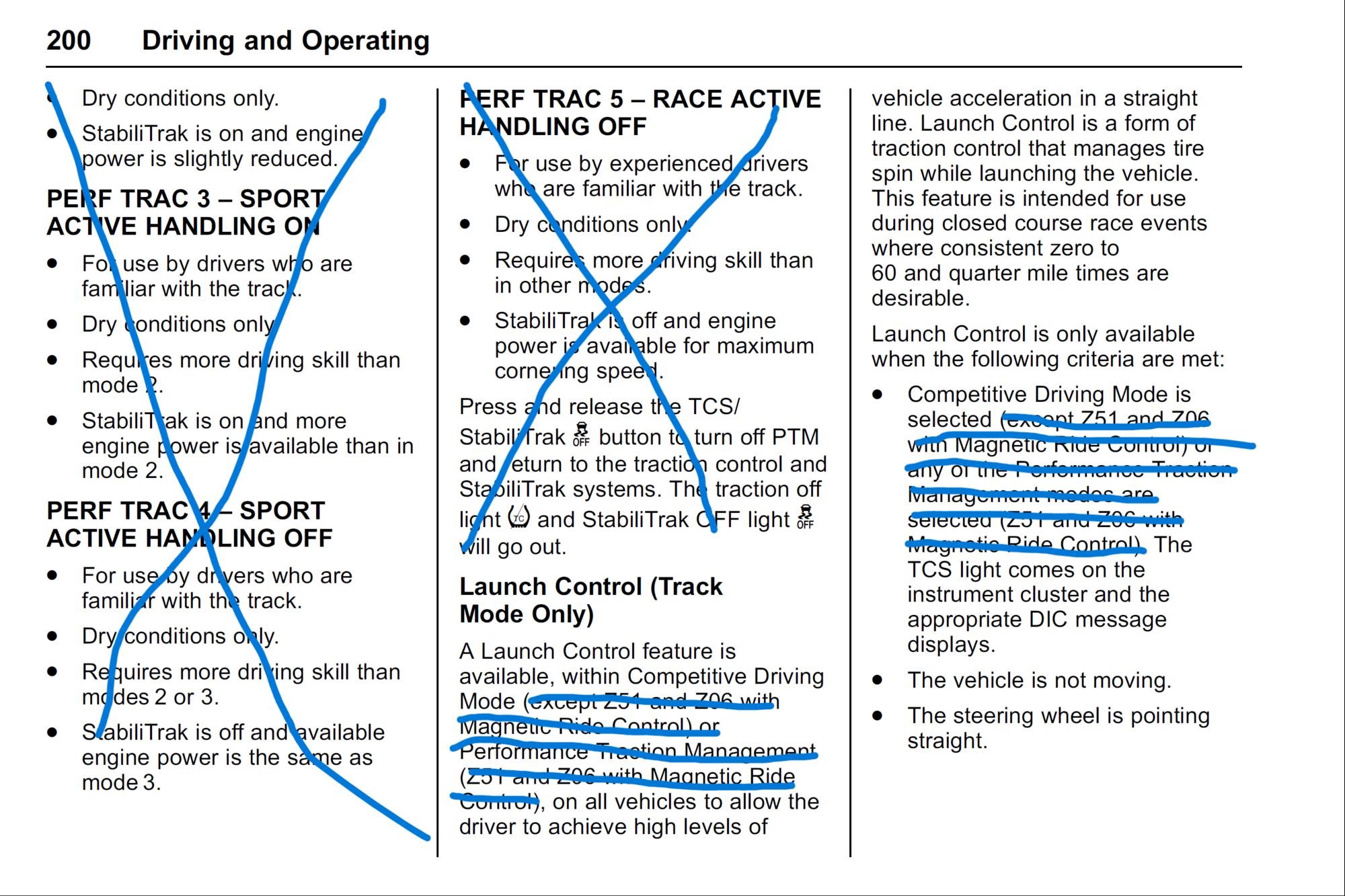

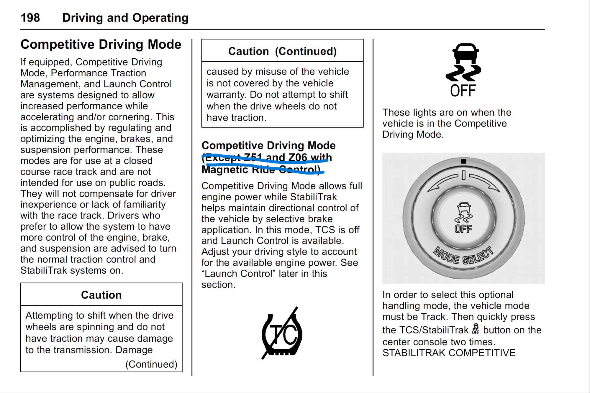

Make sure you follow the OM directions which can be somewhat confusing since GM mixed two features together in the description. Here are the 2016 OM directions with the magnetic ride control/PTM words struck out.
The arrow above points to a key point. If you push the center button a third time you shut off comp mode.
Bill
