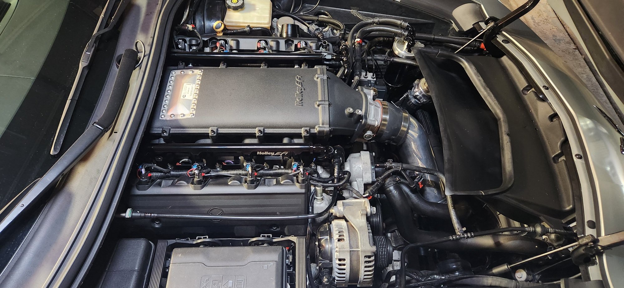

Got the Wiseco pistons installed, the Holley ultra low ram with port injection.
Also installed the Reflex controller from Too high psi along with Dsx low side.
Previous best with Lt4 fuel system with kenne bell bap on 40% e85 was 631whp and 677tq.
Going with full e85 and shooting for 850whp this go round.

Very clean install and I like the heat extractor stays in place. Are the two ports on the valve covers open to atmosphere or not plumbed yet? Also, wet sump?

Its wet sump. Nice eye on the valve covers. They just get caps. Im running the Tracy Lewis catch can setup.
