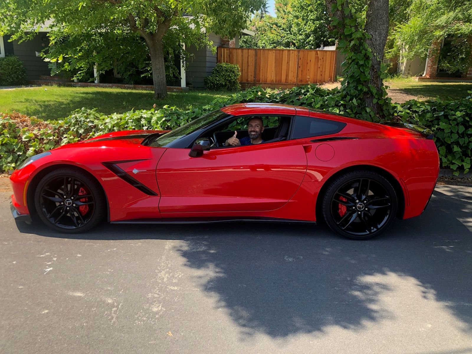

My 2015 7spd Stingray

Cool.. It already has the splitter and side skirts.
And looks like a stage 2 rear spoiler.
It also has the Z51 wheels but not sure of size here. It could be a ZF9 car, which is the Z51 appearance package.
ohh, you may be right (though, Im not familiar with the Zf9 package)! I really wanted a z51, but couldn't find one at the price I wanted, then I found this one and really liked it. the wheels are 245/19 in front and 285/20 in back. Prior owner added at least the front lip and skirts (ACS).
