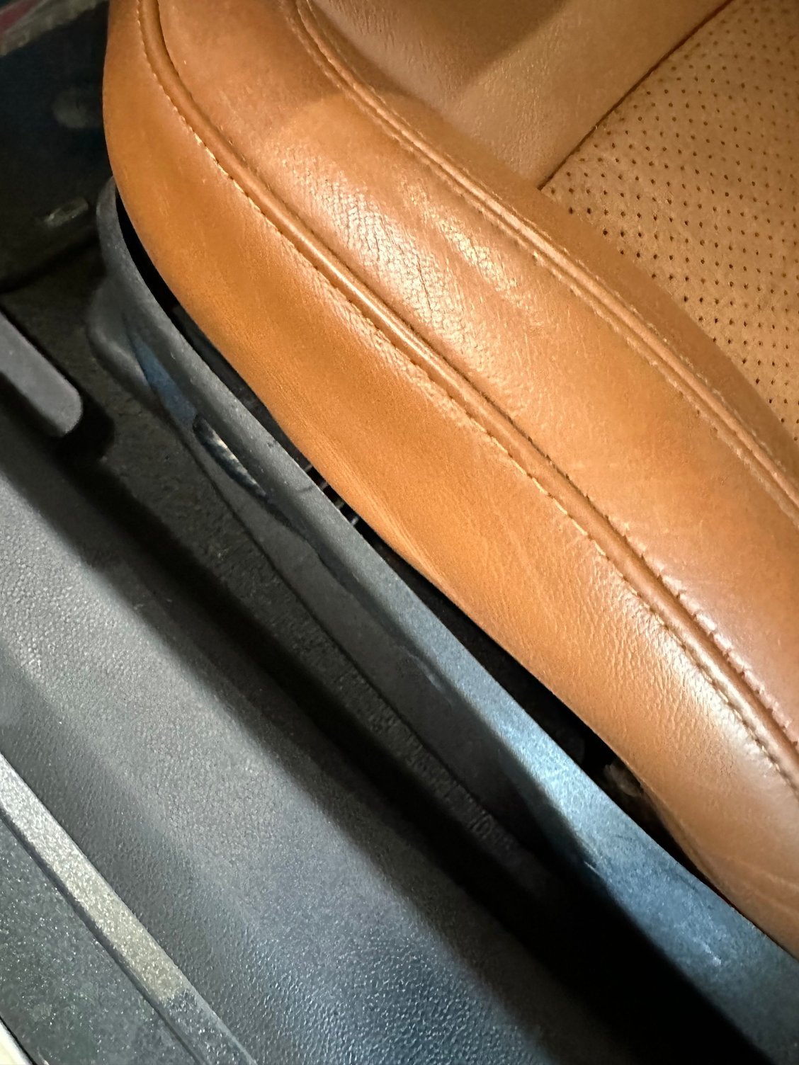

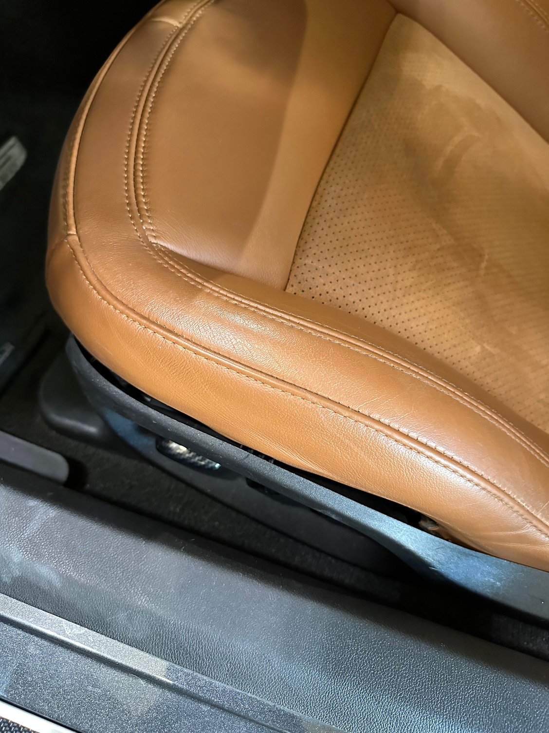

Any idea on how to repair this? Looks like the plastic bracket for the seat is coming detached from the actual seat?

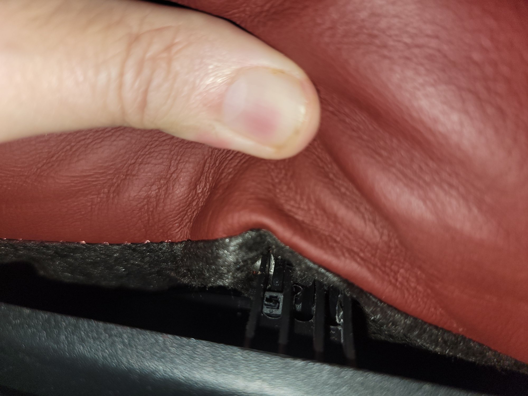

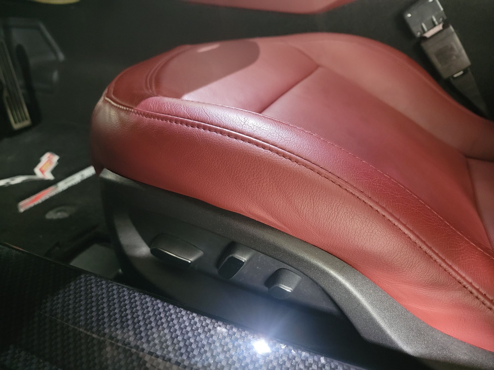

Here you can see the holes I drilled in the broken tab and the zip ties used. This is a simple fix. Below is after the repair. Looks like it never happened.
This is awesome. I was wondering how to repair my drivers seat. Thank you so much vette400 for the reply and photos to this post!!
