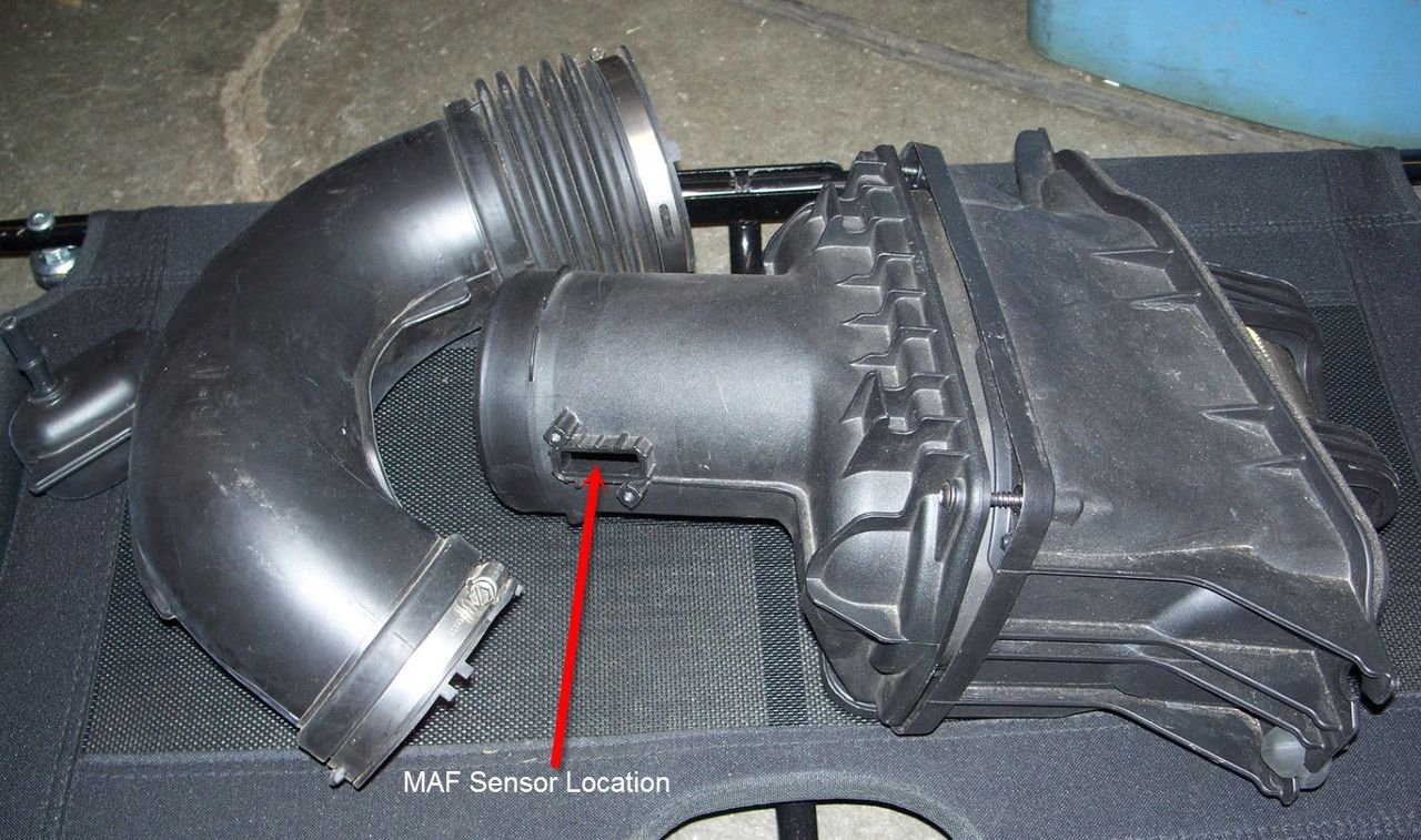

Simple fix - just buy a new Mass Airflow Sensor and you should be good. Just did this exact fix myself, two screws on the intake tube and you're done.
Just be sure you don't have any oil or debris on your current sensor. You could always remove it and clean it with MAF cleaner (it's specific for that sensor - don't use brake or carb cleaner). If you still have the code, replace the sensor and be done.
I bought this one and no more codes -
Amazon GM MAF Amazon GM MAF
Here is where it goes (borrowed from another CF thread:
