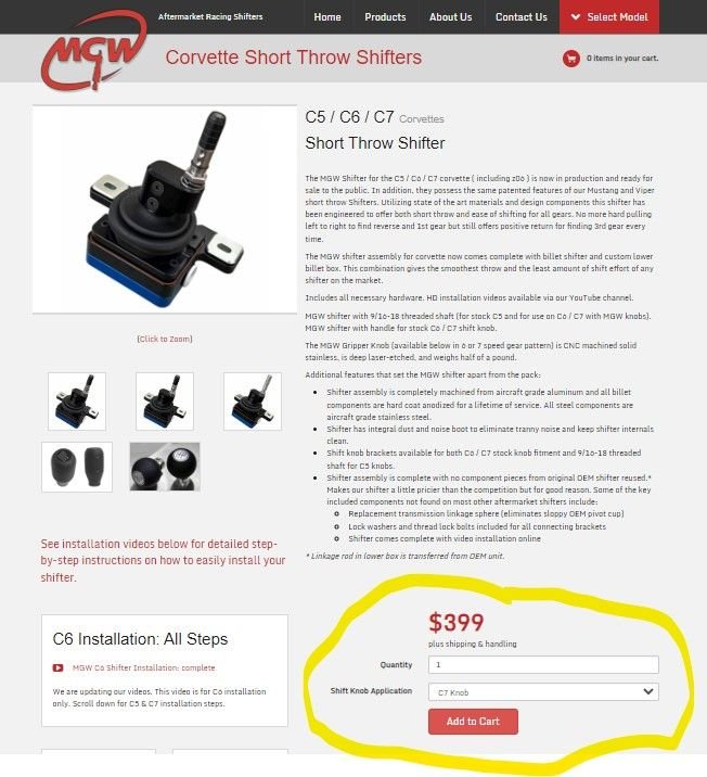

Thanks! Exactly what I’m looking for. Which one did you buy? On the MGW website it doesn’t seem like there’s an obvious option for stock vs non-stock appearance package. Is there a link you can share?
Old Sep 12, 2023 | 09:59 AM
mittens's Avatar
mittens
Joined: Nov 2005
Posts: 4,399
Likes: 950
From: Huntsville Alabama
MGW Aftermarket Racing Shifters (mgwshifters.com)
The Shifter with lower box is the same for C5-C6-C7 cars.
Then in the drop down box for shift **** application select C7 K ***.
Add to cart, that's all you need.
The other shift **** applications just change the upper part of the **** so you can thread a ball on, or a C6 ****, or a C7 for example. If you click on the first 3 pics you can see same shifter with 3 different uppers. a threaded one allows you to use other ***** if you want. The C7Z I just bought had the short "Gripper ball" and handle on it and I hated it. Hince the new/used factory ****, and boot that I installed missing the ring. ha

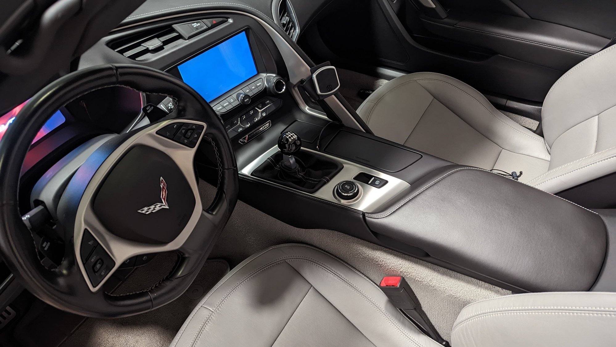

This is my MGW. As others have said, there is little difference other than slightly in height.
Here is a screen capture of the main page for the C7 MGW shifter. To get the stock look shifter just chose "C7 ****" option in the Shift **** Application box, add to your cart, and checkout!. All other options below this are for alternative MGW shift *****.
(NOTE: You might be able to get a 5% discount if you use MGWPATRIOT as a discount code when checking out.)
This is exactly what mine looks like, including the Adrenaline Red and Red stitching!
