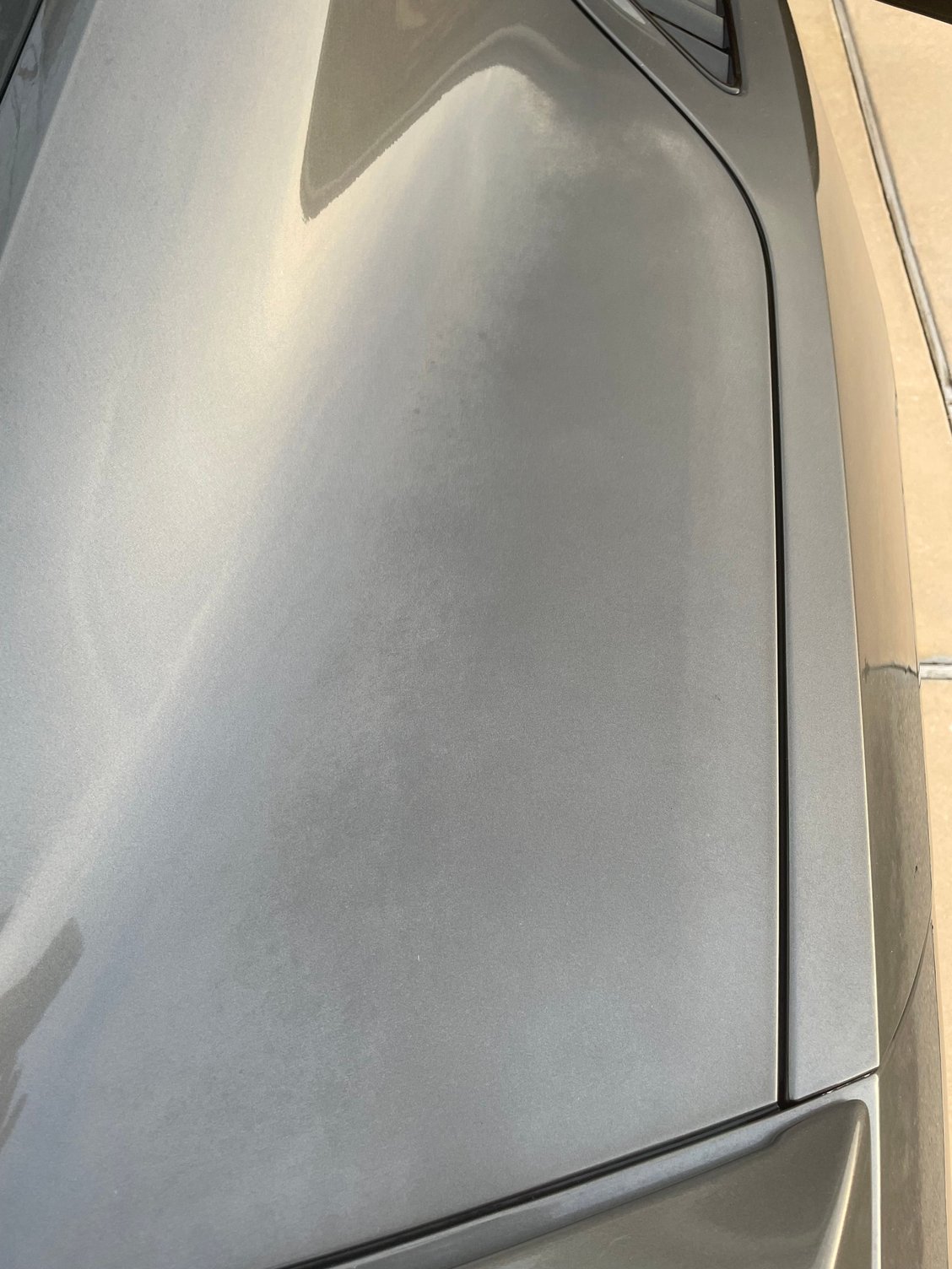

Photo of hood as you can see it is in spots . The edges around the vent are fine but other sections are faded and rough. Could parking outside in the weather be a contributing factor, possibly but I also park my 2008 Toyota truck outside and this hasn’t happened to the paint job on the truck. I also parked my 2009 vette outside for 7 years and when I traded it in on this vette it still looked like it came off the showroom floor. This is why I wanted to know if anyone else who owns a 2016 has had the same issue. Just trying to decide if this issue should be addressed with GM/Chevrolet or not.if this was a defect i would think they would have known about it and put out a bulletin or did a recall, but I don’t remember seeing one.
Roof line including back glass notice the difference between roof and rear section
Notice the difference between middle of deck and edge and top of rear quarter panel

Pictures do help,Bigly If your not the original owner?Who knows what care and abuse may have happened?From here looks like your clear coat was compromised.
Or poor factory application or something helped in the fading?A bad chemical or it could even be wax left on to bake at one time.
Obviously it wasn't purchased this way.What was your care with it's finish?
This could be moved to the car care scientists over in that section.

If I where you.If you have a light rubbing compound hanging around?Pick a small spot.Give it a little finger rub.Then finish buffing a bit.See if it clears up.
I would search for a shop that specializes in paint correction.The paint shop likes to paint

I had a 2016 Shark Gray Stingray which developed clear coat fracturing all over the top surfaces except the roof (probably due to it's painted separately). All the paint experts agreed it was a factory defect, the clear coat was probably applied for the paint was fully cured. And I have read other people with the same year and color having similar issues. I also had issues with the hood, mine had the exposed carbon fiber option. Well on the very front edge the clear coat was delaminating from the carbon fiber. It looked like chips but was smooth to the touch because it was happening underneath the clear coat. As far as the rest of the car, GM pretty much gave me the middle finger saying my car was no longer under bumper to bumper warranty. Even though the car was meticulously maintained and ceramic coated. I ended up filing a complaint with the BBB on the whole issue. I ended up having all the top surfaces repainted and the clear coat on the hood repaired at a cost of over $5000. The looked better then new when finished. GM, well they reimbursed me a whole 10%. I sure hope the $500 they gave me didn't effect the GM stock!

Hi Bassmobile, first of all, really sorry this happened to you. If your paint experts suggested that the color coat(s) needed to be fully cured before applying clear, it is actually the opposite (mostly). You want the color coats to be flashed, but if they wait too long then it is necessary to color sand and prep the color coat prior to clear for best adhesion. This isn't a guess - I belonged to the ISCA for some years and won multiple best paint awards.
So, the OP could have had an issue with contamination between color and clear, or some other issues. It shouldn't happen in a quality environment, but stuff does happen..........and unfortunately, some adhesion issues may not crop up for a longish period of time.

That looks awful. Who knows what went wrong, but it isn't common. Having seen it I doubt anything is going to salvage it, especially since it has a wonky feel, as well. I'd suggest simply taking it to a good paint shop and getting it fixed correctly (repainted) and move on.
