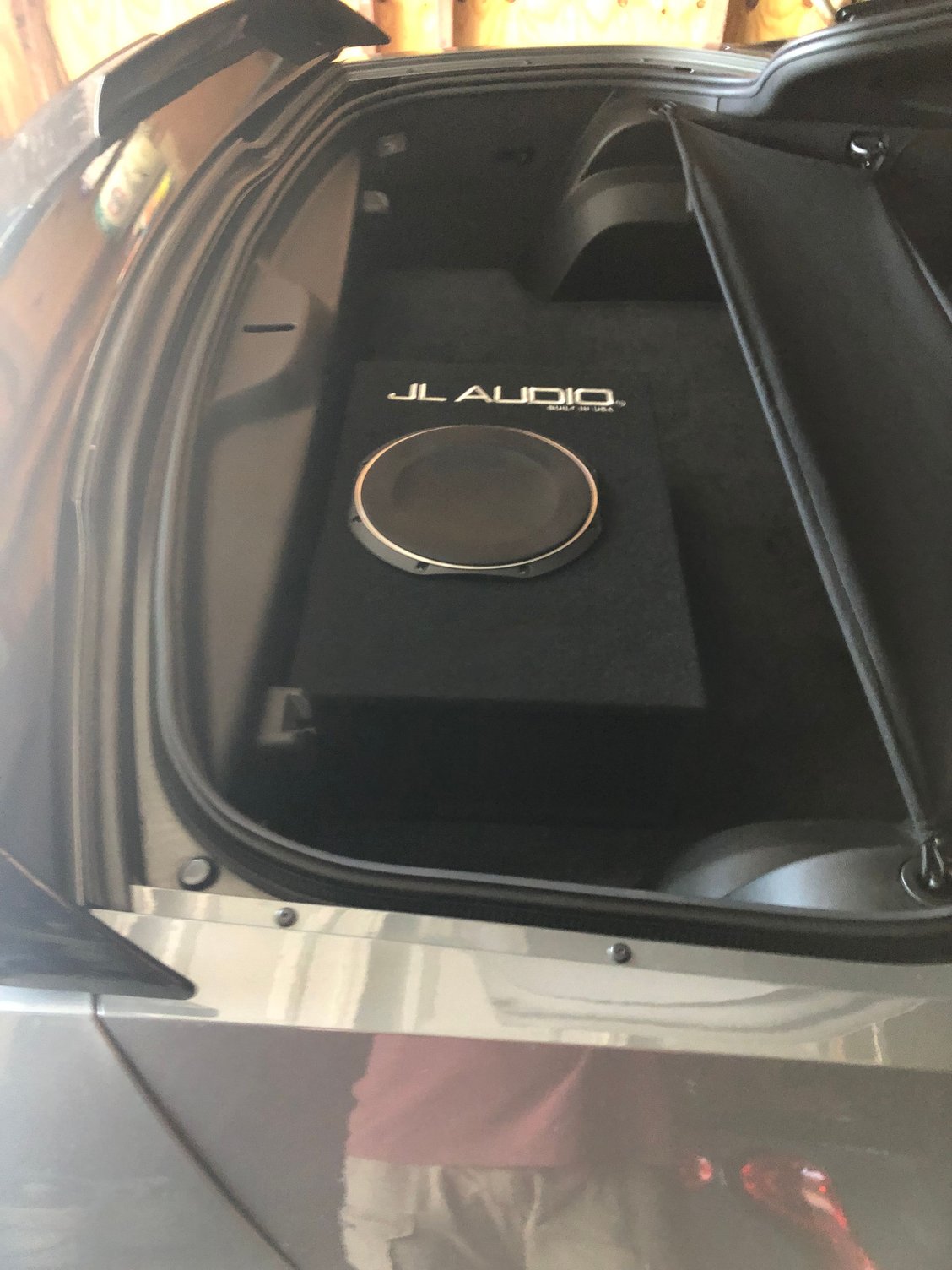

Pic JL Audio 10" Microsub

I agree with JL if the budget allows. Rockford Fosgate would be my second option but there's many to chose from. I would recommend at least a 10 inch in the trunk. See link below.

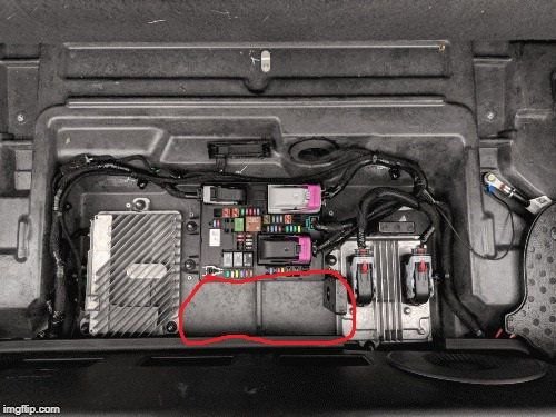

I put mine under the carpet where all the other electronics are. I bought some USB powered fans and ran them to the USB port under the arm rest. So when the car starts the fans turn on. One is located under the amp the other is pulling air from under the carpet. I put it behind the vents right under the rear hatch. I did this because prolonged running of the amp was causing thermal shutdown when really hot out (I'm in FL). Prolonged was hours not running to the store etc. you may not need fans. I also listen to my music loud so every bit of my amp is getting used. I'm the guy you hate sitting next to at a traffic light.
The red outline is where I put my amp so size is a factor. I used a JBL stadium 1000 watt amp.
Thanks for taking the time to answer! That’s smart!

Originally Posted by NCC-1701
I also thought about this sub. I have a Lloyds mat in the trunk like you do.
Did you trim your mat for the sub to fit? My understanding is that it goes in the cubby in the corner.
Old Dec 10, 2023 | 09:47 AM
Jaykoh-Z51's Avatar
Jaykoh-Z51
Joined: Oct 2014
Posts: 1,733
Likes: 403
From: Atlanta, GA
I have this Stealth Box as well. Lloyds mat too. I cut the mat to match the opening for the cubby. The Stealth Box...it has a large section the protrudes down under the woofer. That's what goes IN to the cubby. No issues storing the targa top.
My amp is installed where the factory sub was. I put an LC2i unit where the other guy here put his amp. The LC2i takes the Bose logic out of the "base roll off". Meaning, when you currently want to crank the volume, Bose will begin to reduce the base output.
The placement of MY amp is great as far as being out of the way, but it's a bit of a pain in the *** to access when you want to adjust and tune it. I have to remove the rear panel to access the amp controls. I have a J/L Audio 500/1-D. That amp and sub is WAY more than the C7 cabin needs. LOL. I have mine dialed back. Never a worry about overheating or blowing the sub. Base control ****...I had mine installed where the cig lighter was. Looks stock.
