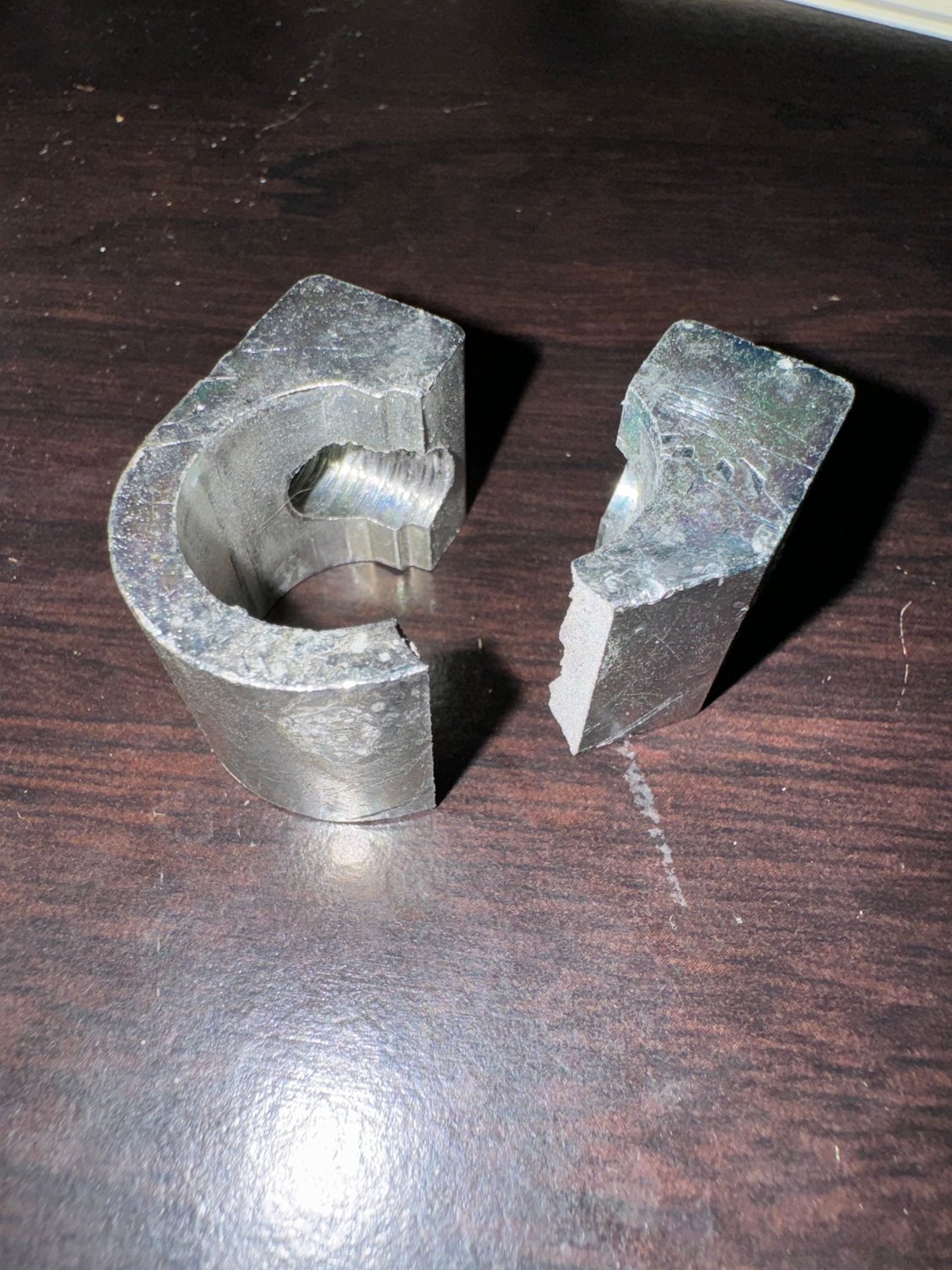

Hello all,
I was installing the MGW shifter today and when I got to removing the stock box, this bracket piece was broken.
Two questions:
  1. Can I reuse this piece as is? Would it still be able to apply the required hold in two pieces?
  2. If not, does anyone know the part number for this? I’d like to go to the parts counter and get this install completed today.
Thank you in advance!

If you can't find a new part use JB Weld cold weld to glue it back together.

I would not reassemble with a broken clamp. I installed my MGW about 7 years ago, you'll like it, do it correctly. 2014-2018 Chevrolet Corvette Multi-Purpose Clamp 19206520 | GmPW (gmpartswarehouse.com)

I don't know which is correct. Based on the exploded view in the link the part appears to be correct but can't speak for the number. I would imagine the odds of a dealer having the part are quite slim. A good weld shop could use a copper rod the same size as the shift rod journal as a backer for a full penetration weld then just a little touch up with a file on the bore. I've done that myself many times on different projects, the key is finding skilled people or the ability to do it yourself. As much as it's nice to get projects finished, waiting for the correct part can pay dividends.

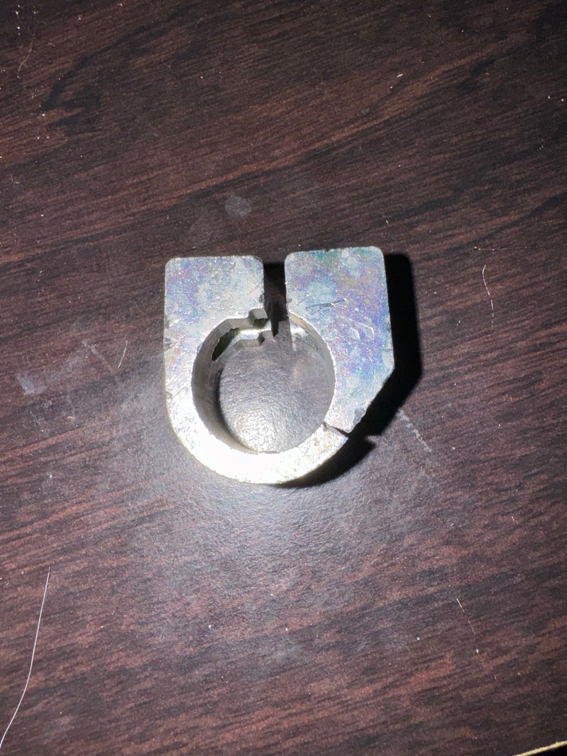

Default Comparison of Parts
Wanted to close the loop on this thread and provide a comparison of the two part numbers. I was able to receive the parts fastest from a local dealer and was able to complete the MGW install this past weekend.
In the attached pictures, part#24275039 is on the left and part#19206520 is on the right. The only discernible difference between the two was the notch seen on the inner clamp circle of part #24275039 (red arrow in 2nd pic). With that notch, part#24275039 was most similar to the OEM broken piece and ultimately what I used. Bonus that it was ~50% of the cost of part#19206520.
Hope this thread is helpful in case anyone runs into this broken clamp in the future.

Researching spare clamps for my C6 racecar project and stumbled across this comparing the two PNs because the 19206520 PN is verified to work for C6, but curious why the 2019 only car has a new PN w/ the notch? The shift rod assembly PN is the same for all C7 years/models. Interesting. Buying 2 520s and 1 039 just because.
EDIT - Looking closer, the old part is a consistent circle, the new part it's actually a "step" vs. a notch. That step makes the opening out of round which would appear to make it clamp w/o compressing the clamp quite as much? Curious if the later C7 shift rod end is different and the parts fiche is just wrong?
