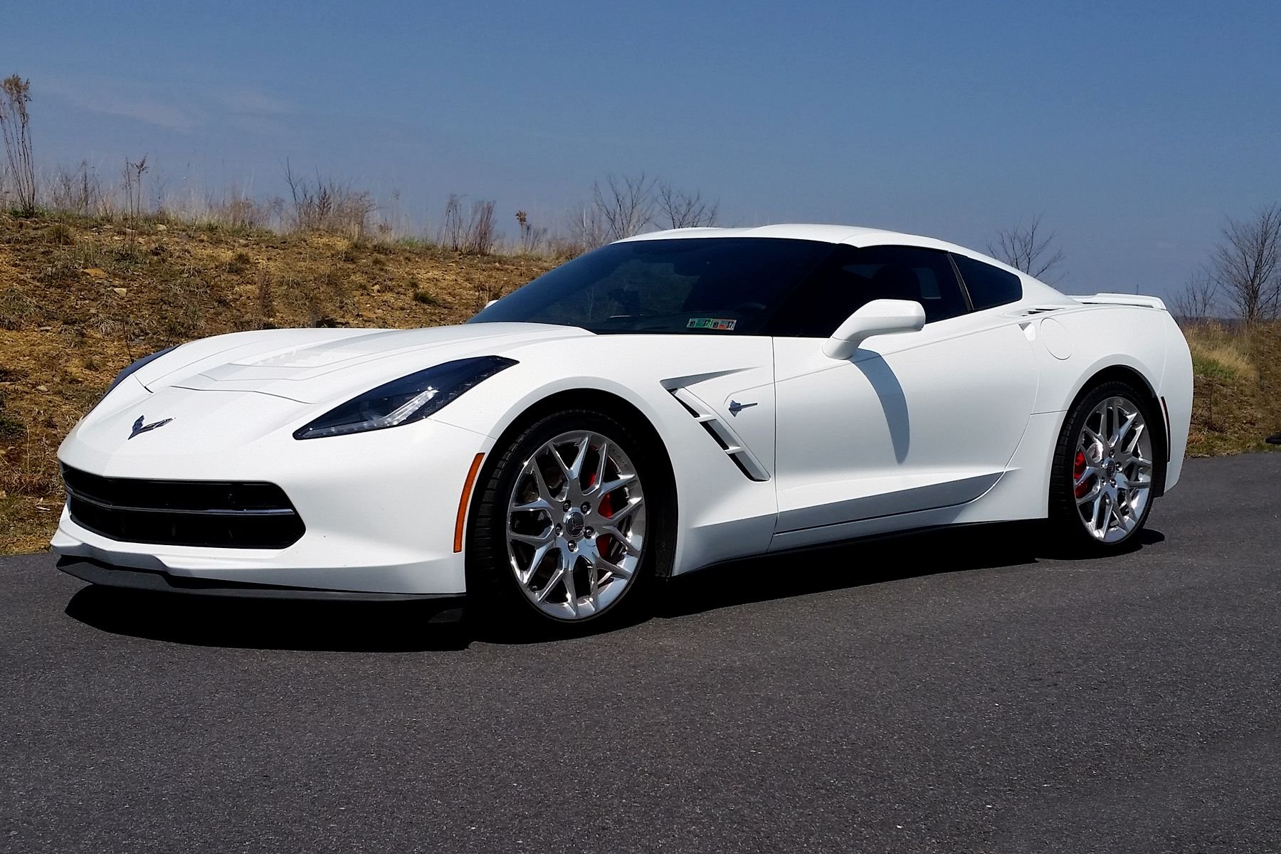

GM Motorsport R86 High Polished Aluminum. Rather rare so finding these will be difficult.
