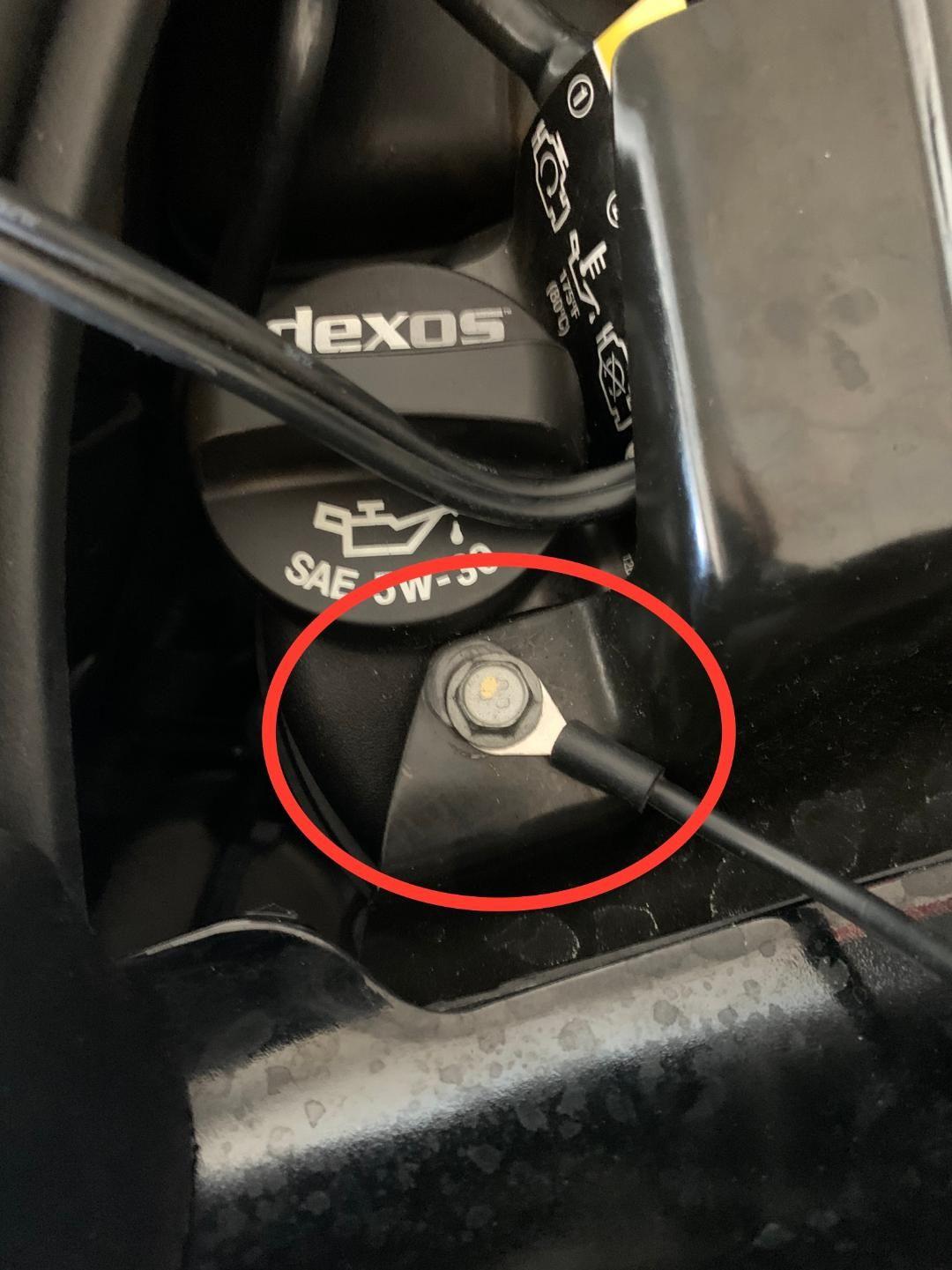

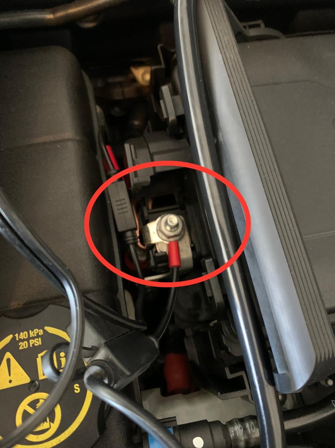

Go back to what has always worked for you in the past. I use the Battery Tender Plus and it stays on while in storage over the winter. I have mine hard wired to the car with the main lead coming out from under the hood, right at the corner of the windshield on the passenger side. Easy hook up
