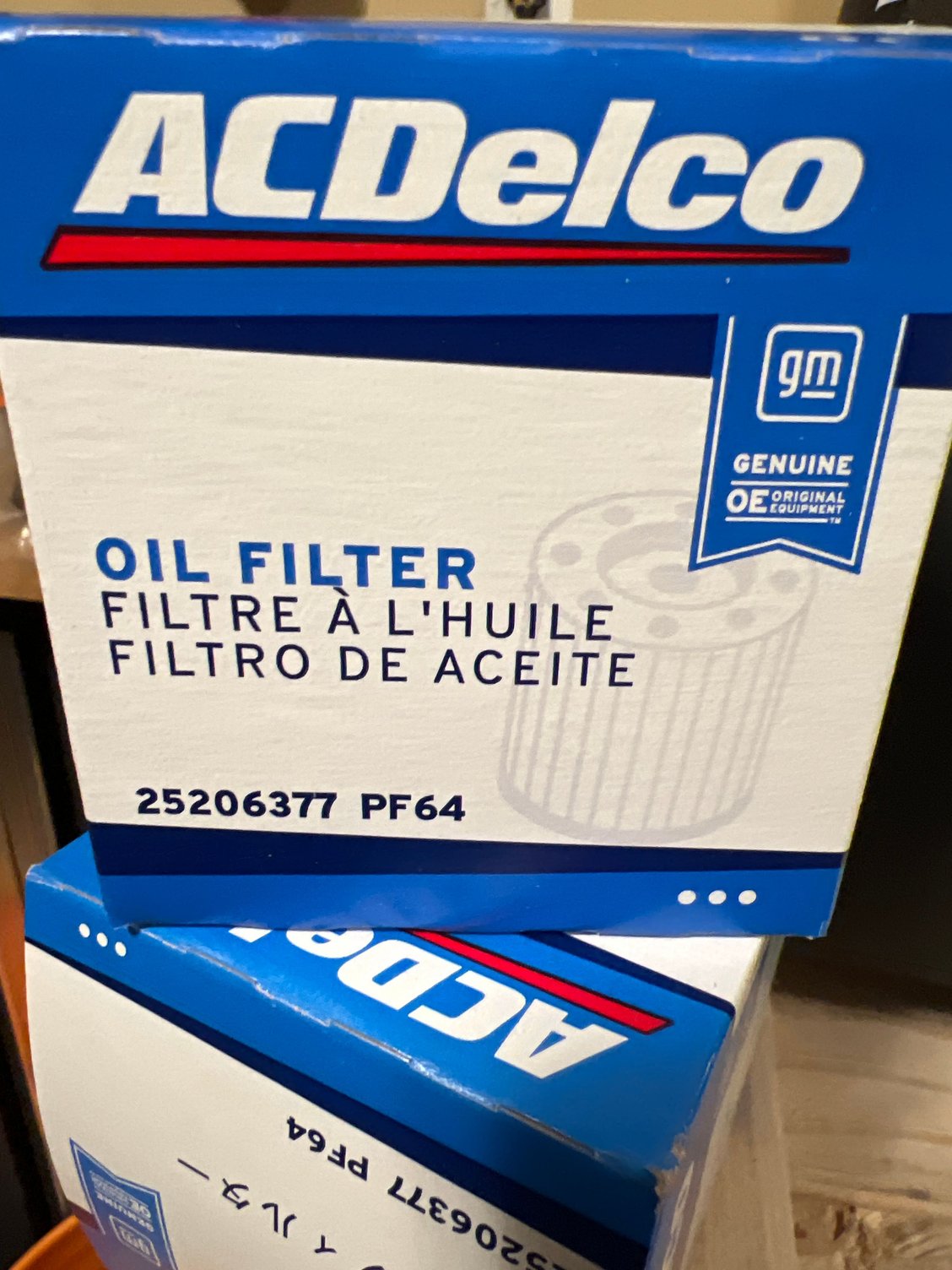

Is this right oil filter for my 2019 z06?

Technically, no. But the higher bypass pressure is unlikely to cause a problem.
Your C7 came with the PF64 oil filter (latest part number: GM Part # 19386865 (case of 12), individual latest part number: GM Part # 25206377).
However, the UPF64R is ok to use (latest part number: GM Part #
12699847). Although this filter's bypass pressure is around 35 psi compared to the PF64's of about 22 psi, the ACDelco/GM website shows the UPF64R as an optional filter for the C7 LT1 and LT4 engines.

Hopefully this is the correct one now ?

That is correct

Yep that’s the one👍

That is the correct one - I use it on my C7.
