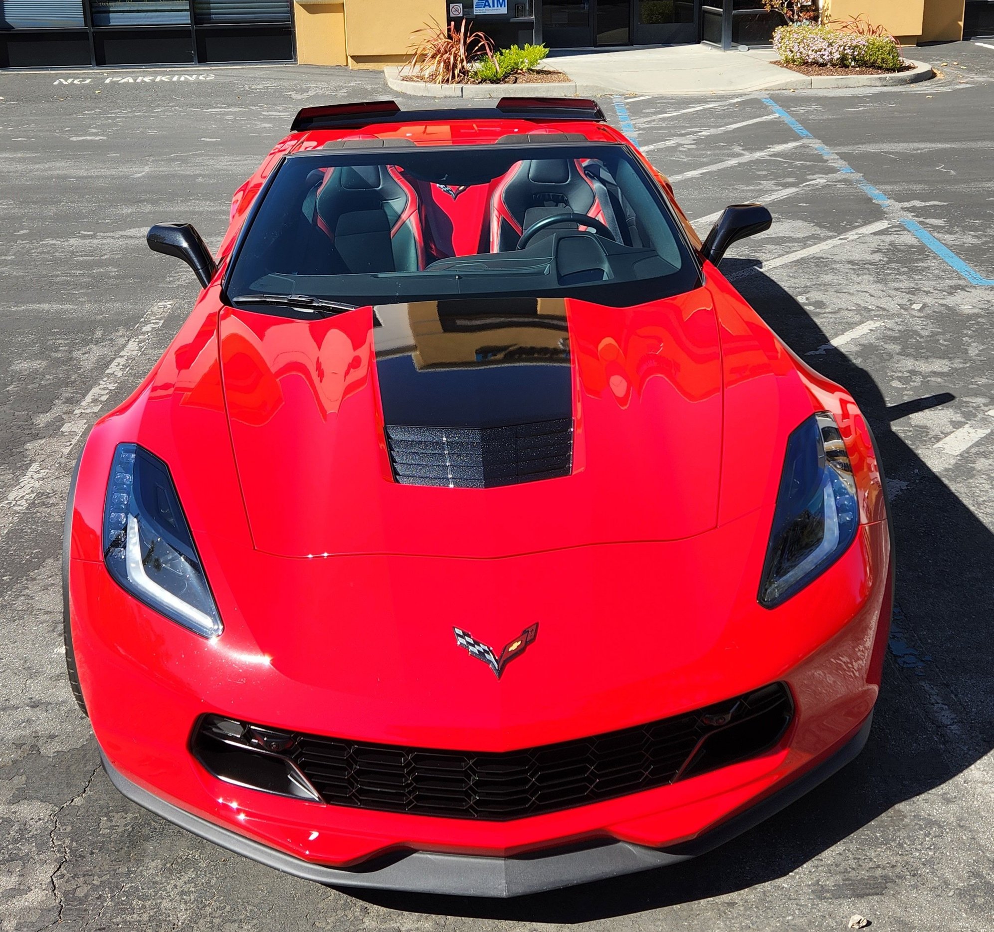

As Corvettezman noted the "subdued" logos are all part of what GM calls the Carbon Flash package which included the CF painted hood vent (below) spoiler, wicker bills, logos and side skirts. Some wheels and mirrors (as shown) are painted CF as well. Good luck. The hard part is deciding which ones to put back.

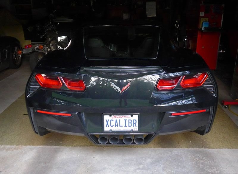

Black was an option and an obvious choice for my black St'ray... along with removal of the "Corvette" script and the silly rays on the sides that look like stylized electric guitars. Btw, my granaddaughter painted those purple with green and orange polka-dots: a big improvement.
