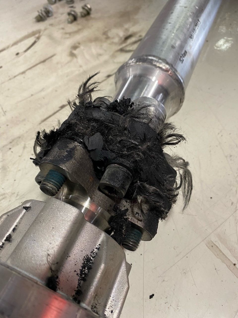

2014 Z51 6AT 55k miles, torque tube was destroyed couple years ago. Coupling rubber exploded but GM only supply whole assembly to replace. Kinda make sense to me. Almost $3,000.
