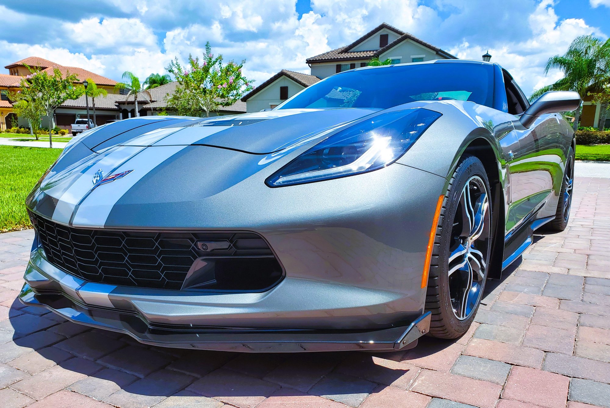

i went with the stage two on my Stingray because I thought the stage three would look out of place. I am happy with the results, but also think now the stage 3 would have been fine. Here's a pic of mine...

It looks great, but his is a stage 2 which IMHO I see no issues with using it on a Stingray.
The OP was asking about a full stage 3. That will probably not look so good. It didn't on my 15 Stingray 2 years ago.
