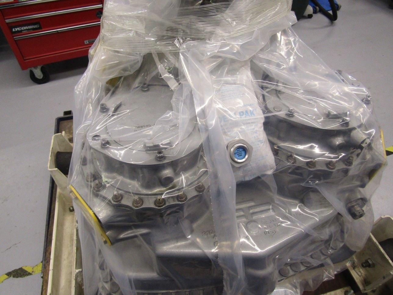

We store aircraft turbine engines frequently and the manuals prescribe the procedure for long term.
Usually involves using preservative oil in the fuel and oil system but I dont think you would have to go that far.
We pack the engine with several bags of dessicant (ULINE) and slip a plastic envelope over it and then suck it down with vacuum and seal. We install a humidity indicator and if it gets above a certain point we open and dry out or replace the dessicant and seal it back up.
What ur seeing is a gearbox we did

GSTX that is brilliant and actually fairly easy to diy. I have a couple of plastic box things w/ dissicant in them meant for gun safes. They have 5 little indicators on the outside. When the change colors it is time to plug into an outlet for 12 hrs to dry them out again. This is similar.
SnapSafe Rechargeable Gun Safe Dehumidifier - Large (gunmagwarehouse.com)
