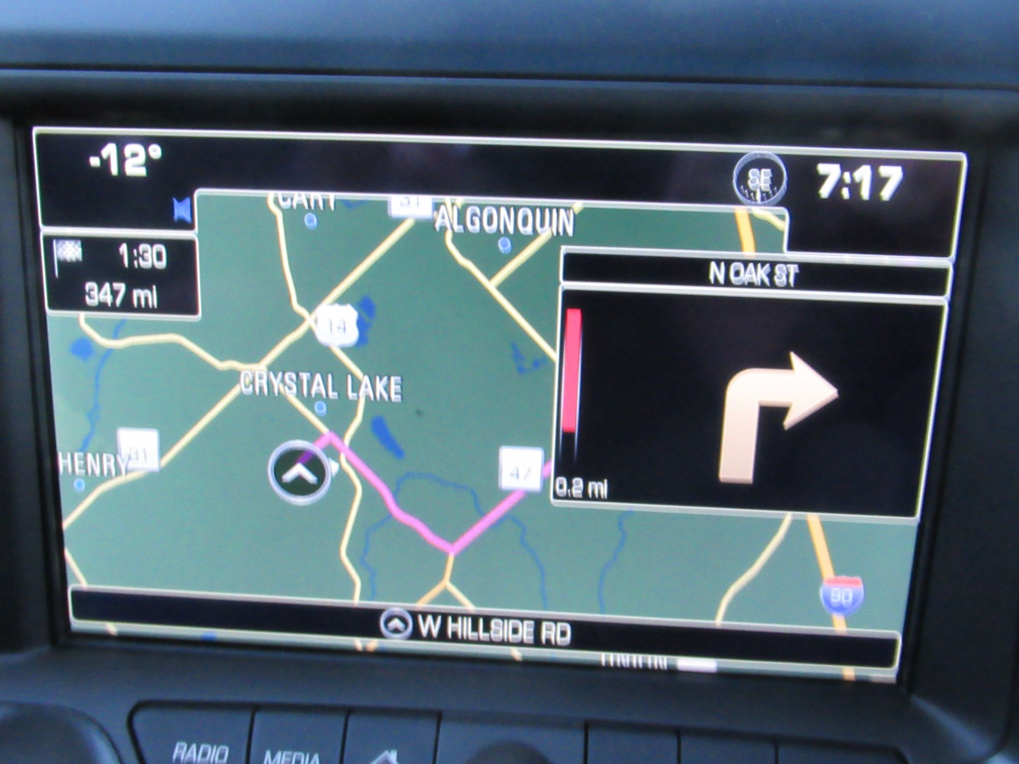

As you probably know, GM & Michelin tell us not to drive or even move the car below 20'F if you have the Pilot Super Sport tires, which are summer-only. Other summer-only tires may be the same. People sometimes violate that rule with no problems, a few get cracked tires.
The Michelin A/S have no official minimum temperature, and are ok for 2-3" of snow on level terrain. See below.
