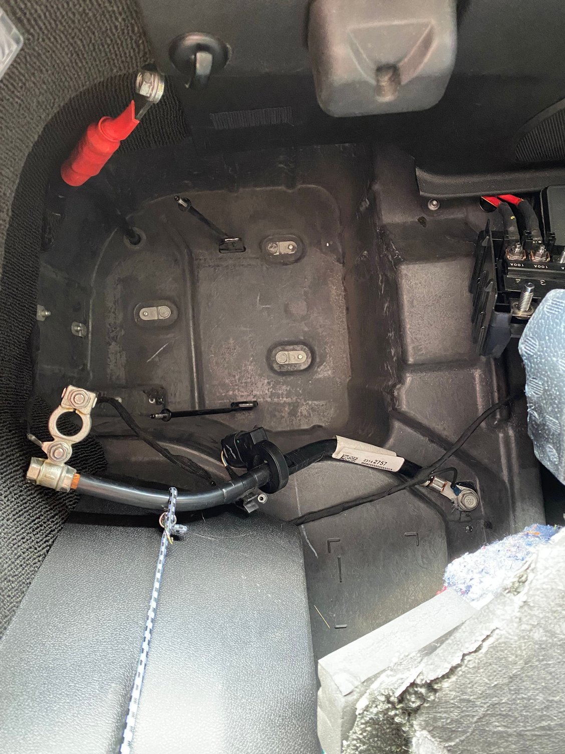

It's easy to replace but you have to be careful with the brittle regulator cable, it can break easy.
The vent tube is nothing special. All inside batteries have those. just swap it to the new battery.

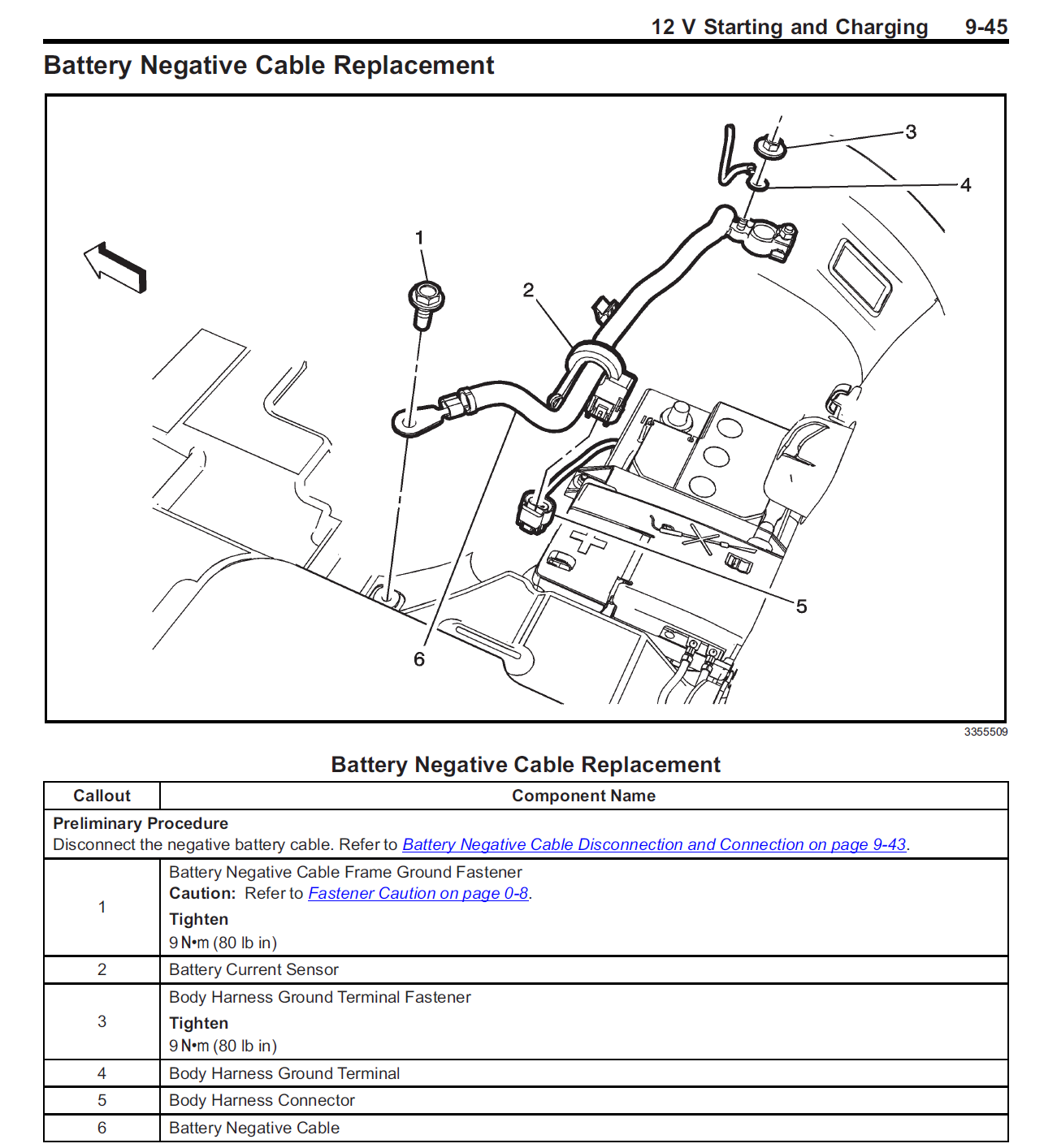

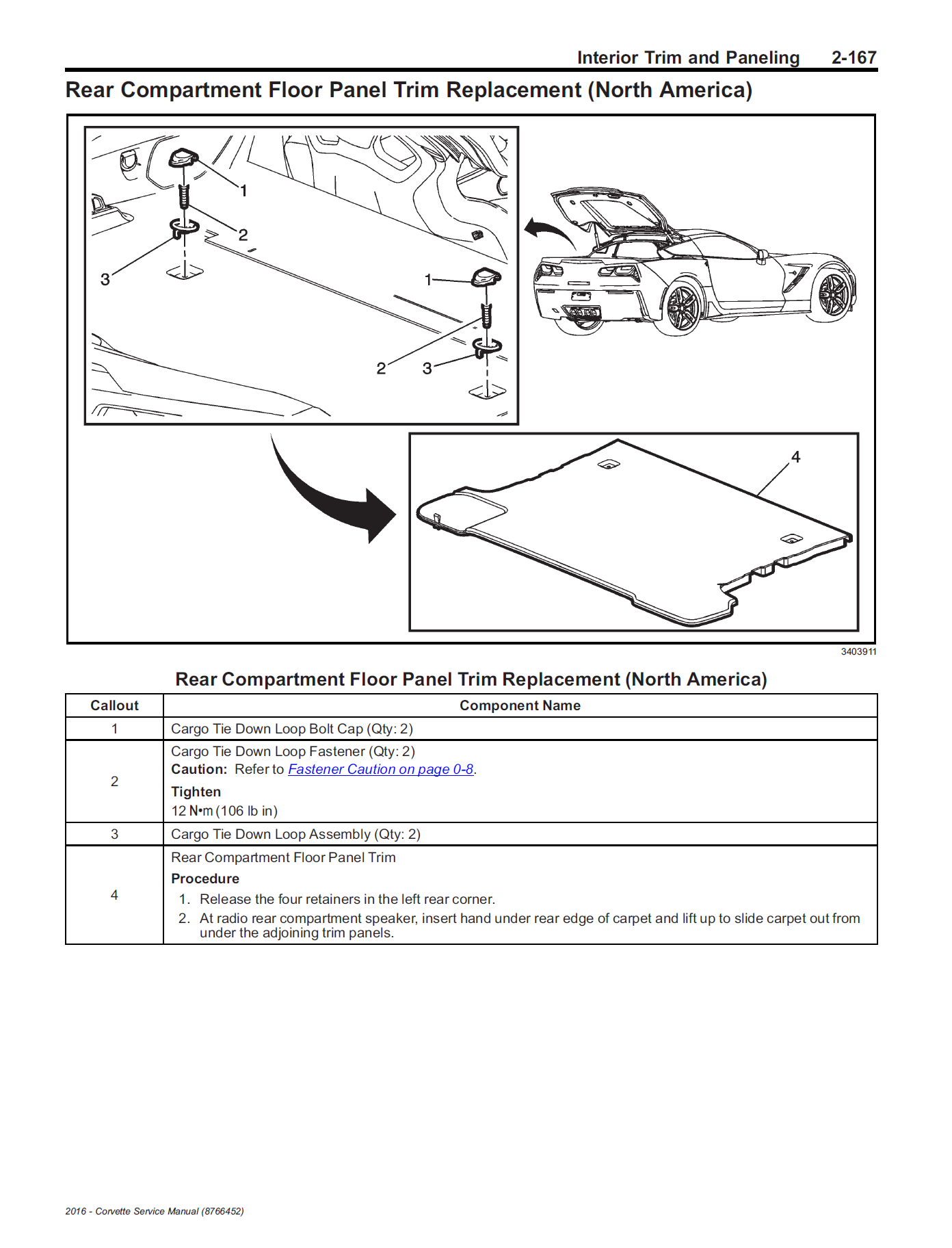

The issue with the C7 is you have to be careful to avoid tearing the carpet when replacing the battery plus the battery is heavy and requires lifting over the rear fascia. It doesn't help a bad back to do that. To avoid tearing the carpet I pull it up at the right rear just enough to grab hold of it and then slide the rear edge forward to remove it from under the rear trim panel, then I move it sideways so it pulls out from under the inside quarter panel. Once it is clear of the panel you can then bend it back to access the battery. If you just bend it back with the carpet still under the quarter panel it will rip right at the corner of the quarter panel. Once you have access to the battery you need to be careful when handling the battery cables as the ground cable has a small gauge battery harness ground cable that is easily broken. If you break it use some similar gauge wire and splice in a couple extra inches to provide some slack.
The official GM way to handle the carpet:
The above diagram shows the easily broken small gauge wire that is attached to the battery ground wire (Item 4).
Hope this provides some help, One of the issues is getting hold of the battery to pull it out and then installing a new one. Some of the replacement batteries come with a strap so you can carry them, drop in and remove them when necessary later. What I found was the GM dealer sold me the AC Delco Gold 42-month battery installed for about $60 more than I could purchase it from O'Reilly's. O'Reilly's refused to install the battery. Since my physical therapy copays are $30 per visit I figured $60 was far cheaper than spending $600 for 10 PT sessions (or having the back surgery I have been putting off for 4 years) after I screwed up my back again while lifting the battery out and into the back of the car.

In short, the battery is a pain in the axx to change. The parts store does not want their clerks trying to find the battery and replace it without damaging the carpet, voltage sensing wire, or hurting their back lifting at a bad angle. It also takes longer than a battery located under the hood.

what i did to lift it out... 2 pair of vice grips, one on each terminal and lift up

The car has a vent tube in it when it came from the factory. You reuse it. Your new battery came with a plug. The new plug can be found on the red cover of the new battery. You just twist it off and plug up the new battery on the side that needs to be plugged.
Here is a picture of the red cover and the plug attached to it on the bottom left corner of the red cover.

Be careful with the little black wire. The dealer broke mine when replacing the battery and I got a warning light on the way home. Rather than return to the dealer, I fixed it myself, and they refunded the installation charge and were very aplogetic.

There really is no difference. All C3 batteries had to be vented as well, however, most batteries at the time didn't have any way to vent hook up the vents (if I remember correctly only AC Delco batteries provided for the vent hookup) so people installed the battery they wanted and didn't worry about the vents, over time most of the vent hookups disappeared from the cars.
