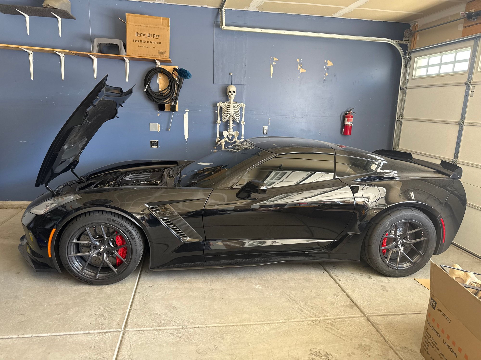

I’m running a Signatures in a 18x10.5 Front and 18x12.5 Rear. They’re All season options, but I am personally running a Michelin PS4 front 285/35/18 and Mickey Thompson Street ET Rear 345/35/18. Front does seem a tad lower, but if you know how to angle your car up slopes etc, you will be ok. Also my car has the Z07 package, no clearance issues with the brakes, might need to static balance unless you shave the plastic connected to the control arms in the front for a dynamic balance like I am about to do.
