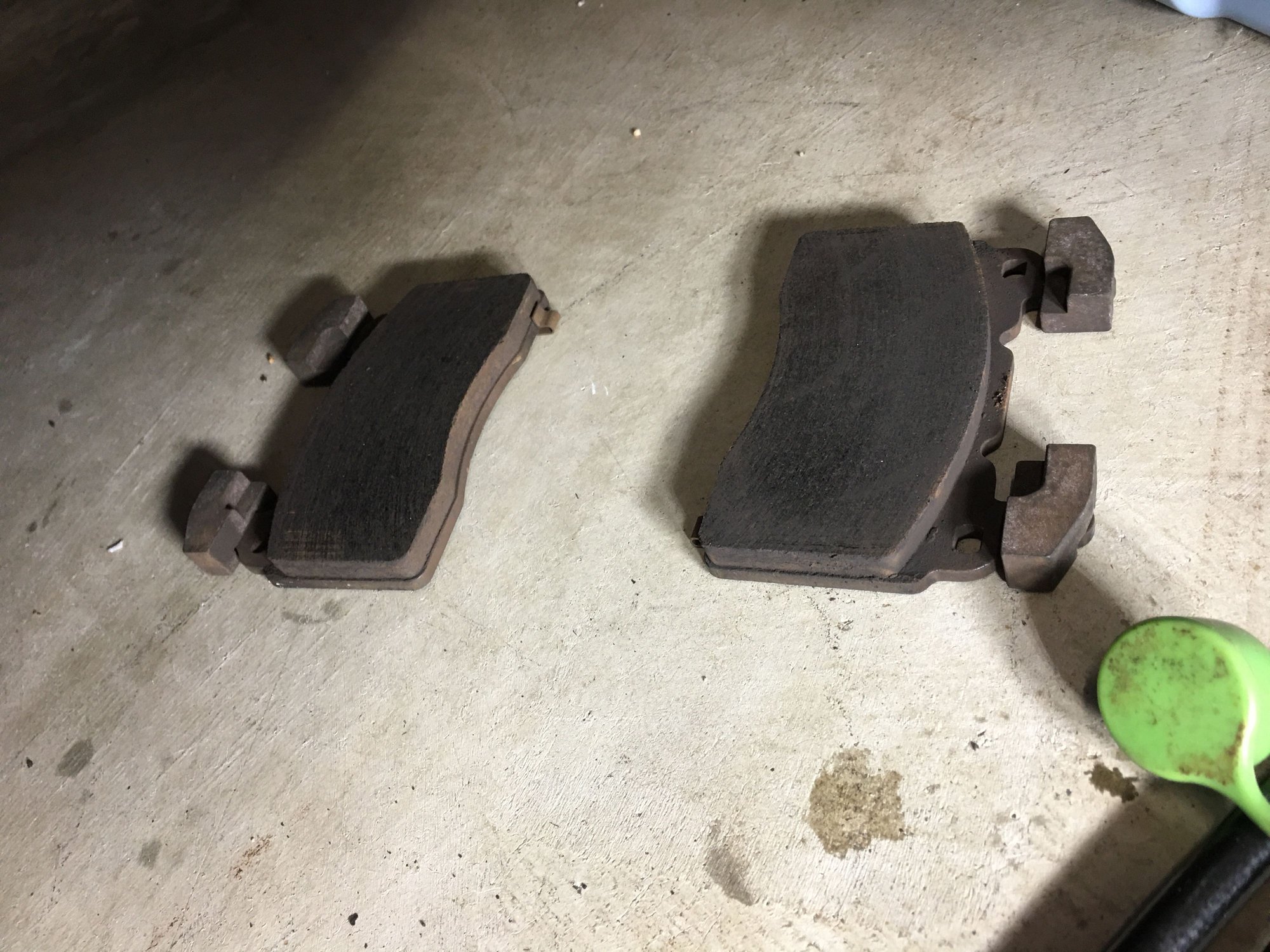

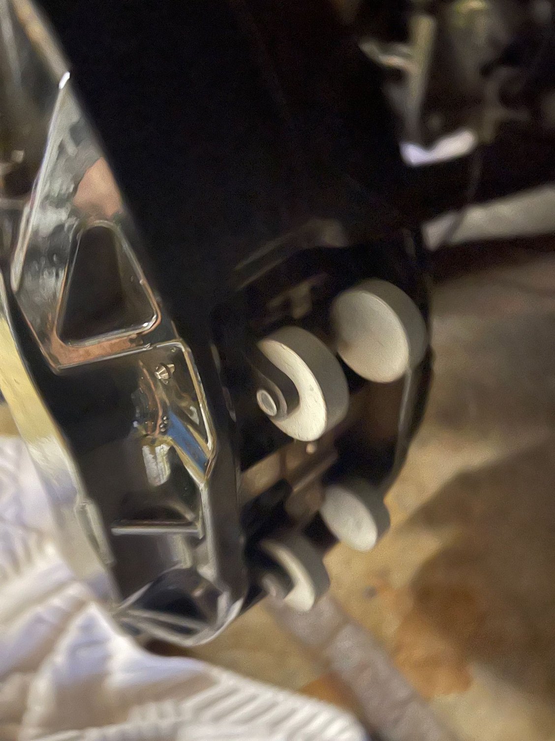

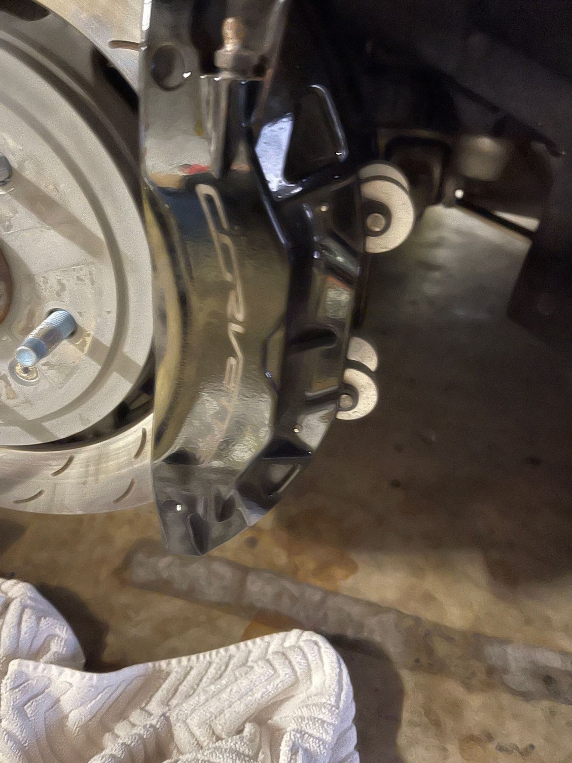

I removed the wheels for the first time to replace the brake fluid on my 2016 C7. I was surprised to see an unusual set of what looked to be like rollers on top of my front brake caliper (pic attached). I'm assuming this is part of the brake pad assembly. I have yet to come across anything like this before. I'm assuming it is some type of aftermarket brake assembly and not the OEM setup. Anyone familiar with this setup? My car is a base stingray with the Z51 package.

These are the original pads on our 2015 Z51..
I believe the items extending past the top edge of the pads are dust generators.
I replaced those pads with PowerStop Z26 pads which did not have those items, and I no longer had brake dust.

Noise reducing weights. Never knew such a thing existed.

Carryover from the 5th gen Camaro. My factory 1LE SS had those in 2013

I have seen them on Porsche, but first time I have seen them on a Corvette
