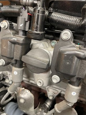

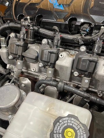

I have my coil covers removed and am wondering what that round cap/cover is on the driver's side in between the two front coils.
TIA, and sorry for my ignorance.

That would be the oil fill for the non-Dry Sump engines. GM used the same valve covers for both.

I should have stated in my post that this is a Grand Sport with the dry sump

Be aware that on a dry sump car, that cap is fixed in place via a locking tab. If you attempt to remove the cap by twisting, you'll break the tab and have it rattling around the top of the cylinder head. It takes a LOT of force to do this......but some very determined members have done this in the past and then regretted it.
