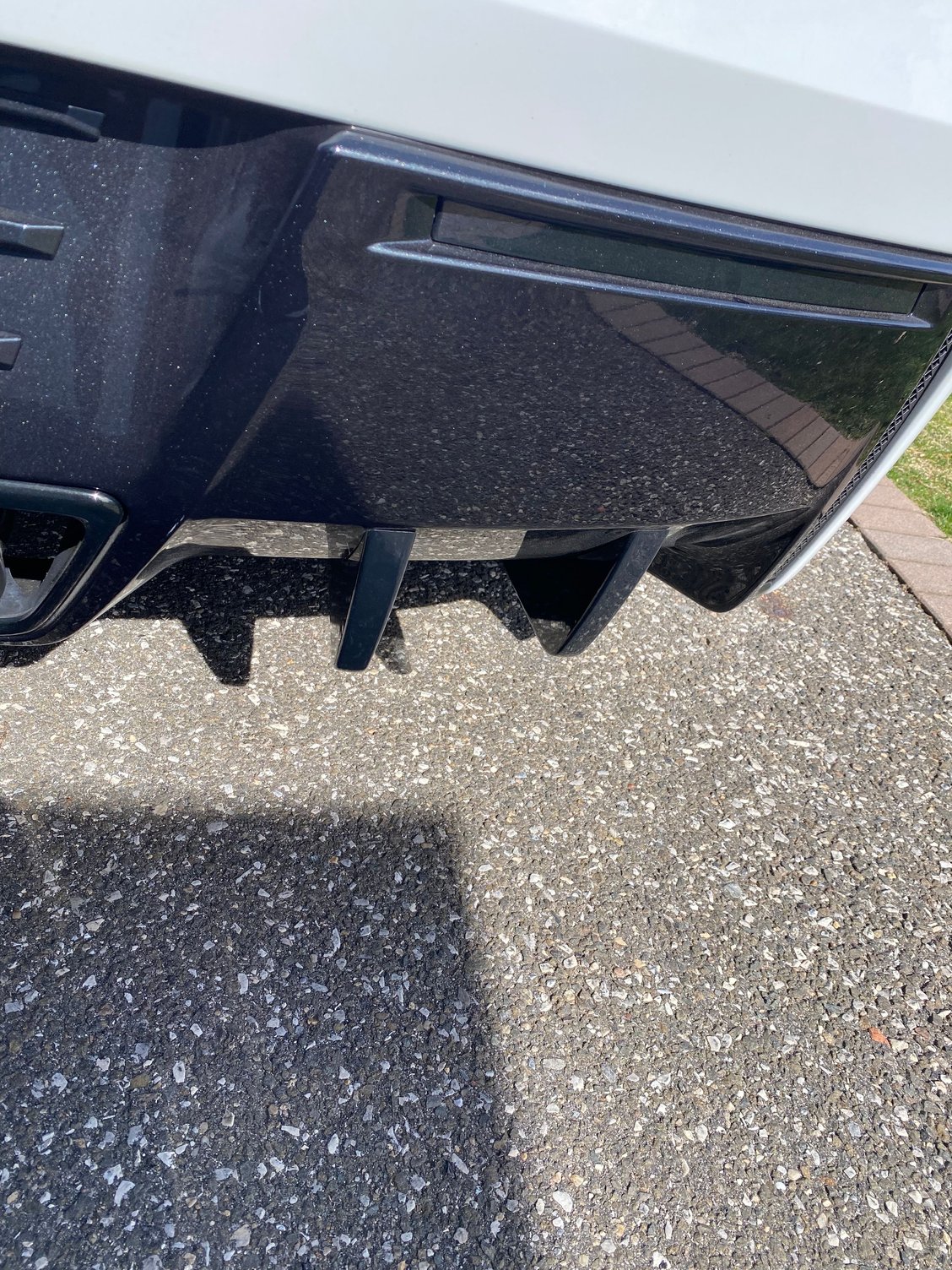

I recently installed EOS diffuser fins, one fin left a gap significant enough to bug me. Has anyone experienced this and come up with a solution. I have heard one person used black Caulking then painted it carbon flash. Has anyone experimented with any solutions.

I have EOS fins. In my case they slowly developed a gap and have shifted position outward a bit. I will eventually re-adjust them and use a different attachment method. Only the lower section of the bumper needs to be removed. It will allow the lower piece to come away, making it easier to reposition with better fasteners. A few steps, but better than the original install method. My OCD will soon demand it!

yeah i was getting exhaust installed so the rear section was removed anyways and that's when i installed them. Gap is annoying to me but no one else will ever notice or care, caulk seems extreme and may look bad.

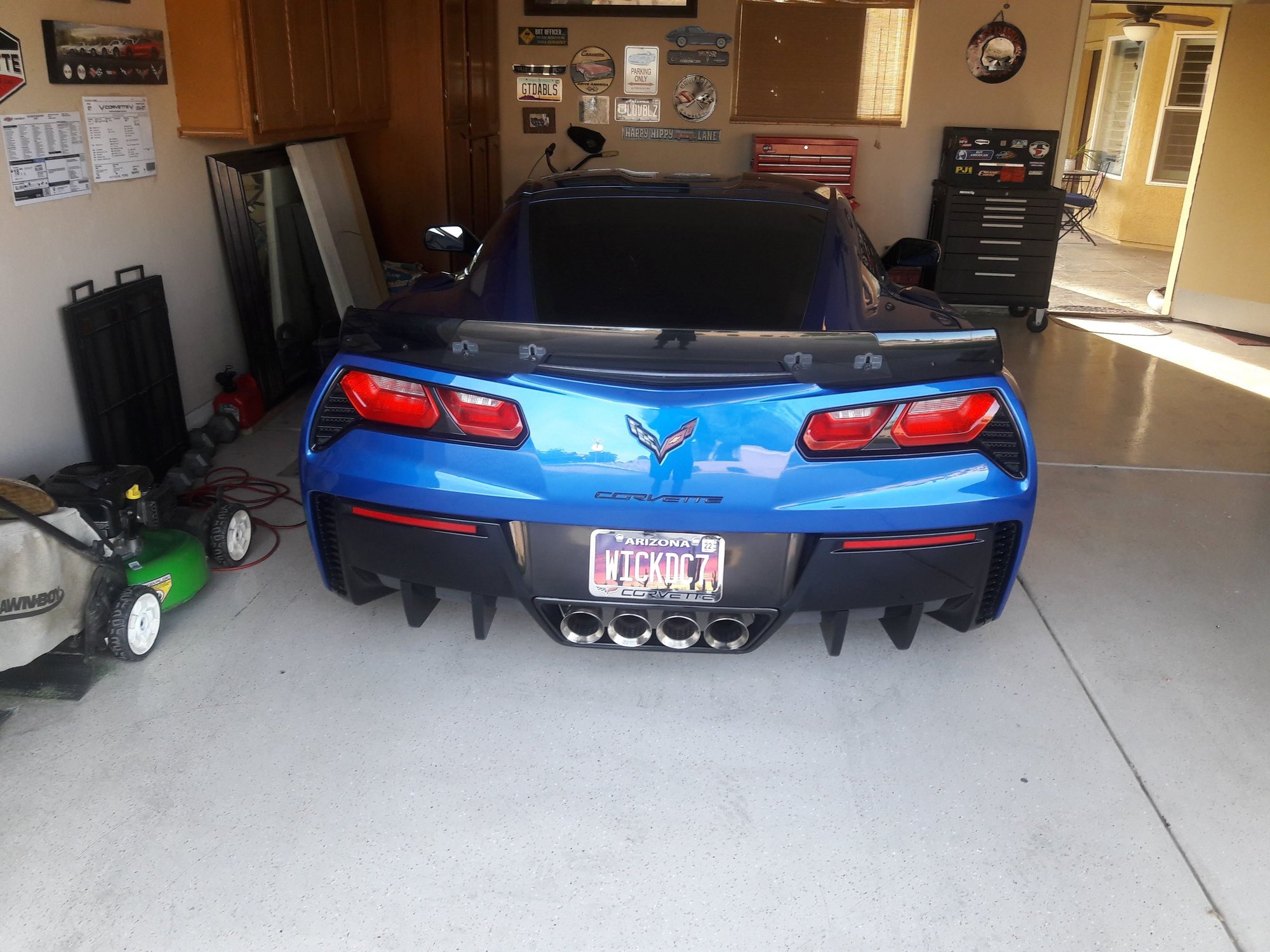

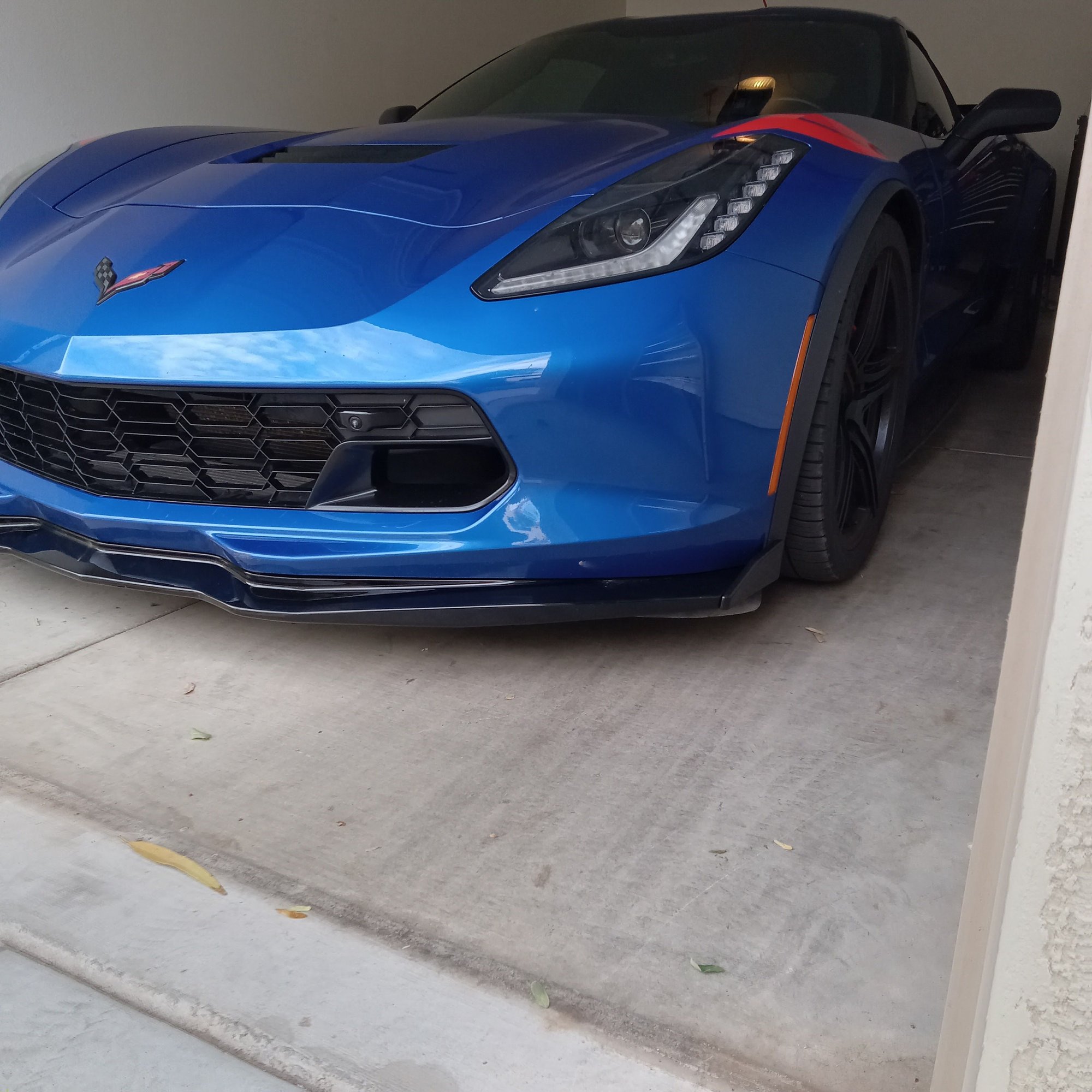

I had the same issue, slight gaps annoyed me. Thought of a way to fix the gaps, but after months of putting it off, it doesn't bother me anymore. You can't see the gaps really from normal distance. l also installed the EOS stage 2 front splitter and the winglets aren't at perfect 90 degrees, but I knew after time I wouldn't care about it, was just happy to swap the poverty splitter with the better looking stage 2. Little things aren't worth the frustration, hammering the gas pedal and keeping the car out of a ditch is what I worry about, lol.
Top of fins have slight gap at top fit.
Slight tilt and edge gap

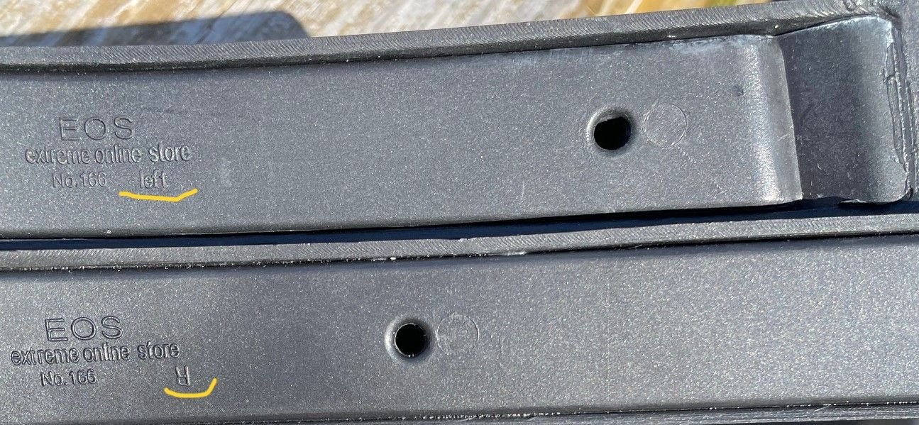

When I received my EOS diffuser fins, with the very first oneI pulled out of the box, the mounting plate fell off. The other three seemed secure.
It was obvious whick fins are right side vs. left. I thought I would temporarily mount thr right side with that clear, removeable double sided tape.
On th back of the fins, tow were labeled "left" and two, "R".
It was immediately obvious that EOS or their Shineese manufacturers, screwed up.
The "R" is upside down. I have to mount the right ones on the left and vise versa.

I just installed EOS fins and have very little gaps immediately after install. I bought fender washers as well. I also noticed the labels are backwards. I installed an L on the drivers side and it was crooked as hell. Installed the other L on passenger and it looked much better.
