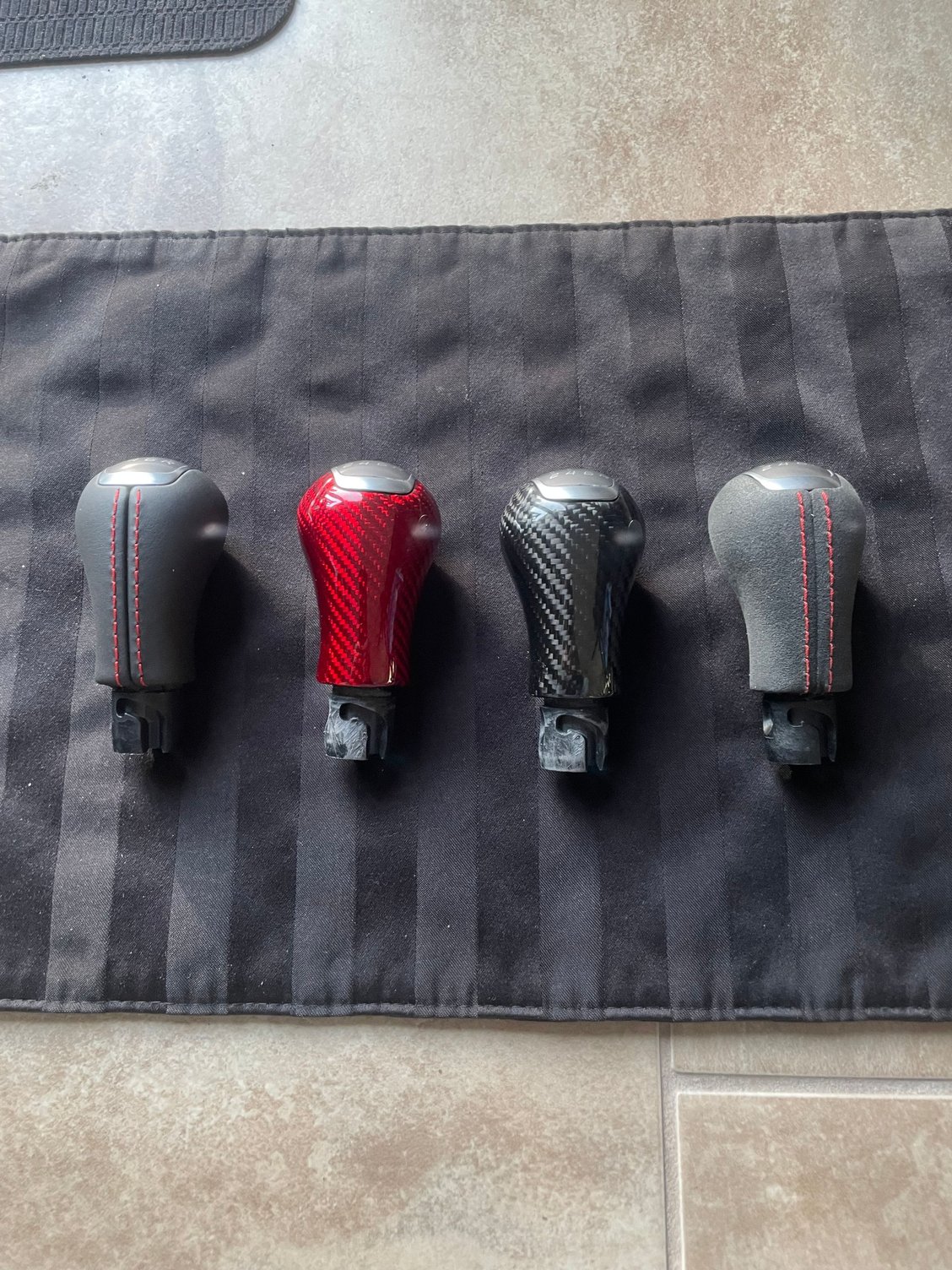

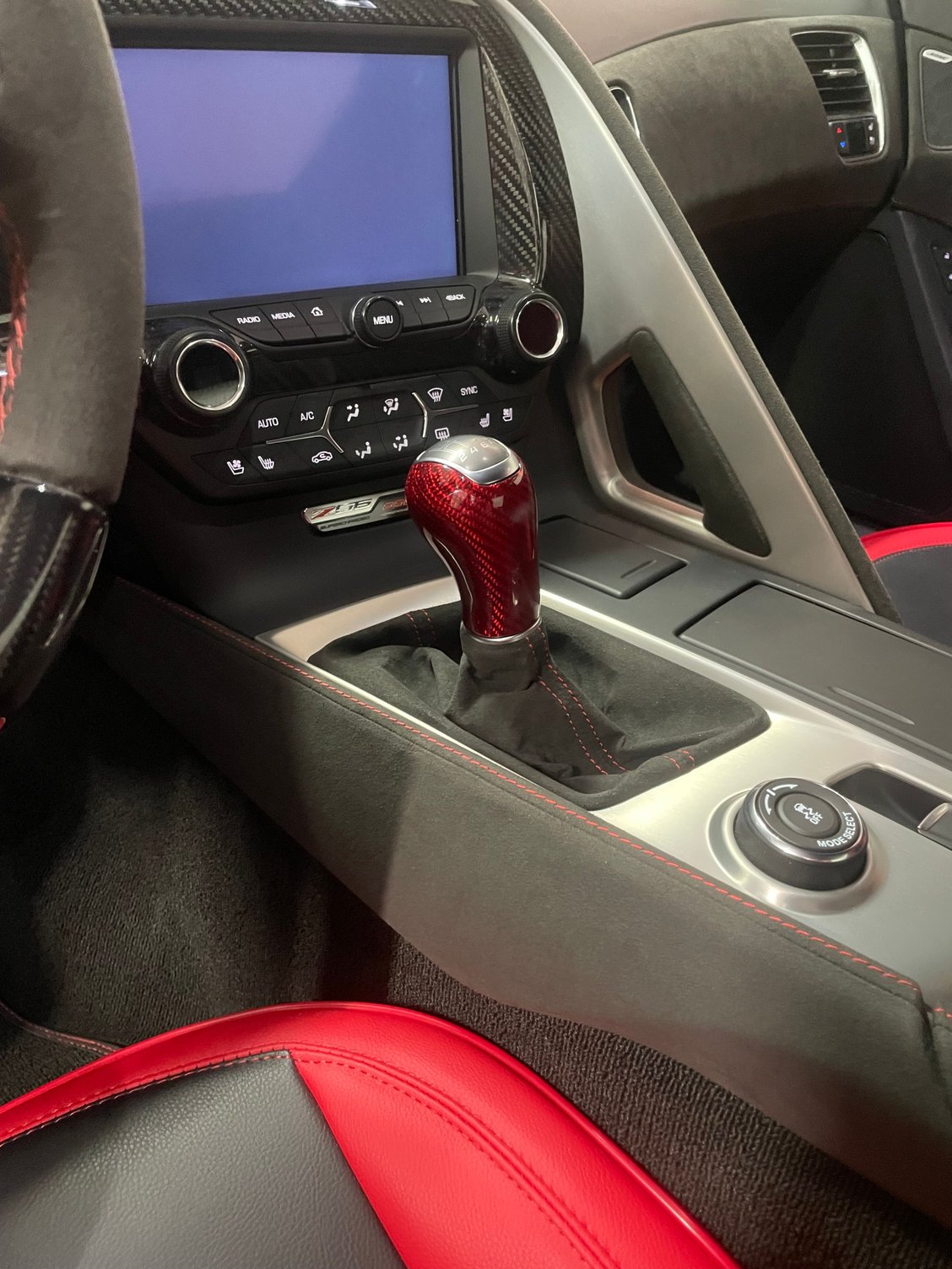

Originally Posted by Flattman
Chose the round shift lever so I could keep stock **** and stock appearance
here’s my OEM Red Carbon Fiber one
Here’s my collection lol

St. Jude Donor '15-'16, '21,'24
Hey Melting. What is the source of your red carbon fiber shift ****? I know you mentioned OEM.
Thank you.

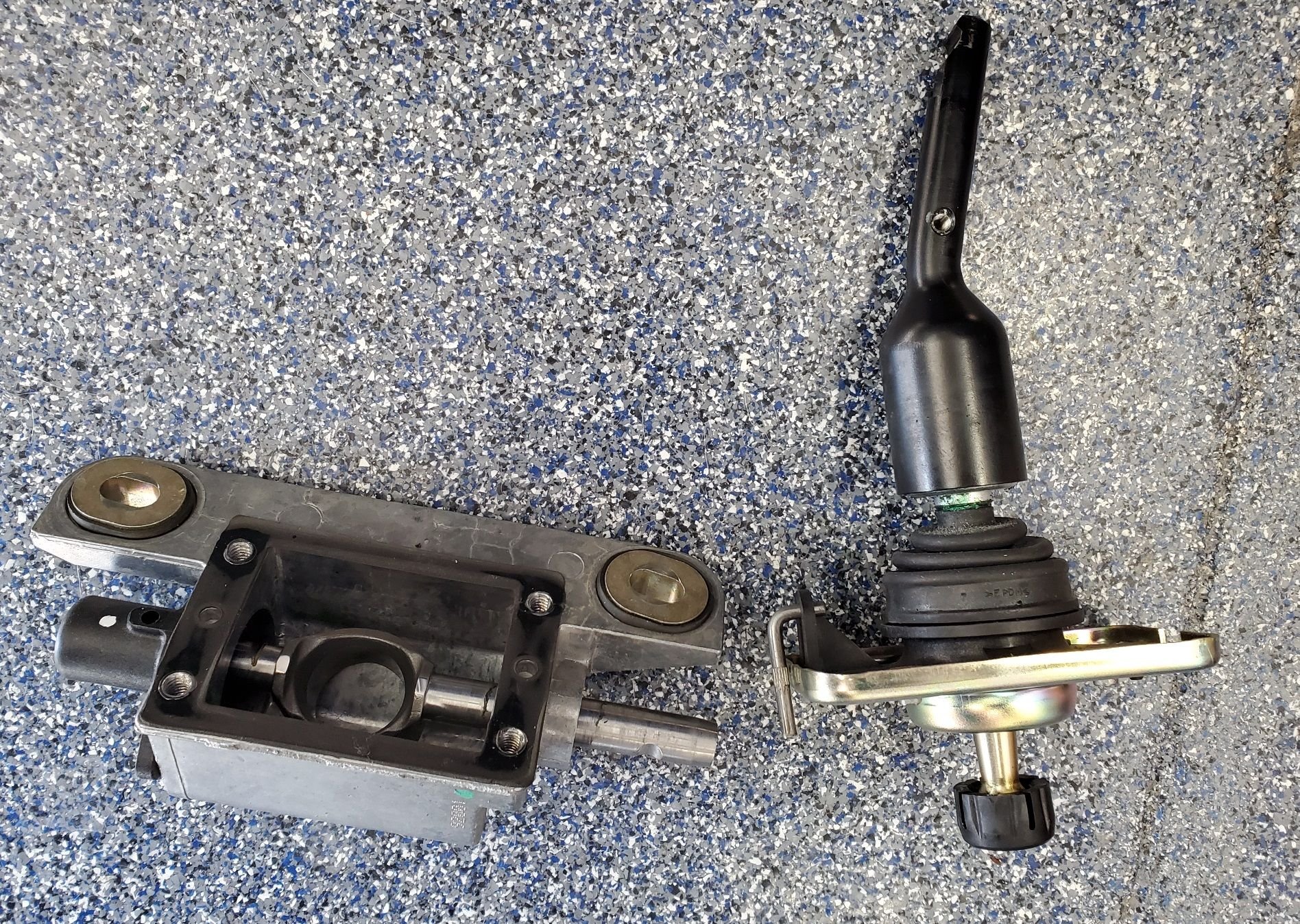

For anyone considering an MGW, here's how it compares to the OEM assembly...
Old Apr 11, 2024 | 04:03 PM
mdolandese's Avatar
mdolandese
Joined: Jan 2018
Posts: 2,801
Likes: 1,137
From: Wauconda Il
Thank you.
I got it from Greg at Autodynamicswest .
