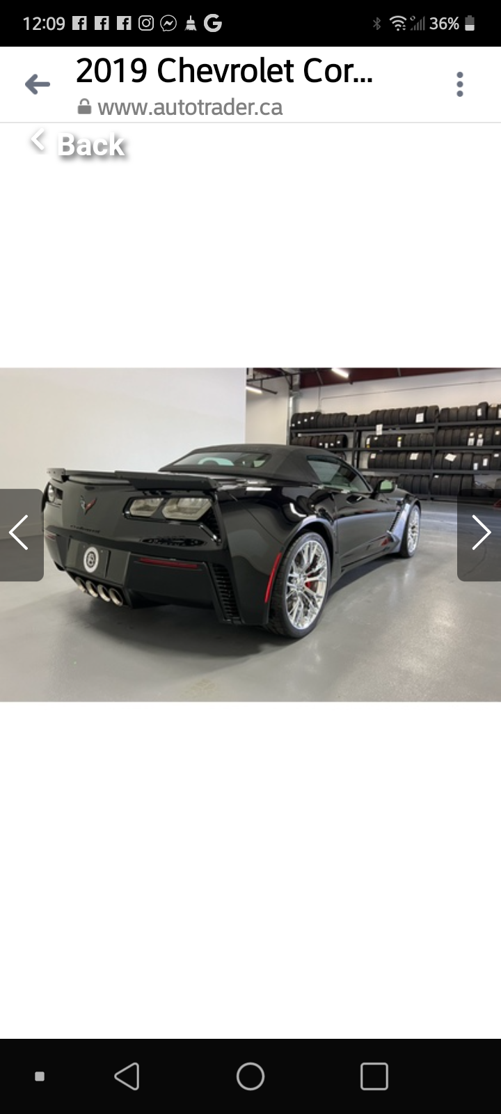

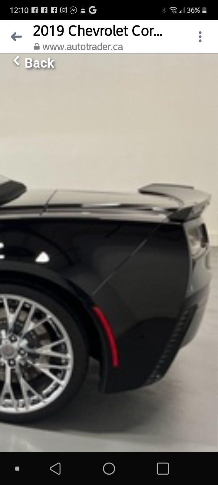

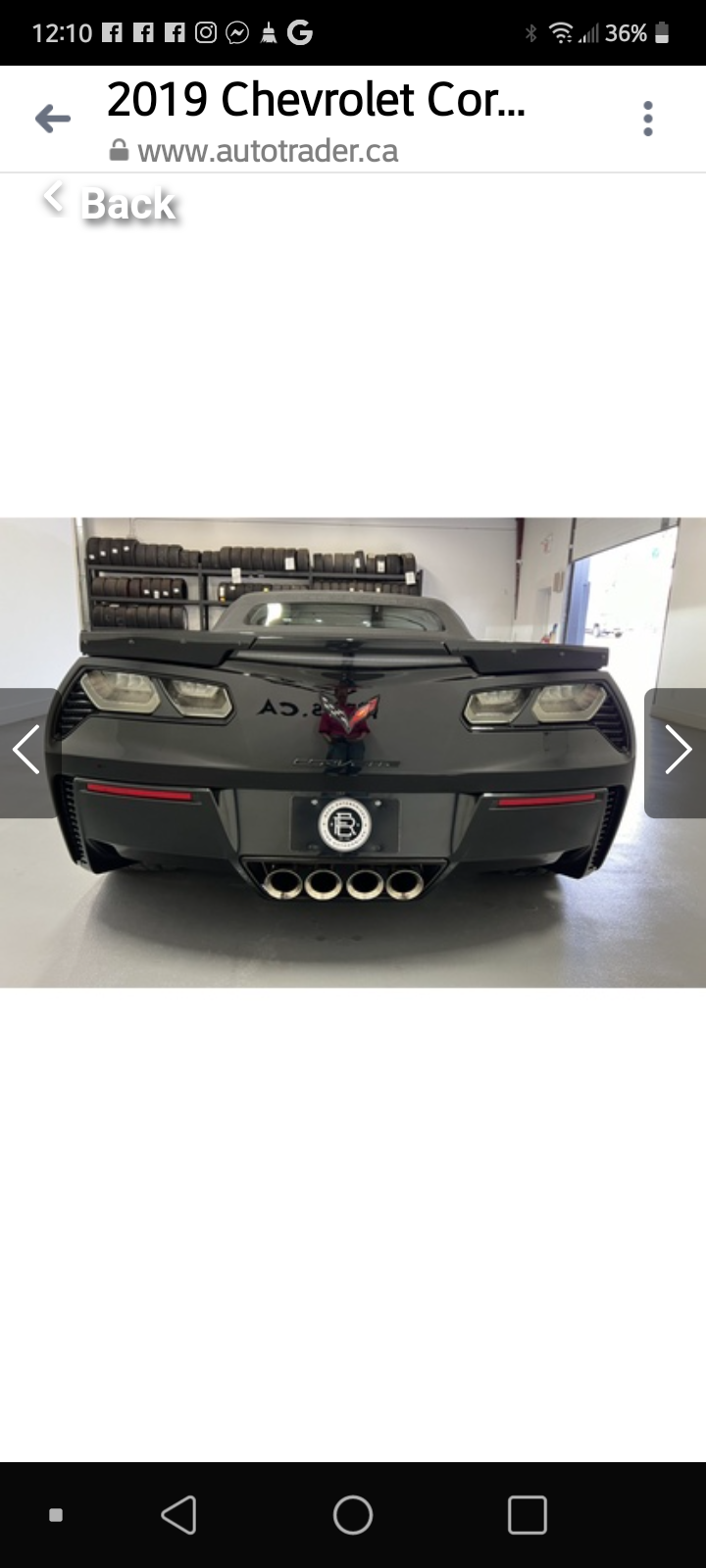

Is this an OEM Spoiler?

Looks like a Stage 1 spoiler from a GS/Z06.

That appears to be the stock Z51 spoiler.

Stock z06 spoiler with stage 1 winglets. You can stay with stage 1 or unbolt, use fishing line to cut through the 3m tape, then install the stage2 taller winglets. Spoiler stays, only the winglets will need to be changed out.
That car is also missing the side rocker extensions. Not sure why they weren't installed. Some 2015s never came with the aero, but the later ones all did.
