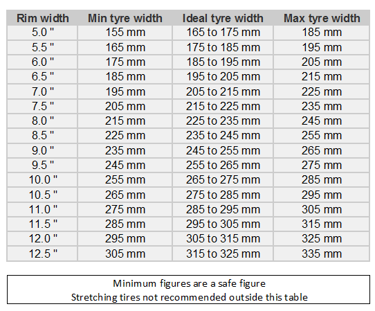

Hi everyone. I have a 2014 Stingray 3LT and it’s 100% stock. I’m looking to upgrade the tires and rims, so I was wondering if anyone knows the max wheel size that will fit a base stingray? Thanks in advance.

20x11 rear
19x9.5 front
safely without issues

And, this...
