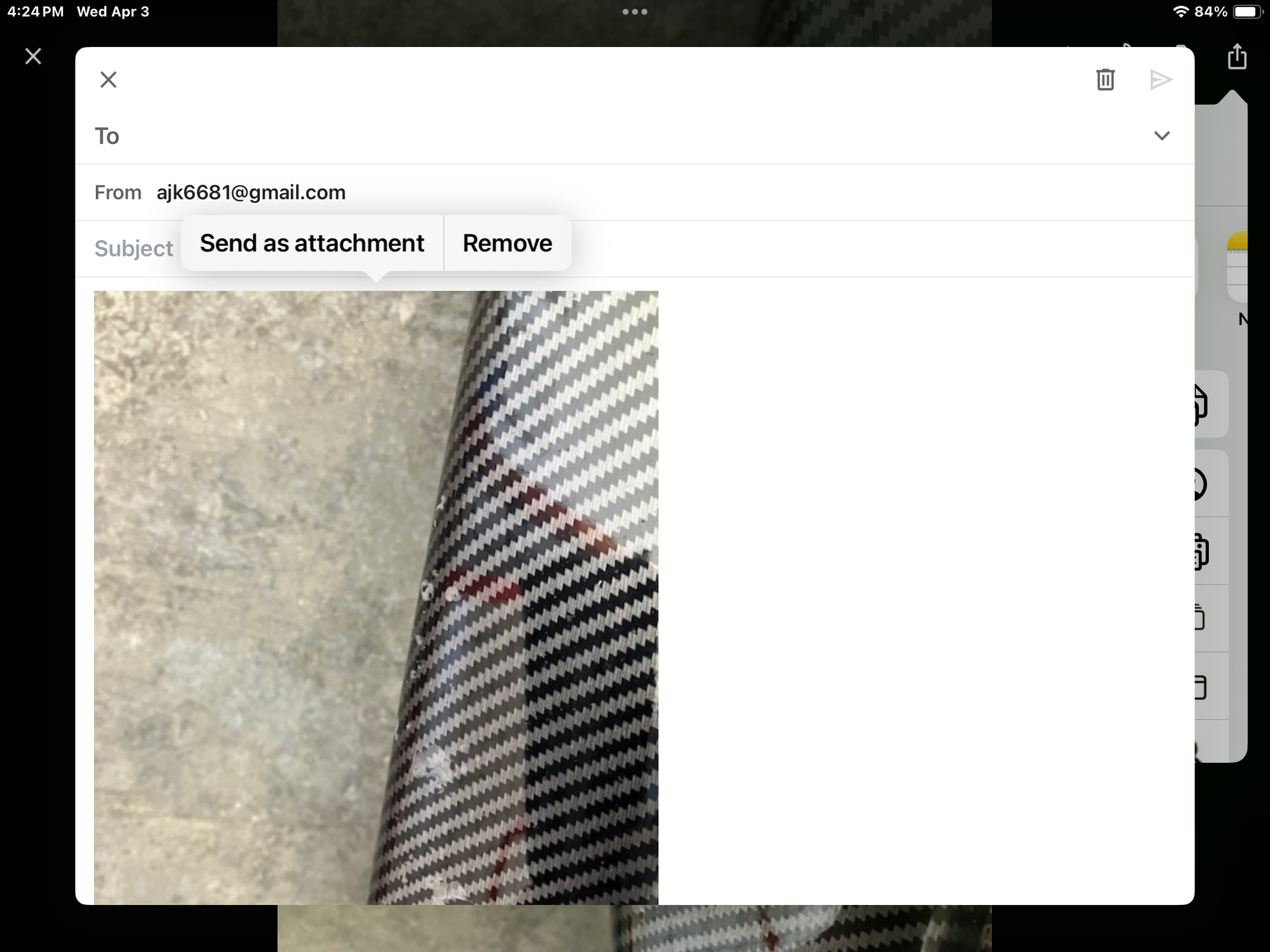

Hi
can l paint this and what kind of paint could l use?
l would paint only black

I would just paint it carbon flash black oem GM color or maybe have it vinyl wrapped.. you'll never match the hydro decal exactly

Hydro decal is when the item is dipped in hydro paint in Carbon Fiber pattern rather than being made out of real Carbon Fiber which is a lot more expensive.
My suggestion is like above: either scuff it and paint it Carbon Flash or, if you want to stay with the Carbon Fiber look, have it wrapped with a Carbon Fiber pattern vinyl.

You can paint anything with the proper prep work. Sand it with something like 200 grit, use adhesion promoter, a fillable primer, wetsand it flat then spray your base and clear.

I think it would look good in carbon flash metallic. Just prep it like above and it should turn out very nice.

Splitter

Same problem for 28,000+ C7 owners that actually drive the Vette vs. sit in Garage and look at. That's why the C8 has a memory "Lifter" that lifts the front end 2-2 1/2 " (I think) to avoid curbs/speed bumps etc. I've gone through (3) splitters in (7) years, and I'm a 66 yo careful driver. **** happens. When I have a couple dents and scratches, I get a new one.
Yours looks like Real Carbon Fiber to me, but what does it look like underneath? I have (3) splitters in my barn. (2) OE Carbon Flash and (1) Carbon Fiber. All need fill and paint. Anyone want them? $ 150. each, you PUP. In 15-25 years these OE and OE sized spitters will sell for $ 650. each. Sand, fill, sand, pain, clearcoat, Done. It's new. Think about the width, length, and so many angles that have to be matched.

Epoxy or reclear. No need to ruin it with paint.

You can eat ice cream for breakfast. You can do whatever you want. But if I were you, I'd sand it down before painting it.
