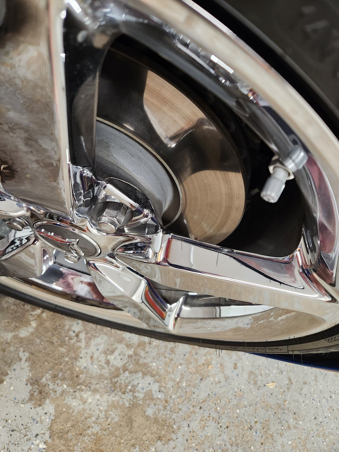

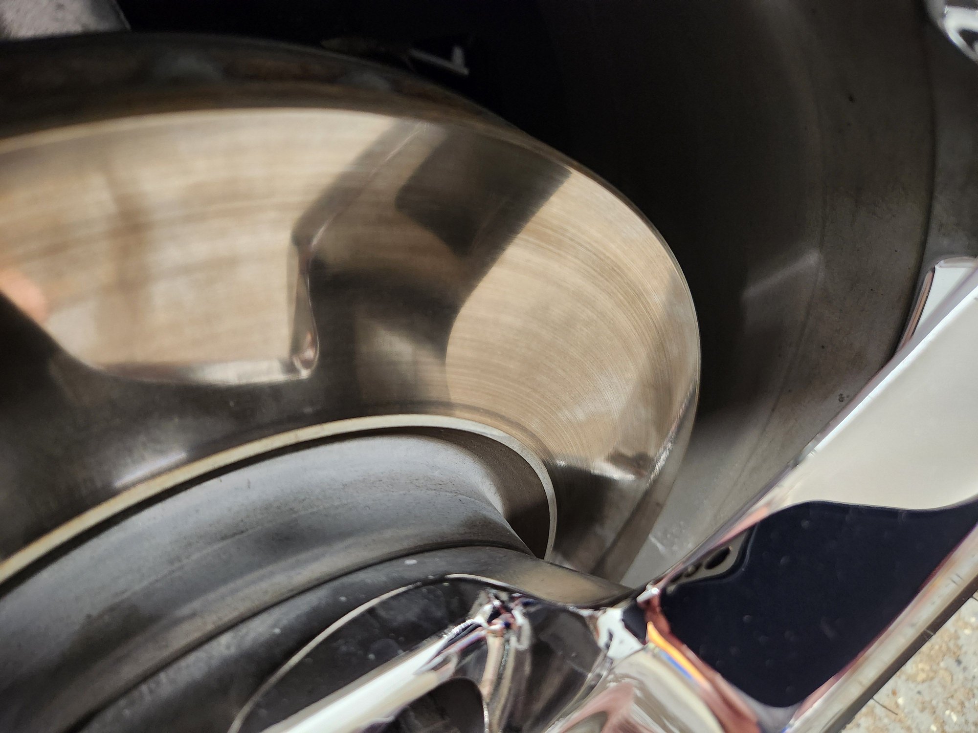

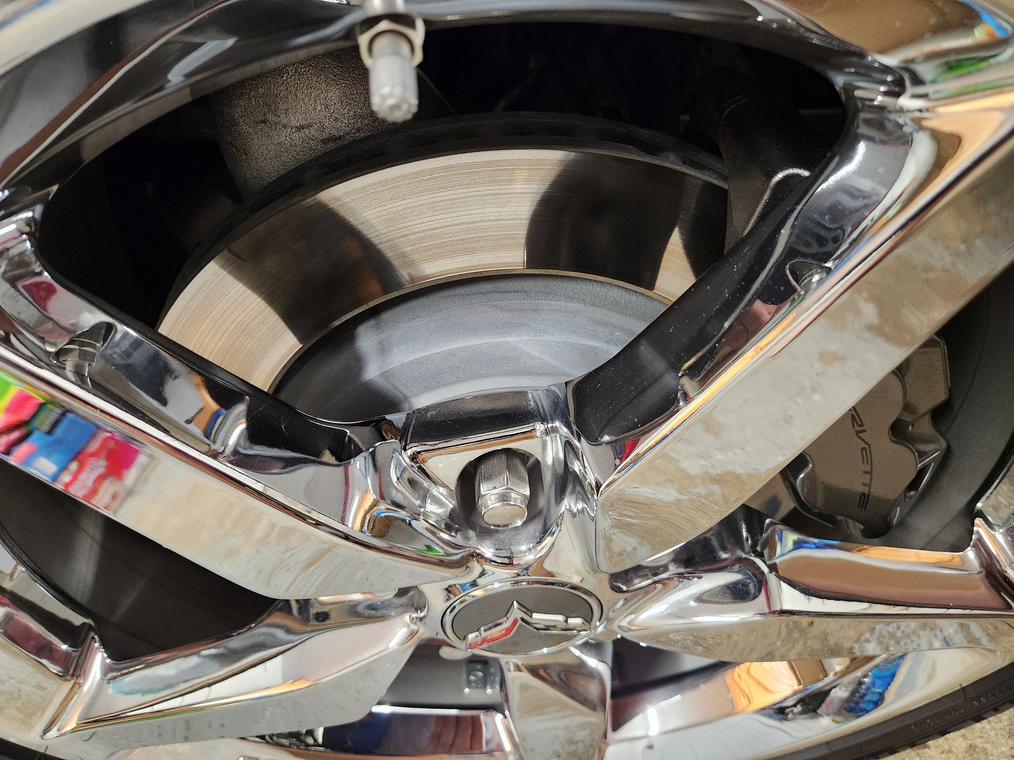

2014 with 20k. In reverse the brakes squeak as loud as anything I've heard. Going forward no sound whatsoever. Plenty of meat still on the pads.
Swap the pads?? I did notice the rotors about look like mirrors...

Your rotors look fine. You can try putting anti-squeal grease on the back of the pads, but that might not be the answer. I had this same issue with my Porsche Cayman S a couple of years ago. Backing out of the garage would bring the loudest, most embarrassing squeal you've ever heard (nothing wrong when traveling forward). I tried everything from lubing the backs of the pads to taking everything apart and lubing the pin sliders, cleaning calipers, etc. Finally, I resorted to a new set of pads with a different compound. Issue solved.
