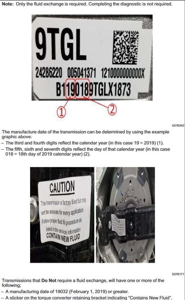

C7's make after February had the correct fluid already... what's your build date ....

Mine was 9/18, I had seen a couple different dates but I think you are correct that 2/19 was the date of new fluid, I can only assume since there was no recall or anything sent to owners and if the owners of my car did not complain to the dealer about shudder it would not have been done, also if they weren’t part of any forums or social places that talked about it again probably did not get it done

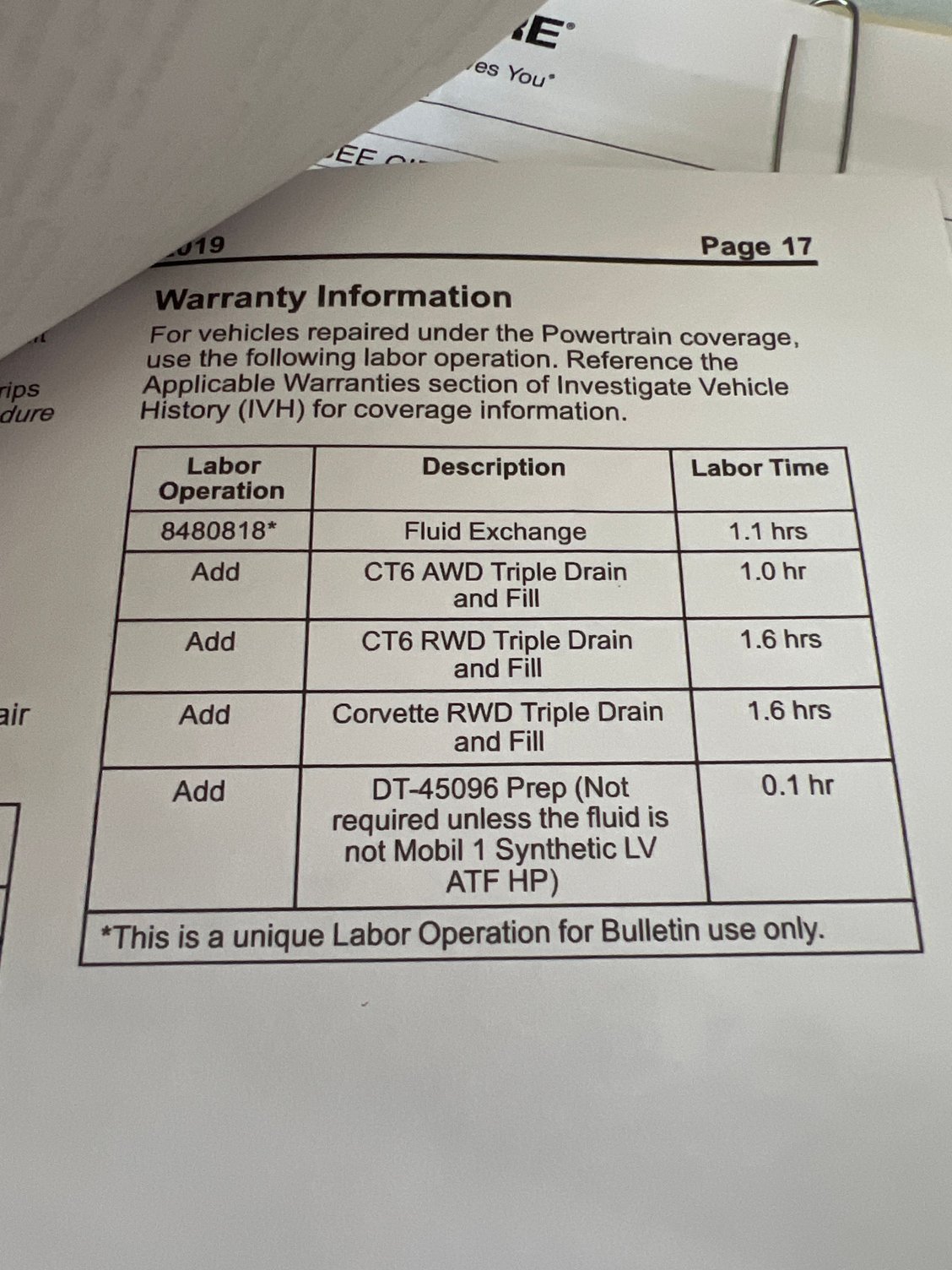

2 different processes, 2 different prices. Kinda like saying it costs less to paint 1 room than the whole house. Considering that GM will pay for 3.8 hours and 24 quarts of fluid, you will pay for AT LEAST that. I would prefer not to go to the transmission place since they don't know the process but since you already have the correct fluid, you can settle for either or. Just be sure to get the quote so you can see what the labor, labor rate and fluid cost is to do the job. My suggestion is to get to know your Corvette certified tech and not rely on the shop. This is as good as any job to get to meet the guy. There are only a couple at any given shop. Watch the guy work and see if he slops things together or he is detail oriented. IF he works well on someone's car, it is more likely he will do the same kind of job on your car. After which, you can use him for bigger jobs you don't want to DIY.
Dave
The changeover was for transmissions produced after February 2019. There is a tag on the transmission that shows the build date.

I guess that is why I balk at the 1300 the tsb shows a little less than 3 hours and then even at gm price fluid should not be over $350 since I am at 40k miles I was going to have them swap out filer as well so with a 3 hour job and parts associated 1300 seems like a stretch , I am fine with 600 to 700 but I would like ti see justification of that price, the dealer that is quoting 600 was just going off of the tsb, the $1300 dealer said yea we know what it is and price is 1300, this is also the same dealer who told me it was 350 for fluid change or 1500 for fluid and filter because they had to drop exhaust, we all know that is generally not the case
i would also like to know where the word “flush” gets associated with this service, even the gm tsb calls it a “triple drain and fill” I get criticized in the forum being skeptical of what is being done by the dealers as I see nothing more than draining the fluid and filling it back up 3 times,

My bad. I thought it was 3.8 when it was 2.8. Do remember that's what warranty pays for the job which is often less than what you pay. Multiply the labor rate by 3 and parts counter fluid cost by 24 and that's an appropriate approximate of the job. I don't go by number alone. I go with the parts and labor quotes. I would not expect more than 4 hours of labor if warranty pays 2.8 hours.
I go with a breakdown so I know how many hours he plans to spend. Also I have heard of vast differences in the labor rate.
I also would speak to the tech and not the secretary making the appointment.

Here is the Triple Flush procedure. Page 15 is where the procedure begins for the Corvette, TSB-18-NA-355.
File Type: pdf
