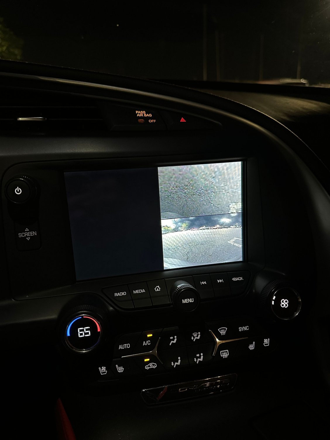

Hi,
I have a 2016 Z51 that was involved in a crash about 3 years ago. Before the crash, I always remember there being a top view camera on the left hand side of the screen when parking. Ever since then, it has ceased to function. Any ideas where to start troubleshooting?
Thanks!

Parking cameras (2) were added in 2016 2/3LT. Definitely not on the 2014's. Cameras are in the grille.

Never saw it and I have a 2019.
There are 3 cameras used.....front left, front right, and rear. The cameras at the top of the windshield are for the PDR if so equipped.
I'd start by figuring out if the driver's side camera is installed, connected, and working.

So just double checked on mine. Your left front camera is likely not connected or it's failed. The shot from above is a composite of the left and right cameras

I agree it looks like the front left

Interpreting the manual:
The bottom left of the display is the left front camera. The bottom right of the display is the right front camera. The top display is a panoramic view made by combining the left and right front cameras.
