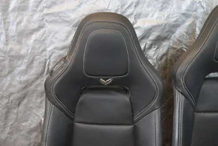

I all I’m from the C5 forum I’ve found these seats from a 2018 that I’d like to fit on my 03 Z06 can someone help me on identifying if they are base or optional also the seller have no idea if they are heated or ventilated. TIA

Those are the standard base seats. I'm not sure how to tell if they are heated or ventilated.

Base GT seat as mentioned. Have the seller take a pic of the underside to look for a fan used to ventilate the seat bottom. The center section of the seat bottom and the back will be perforated although that may have been true across all seats.....so look for the fan. It'll be in a square black housing ~5 inches per side, give or take.

If the leather is original, this would be a 1LT which is what you need because you can't get heated and cooled seats to work in another gen,
2LT and 3LT or LZ have a flag in the headrest. the one pictured does not.

The heated/cooled seats have perforated leather.
