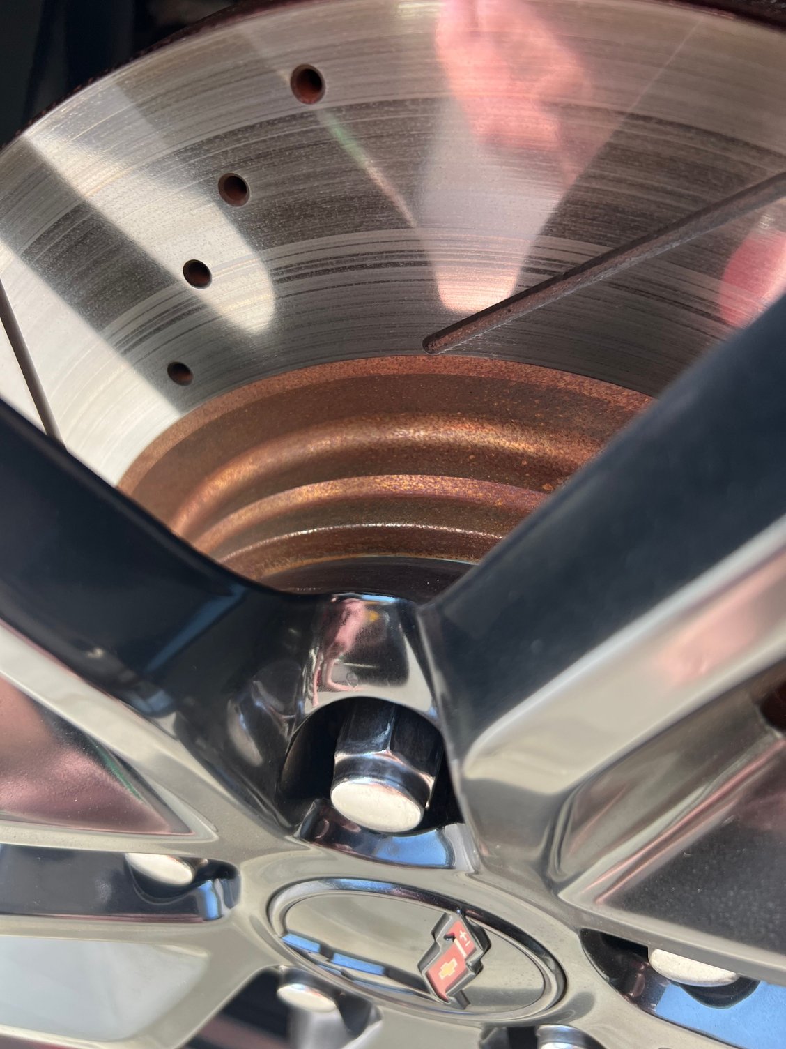

I’m in need of some recommendations based on personal experience please. I will be getting carbon ceramic pads + rotors for my 2017 Z51 A8. I’m not getting Powerstop under any circumstances and in fact I’m returning the ones on the front axle. The hub/hat has turned a brass color. The tech specialist from PS said it’s surface rust because the protective Zinc spray is applied only to the rotor. He told me to sand it off and apply clear coat. My mechanic said their website states both rotor and hat are sprayed so either he lied or he’s ignorant. I surmise the latter. Also my mechanic said the clear coat will not hold up to the high heat generated.
I’ve heard good things about Hawk and Carbotech. I do not track nor race. Some spirited driving with our monthly club runs and that’s about it. What say you please. Here’s a pic of the Powerstops. Thank you.
Powerstop brake hat/hub

I have Carbotech 1521 pads on my OEM Z51 steel rotors. I have used them for nearly 4 years and about 8K miles. I do not track my Vette (not recommended for 1521s). I love love love these pads—they are quiet and free of visible brake dust. They DO leave a slight brassy residue on the rotors which is only an appearance issue and does not bother me. I consider it better than the surface rust that I get with all OEM semi-metallic pads.
As I understand it, the clear lacquer on rotors is only intended to be a temporary manufacturer thing to prevent surface rust during transport and storage. The clear lacquer will quickly wear away with normal braking. Thus, surface rust is completely normal on rotors after being driven in rain or after washing.

Those look like iron rotors, so do not buy "carbon ceramic pads" as you mentioned. Ceramic, Cera-Metallic, Ceramic Kevlar, etc will be fine.

Why are you getting new rotors? Is that all that's wrong with the rotors? If it's just a bit of rust, not a big deal. Clean them, mask them, Paint them with a good high temp paint. Stock OEM pads will be good. Most of the fancy,,, super, duper pads won't work as well.

Is that drilled and slotted rotor stock on Z51s for 2017? On our 2015 Z51, the rotors are slotted only.
Question
Is your distaste for Powerstop based strictly on the discoloring of the center?? I have used them on damn near everything from Jeep to classic GM with C5 brakes with GREAT performance, hence why I am asking
If aesthetics is your only issue, I would try some oil based high zinc high temp paint on the discolored hub area

“Thus, surface rust is completely normal on rotors after being driven in rain or after washing.”
Tho I thank you for the info re the copper brake grease I disagree with your above statement. Both the rotors I replaced and the ones still on the rear axle are the OEM Brembo rotors and neither had/have the surface rust the Powerstop rotors are exhibiting. Our car has been washed numerous times and driven in the rain a few times in the 2.5 years we’ve had our Corvette.
