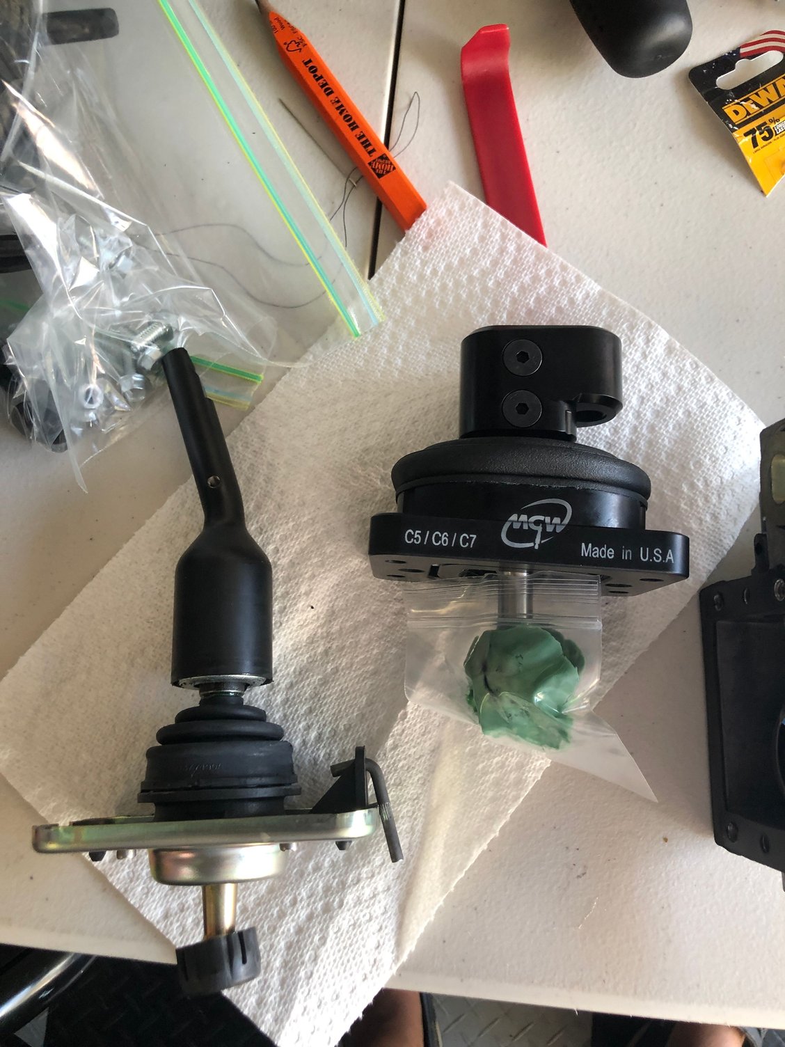

Originally Posted by ray96480
OK, so what's so great about it? Its appearance or what?
Smoother shifting, less shifting travel. Here is a picture comparing OEM (left) with the MGW (right). The OEM version looks and feels cheap, simple stamped steal. On the other hand the MGW looks and feels like a solid piece of machinery. Milled from a solid block of aluminum. I read somewhere that the EOM design dates back to the C5 generation. If I won the lottery and upgraded my 2019 GS to a 2019 ZR1, for sure it would be a manual and upgrading to the MGW shifter would be first on my list to do’s.
