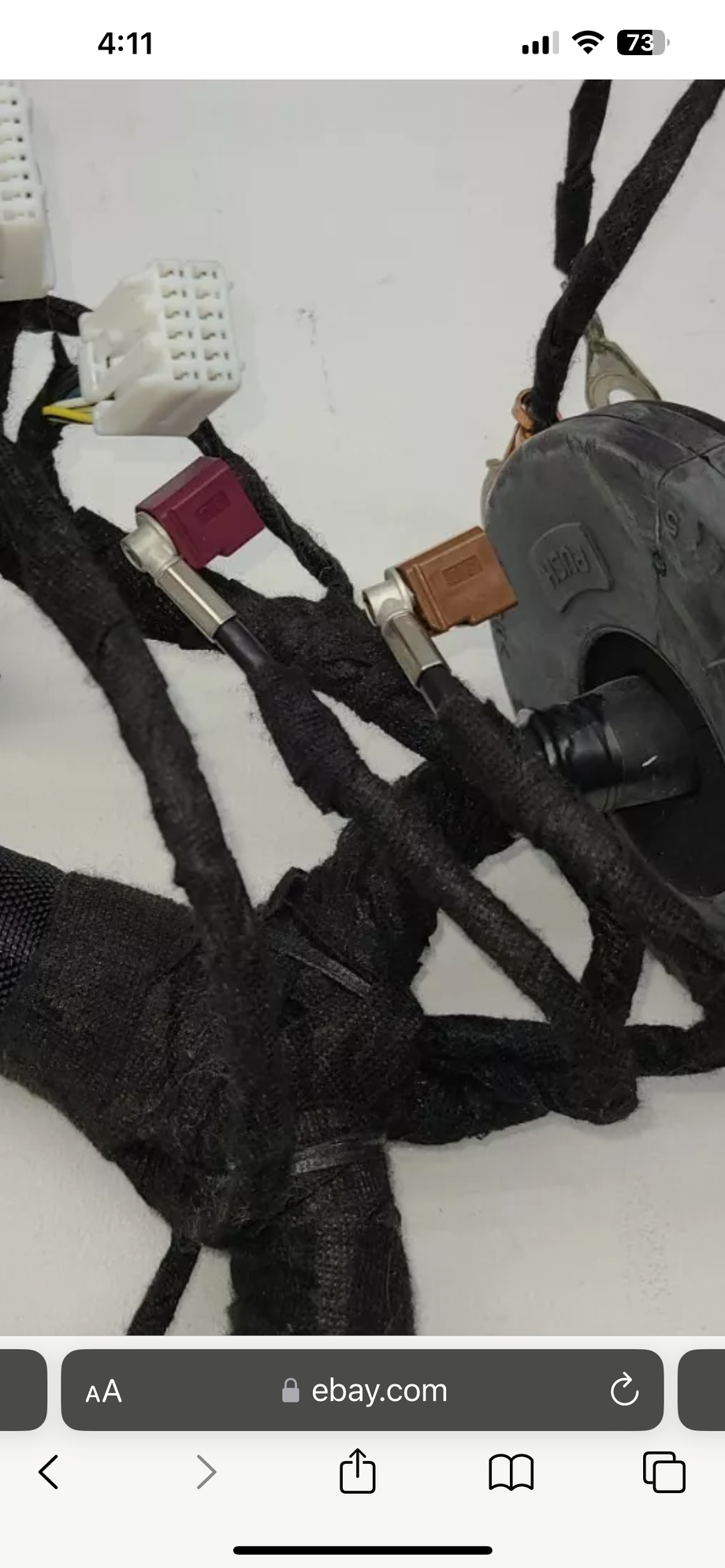

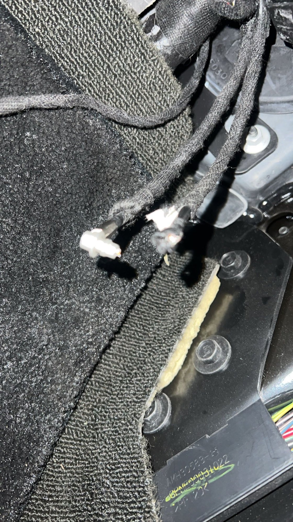

I have a question…
I have a 2016 stingray Z51 i got at auction, The onstar module was missing and replaced by dealer but the Fakra connectors are missing, the wires are still there and the dealer says they have to replace the whole body harness… My microphone doesn’t work and my onstar mirror and navigation as well does anyone know if i could find the connectors themselves and hardwire them to the wires to connect it?

Connectors appear to be available as separate parts.
https://www.pasternack.com/fakra-jac...IaArhSEALw_wcB

Make sure you get the matching colors from Pasternack. The keying is different. Also, please note that a special crimp tool is required.

I am having the same problem. Did you fix it?
