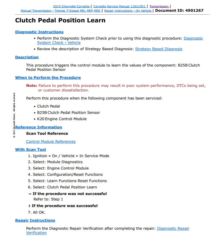

It's usually mounted on the bracket the clutch pedal is attached to. Remove the connector, remove the bolt that secures the switch, call it good. On the Corvette you also have to do a Clutch Pedal Position "relearn" procedure. I'd imagine the Camaro is the same.
Here's a pic I found online. Camaro should be similar...
