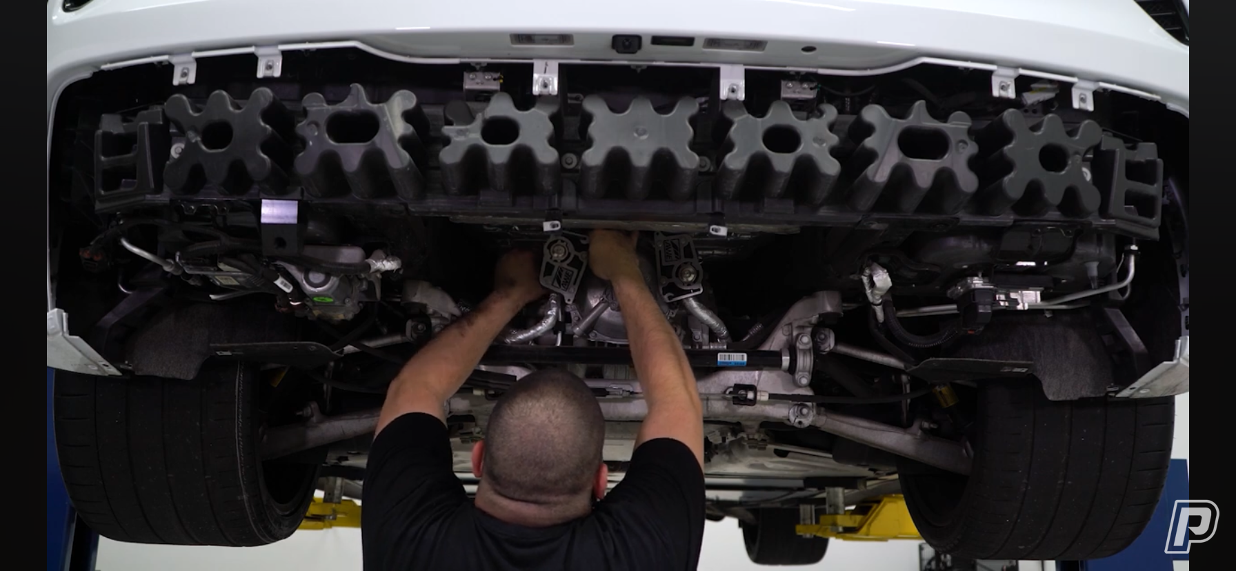

Im planning to install an AWE Touring axle back on my ‘14 Z51 Stingray. I have a quick Jack but am not sure if that will provide the clearance to remove the stock exhaust without cutting it up. I watched an installation video on YouTube and it appears you need a fair amount of clearance to get the exhaust out in one piece. Has anyone out there used a quick Jack to do this? Any guidance will be appreciated! Thanks!

I installed the Billy Boat Fusion axle back with low profile Jacks on 3" of wood under it without issues. I am positive you can do it with the Quick Jack.

The QJ provides about 22" of clearance. Any idea how that compares to your set up?
Thanks!!

Rear wheels were about 7 inches off the ground.

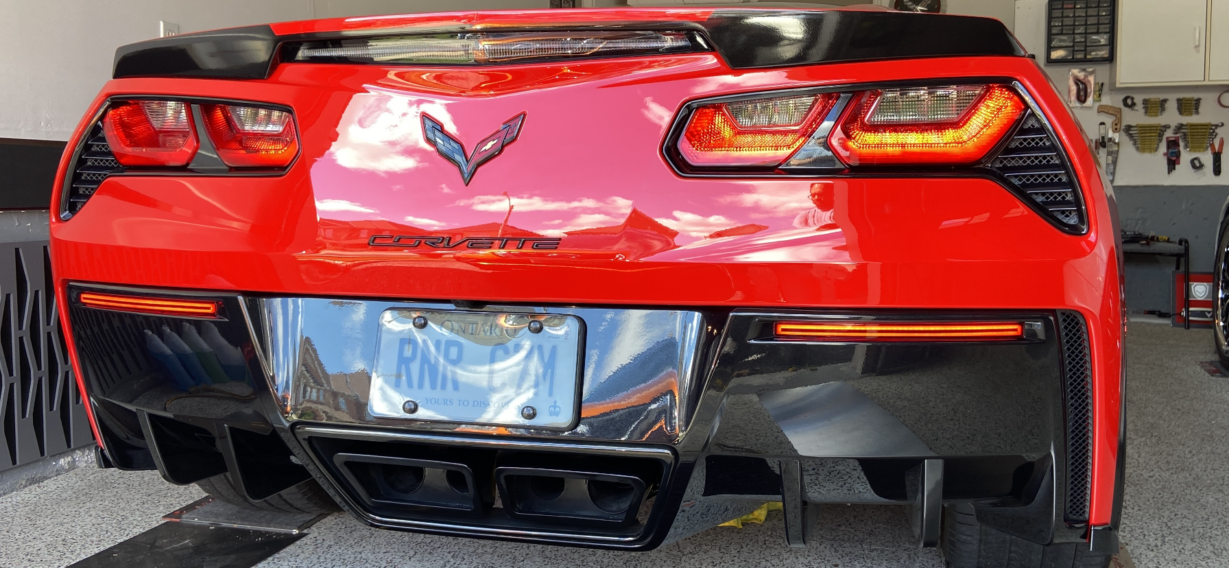

After install.

We just installed an AWE Touring on a C7 - you should be able to get it out with a Quickjack, but it's tight. Worth it though, sounds great

You should have enough clearance with your quick jack. I just installed the AWE track exhaust using only a 8" car ramps. It was tight, but it worked.

Does the rear bumper have to come off?

Yes.

I removed my exhaust today in quickjacks. I only went to the first stops and I had plenty of room.
