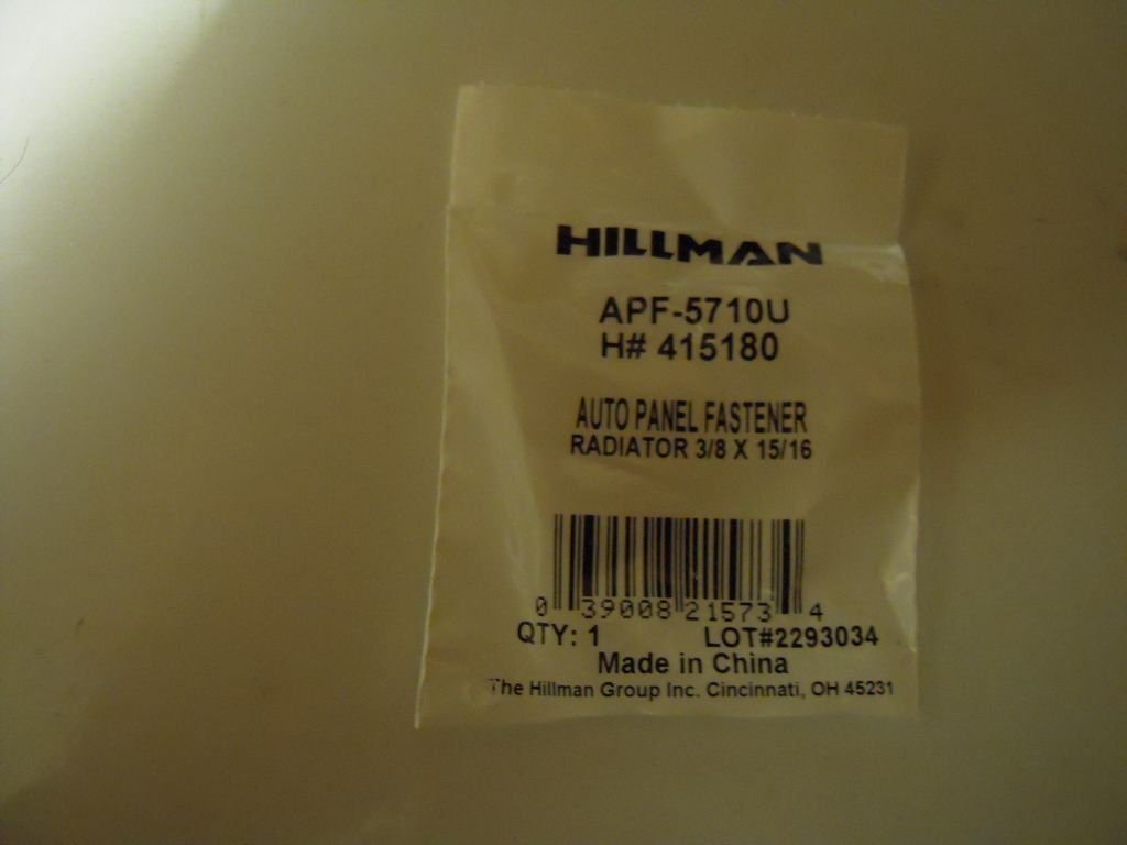

Main product photoThis will solve the issue,
but if wiggle/tap doesn't work with low fuel indication, i guess you wait for the tow truck or leave the vehicle??
why i tried to gas up at 1/2 tank before i did the scrivet!!

When my 2017 was new I had that happen at the gas station. I had no idea why it was not opening. Fortunately after cyling the keyfob lock and unlock a few times it opened. After that for a couple of years I had no issues. Then reading on the forum that the issue was somewhat common. I placed a scrivet in the hole and don't worry. I can hear the acuator working and it sounds just like before I put the Scrivet in. No difference other than the door always will open. Peace of mind.

What size scrivet do I need to get?
Is it 3/8" ?
From Ace Hardware?

GOLD72's Avatar
GOLD72
Joined: Sep 2000
Posts: 11,142
Likes: 1,913
From: Missouri City, TX
Is it 3/8" ?
From Ace Hardware?
I remember 3/8” is the size.

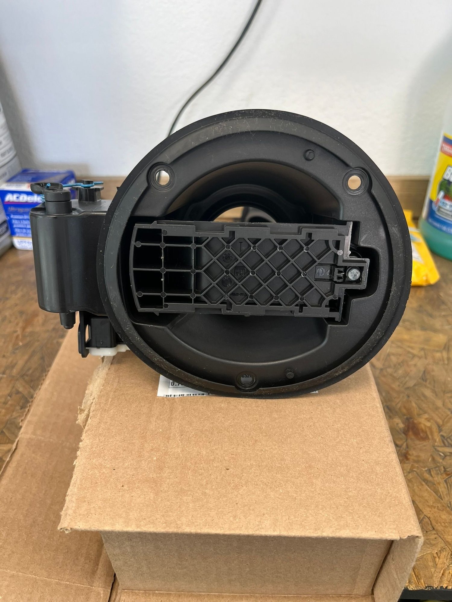

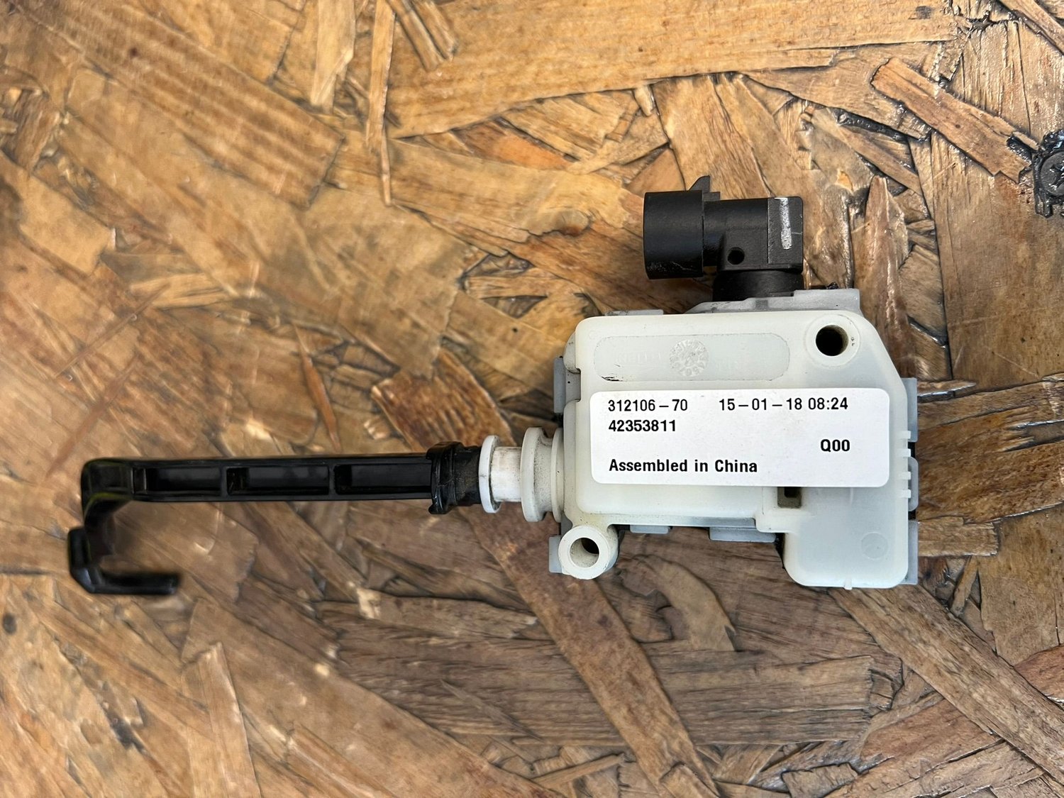

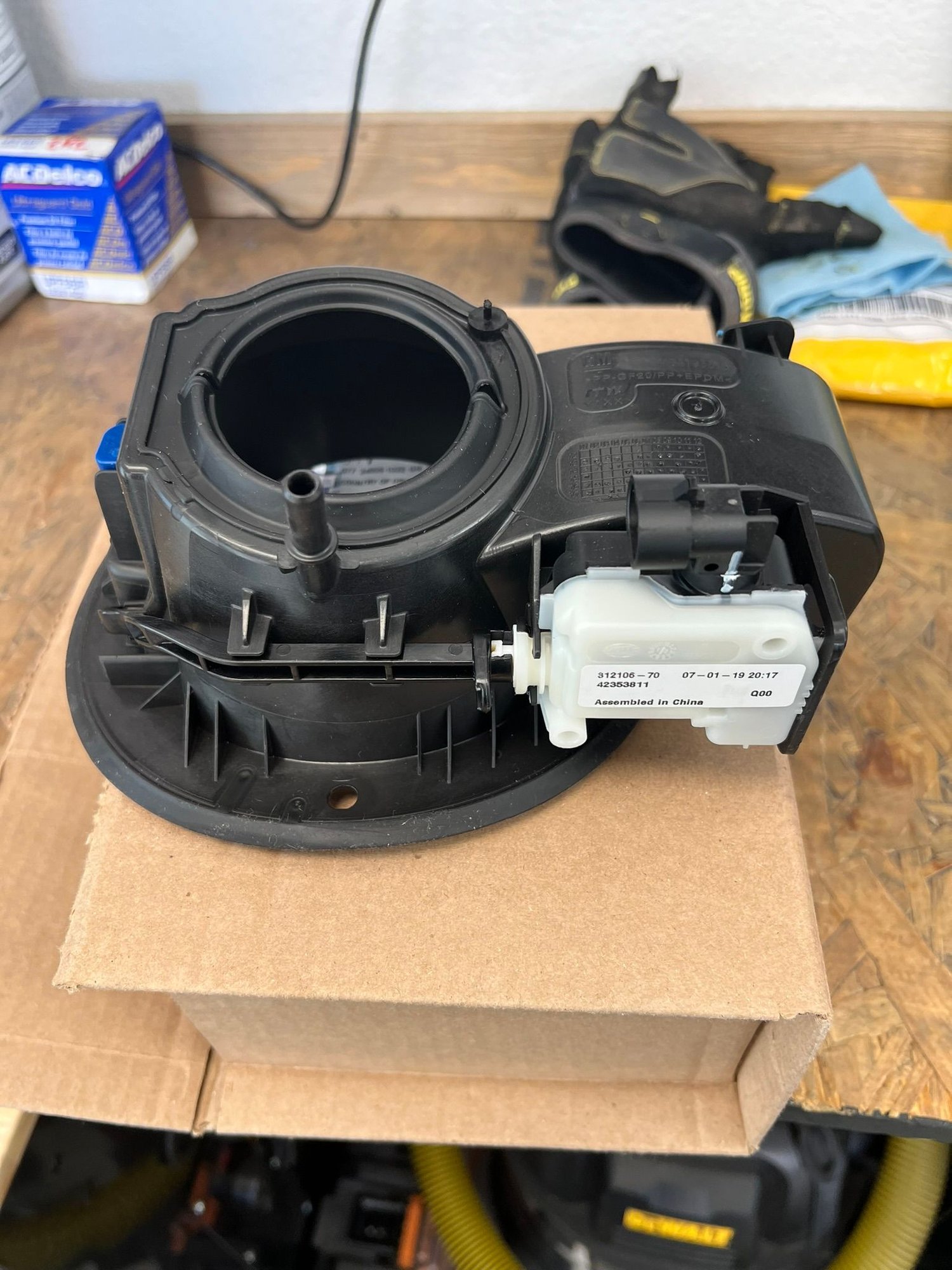

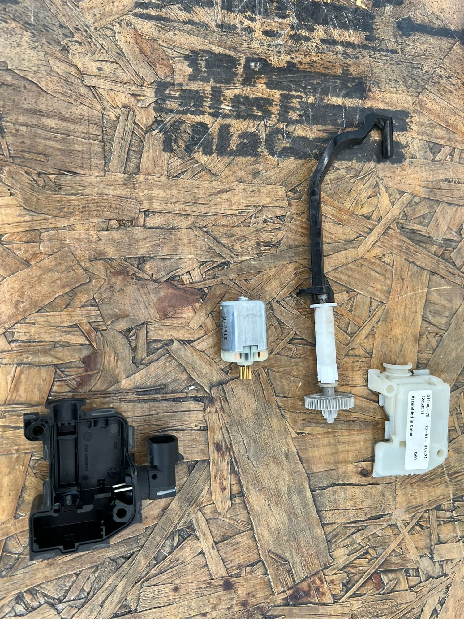

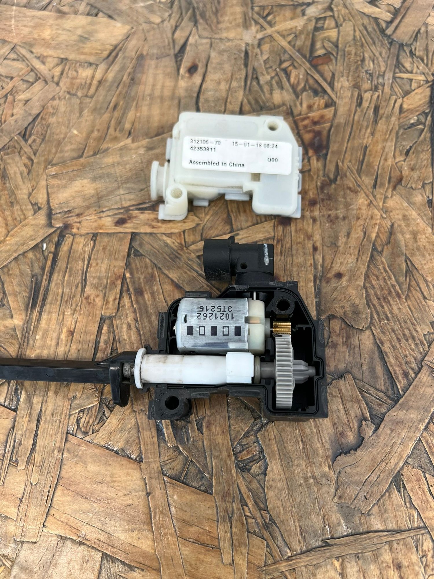

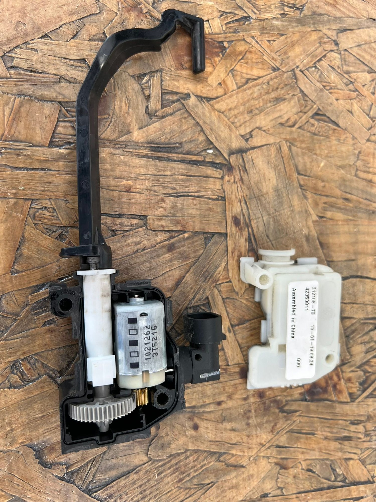

Or just remove the actuator and rod at home. It's a 15 minute job....13 minutes longer than the scrivet . If you're a track guy, yank it out when you swap tires or brakes. If you're a lawn-chair/car show type, do it when you're cleaning the fender liners.
You can see the old actuator from mine in the pics below. I also bought the new assembly (which is the only way GM sells it) for something like $50 as well. If I ever put the car back to stock and sell it, everything will work as intended since people get worked up over even minor stuff that doesn't do what it's supposed to do.
