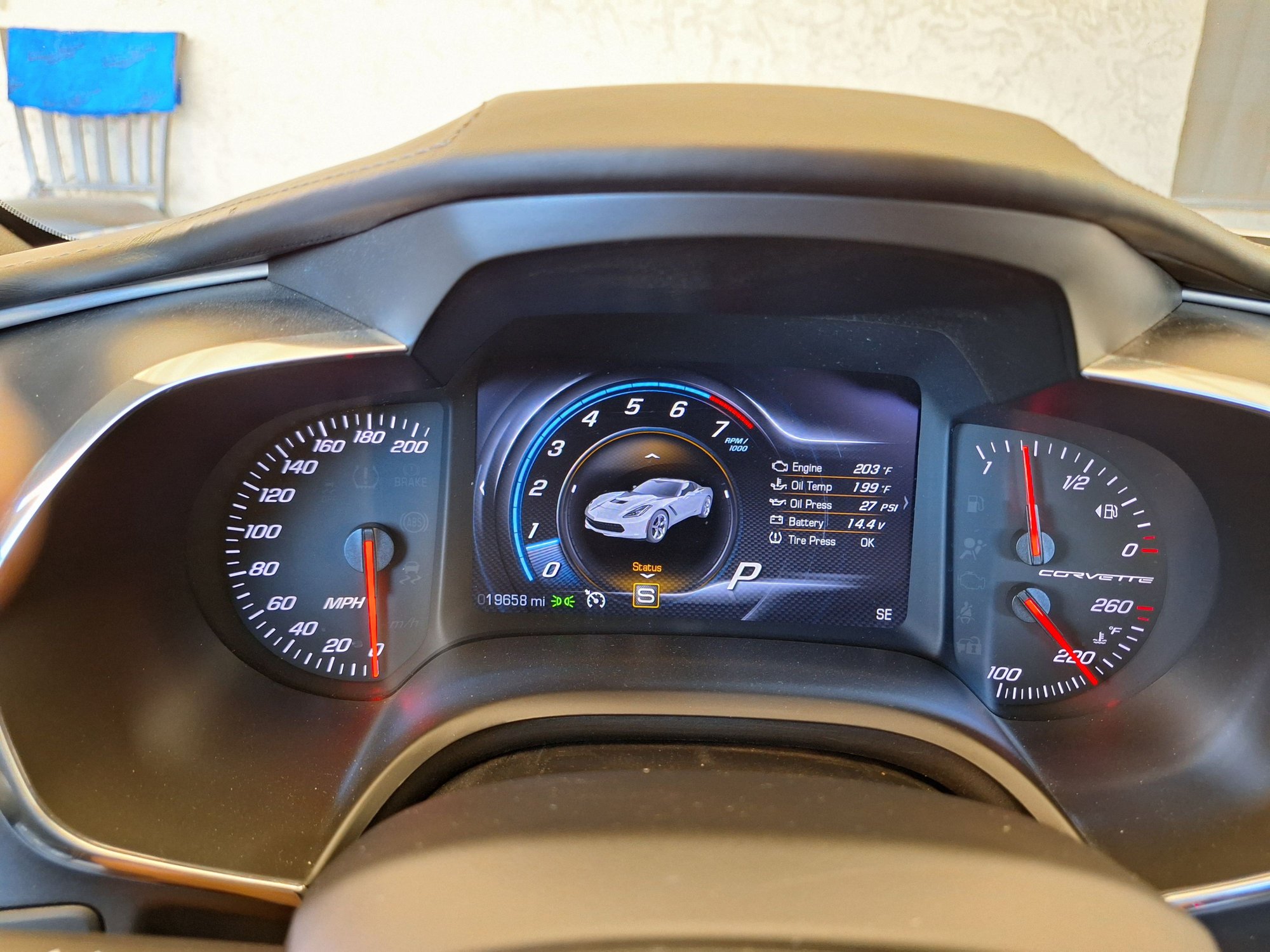

Originally Posted by kodpkd
Did you get the correct OEM thermostat for your car? You said, you, like 190* to 200*. The GM engineers like about 220*. Is there any chance the coolant was just low? If the sensor wasn't covered up with coolant, that can cause a low temp reading.
my usual temps after surface/highway-75 driving most days!!
220* coolant gauge is what I get.
the difference between the analog/digital presentation!!
