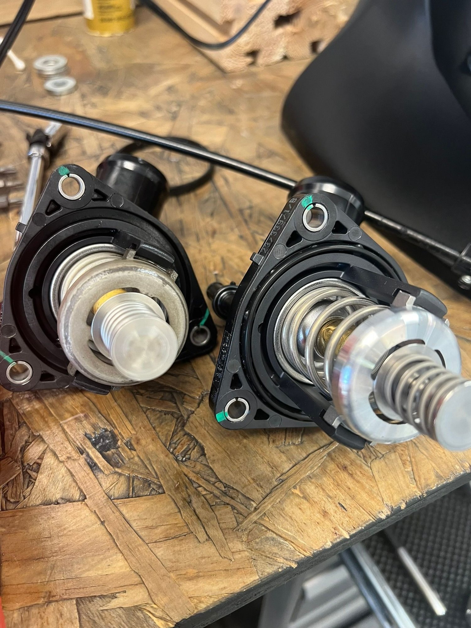

Whatever you do make sure you are using an OEM thermostat if you are staying with the same temp, if you are dropping down in temp only use the Katech 174 thermostat, they use an OEM thermostat body and a lower temp " bulb" and are hand assembled , thats why they are a bit expensive the other junk like Mishimoto will fail ... and the aftermarket crap will fail open . Also, the Katech will NOT require ECM reprograming like a 160 will ...........

But there is a case for the when you use the Katech 174-degree thermostat ..... Most of us that have a blower on their car chose to use a lower temp thermostat and different fans settings especially if you have a Roots type blower that is on a ZO6 which when stock will overheat and go into low power mode if you are beating it hard!
Even in the wintertime my car will warm up fast enough to turn off the YELLOW cold indicator, but the real benefit is in the heat of the summer as it hardly ever exceeds 190 in normal driving and even after I beat down on it, I only see maybe 217, and then it cools down instantly after I stop beating on it
