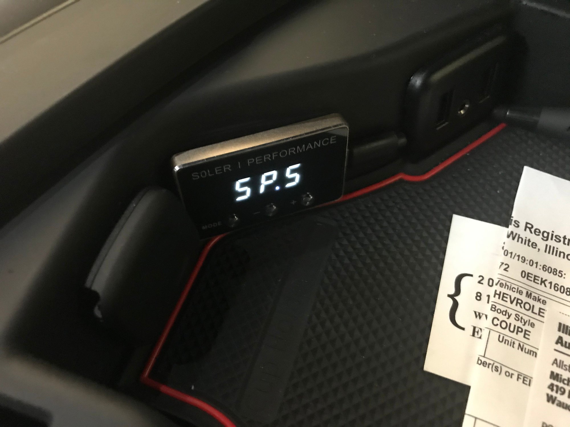

Here’s where I put mine. It’s not the Bluetooth one though it’s
in the center console

Thanks to all replies...great forum. mdolandese, how did you get access into the console ...drill a hole?? Also did you have to remove any molding to route the cable....if so, how did you do it. thanks sojo
Yes I had to take the top part off where the shifter is. Then I ran the wire from the pedal up under the carpet through where the shifter is to the console. I notched the bottom out inside the console instead of drilling a hole just so I could run the wire underneath without it being pinched. Was easier than drilling a hole then plugged it in. If I remember correctly I had to pop out the usb also to free it up. There’s plenty of videos on how to take the console apart regarding changing your shifter to the MGW. Only the top piece had to come apart. Once I figured out the sweet spot for me is SP7 I never changed it once in a few years
